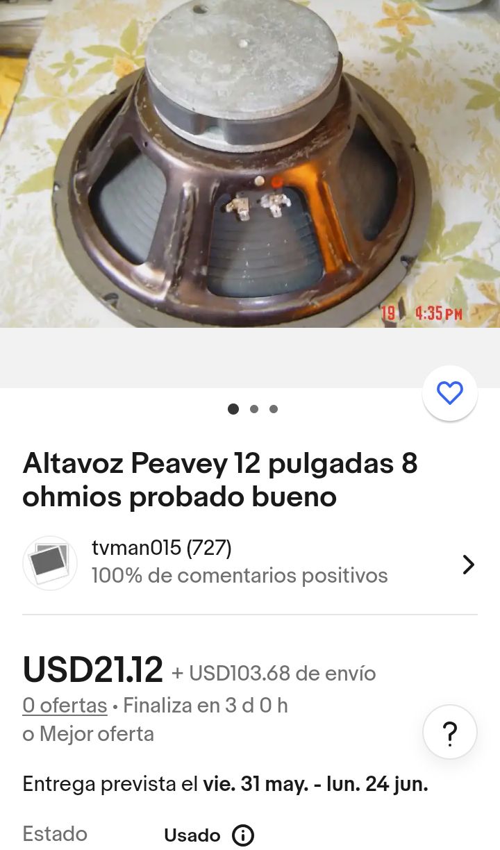

Here is one: Peavey Blue Marvel (Peavey house brand): an excellent Eminence made speaker, one of the Legend series, for all of 21 bucks.
Disregard the outrageous >100$ shipping and 1-2 MONTHS delay, EBAY detected I am in Argentina, 10000km away.

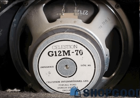

Laney may bring a British made HH speaker, equivalent in everything to a Celestion except on label.

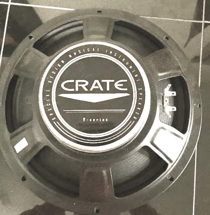

This particular Crate speaker seems to have a small-ish magnet, although picture is dark and at an awkward angle, I'd keep searching, including other brands such as Peavey.
Bandits always sported a "good" speaker, specially because it has to stand an overdriven 80W RMS amp, so they can't fit a weakling there.

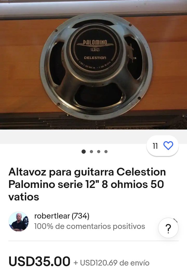

Look what the cat brought:
Celestion "Crate Palomino" u$35

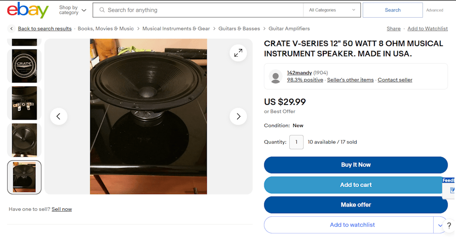

That listing shows here in the US - $45 they want for shipping :'( compared to $100 for Argentina :'(Look what the cat brought:
Anyway, I pulled the trigger with a $26 offer on the Crate, was accepted and I paid for it automatically, apparently. Next thing I knew was a message asking if I wanted to pick up, which I politely declined.
Anyway here's an enhanced photo; I assume the magnet is a bit bigger than the sticker! We'll see in several days I assume.

Oh, it looks fine.That listing shows here in the US - $45 they want for shipping :'( compared to $100 for Argentina :'(
After I get my amp's functionality as I'm hoping to do with this, well, it's a long summer and who knows what I may find, a bit better. Thanks! I'll keep looking, knowing there's gems to be found.
Same magnet size as many OEM Eminence magnet speakers.
Picked from above and at an angle it looked smaller, buy hey , pictures can be deceiving.

I quite trust the one you bought because he already sold 18 and has 9 more.
WHO has 27 identical "pulls"?
So I guess he bought a factory surplus lot, probably at auction, and all are still new in box.
