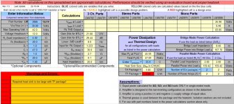

Why would you want to drop the voltage any farther than this? The gainclone amps using the LM3866/4780 chips will easily take this voltage, and you'll have more headroom.

3886's exceed thermal capacity of the chip with more than 28v into 4 ohms, or 30v into 8 ohms. I want something to last, so I'd rather run them slightly cooler.
I do not see that on the datasheet---it lists the chip power dissipation as 125W MAX, and the power dissipation at +/-35v, 60 watts to be about 65 watts. I still think an adequate heatsink is necessary to be safe.3886's exceed thermal capacity of the chip with more than 28v into 4 ohms, or 30v into 8 ohms. I want something to last, so I'd rather run them slightly cooler.

So use the TA package with Thermalloy paste and a mica or Kapton washer. It'll be better all around anyway!
