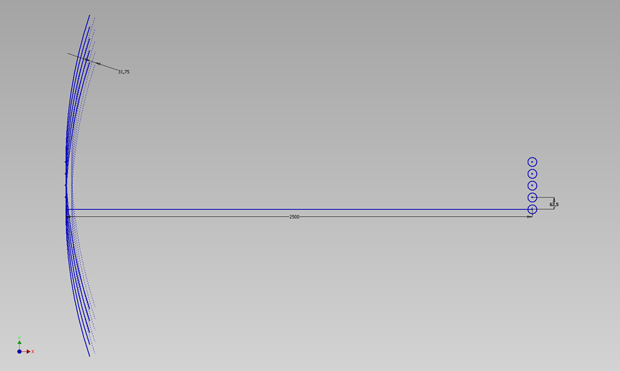

Actually, at 5400 Hz, one wavelength would be 2.5". I did not check that before, you simply took one wavelength as the cause of combing. So ear against the array would have all drivers sum in this case 🙂.
Still, my argument holds up. You can't name a frequency and state it will start combing at that frequency based on center to center driver distance. As we'd need to know the distance from the array as well as it's length.
Lets put it into a graph:
attachment.php
Here I've drawn waves at a listening distance of 2.5 m, each driver gets a wave and the dotted lines behind the "blue wave" are 1.25" behind, meaning out of phase at 5400 Hz.
Where the continuous blue line touches the dotted line behind it is were a driver is out of phase with another driver. On our design axis, in line with the bottom diver, we see that none of the other drivers is completely out of phase with another driver. This is the worst case scenario with this array at 5400 Hz, be it, at a distance of 2.5 meter.
(they are actually within a quarter wave distance, and still summing positively, directly in line with the bottom driver)

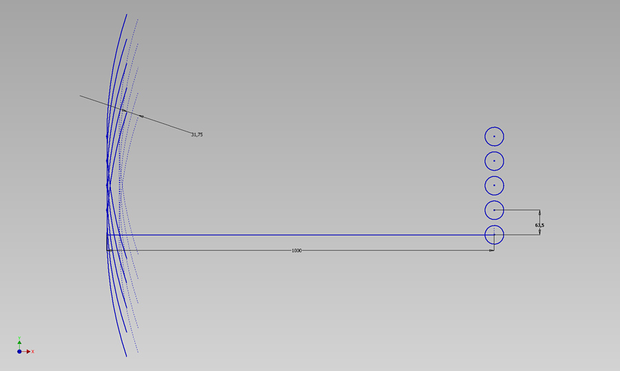

Let's examine closer to the array:
attachment.php
See how at 1 meter distance the situation has changed? The upper most driver's wave front is out of phase with the bottom driver (check it's dotted line) at our design axis.
The rest of them still sum.
This shows that driver spacing does have an influence on the resulting combing. But not like you claimed it would. If I had more drivers in between the top and bottom one, thus spaced closer together, the top driver would still be out of phase with the bottom one at 1M distance. However the transition would be more smoothed out due to having multiple drivers sum and subtract. Getting closer in behaviour to a continuous array.
But not in any way like you said it would, concluded from that center to center spacing.
At 2.5 meter none of the drivers would be out of phase with another on our design axis at 5400 Hz. This does not depend on the number of drivers in our short array here. It is determined by the distance from the array and the length of the array. More drivers packed closer together would fill in the spots in between, kind of like anti-aliasing. Getting you closer to a seamless array. Now make it floor to ceiling and assume the floor and ceiling are reflective.

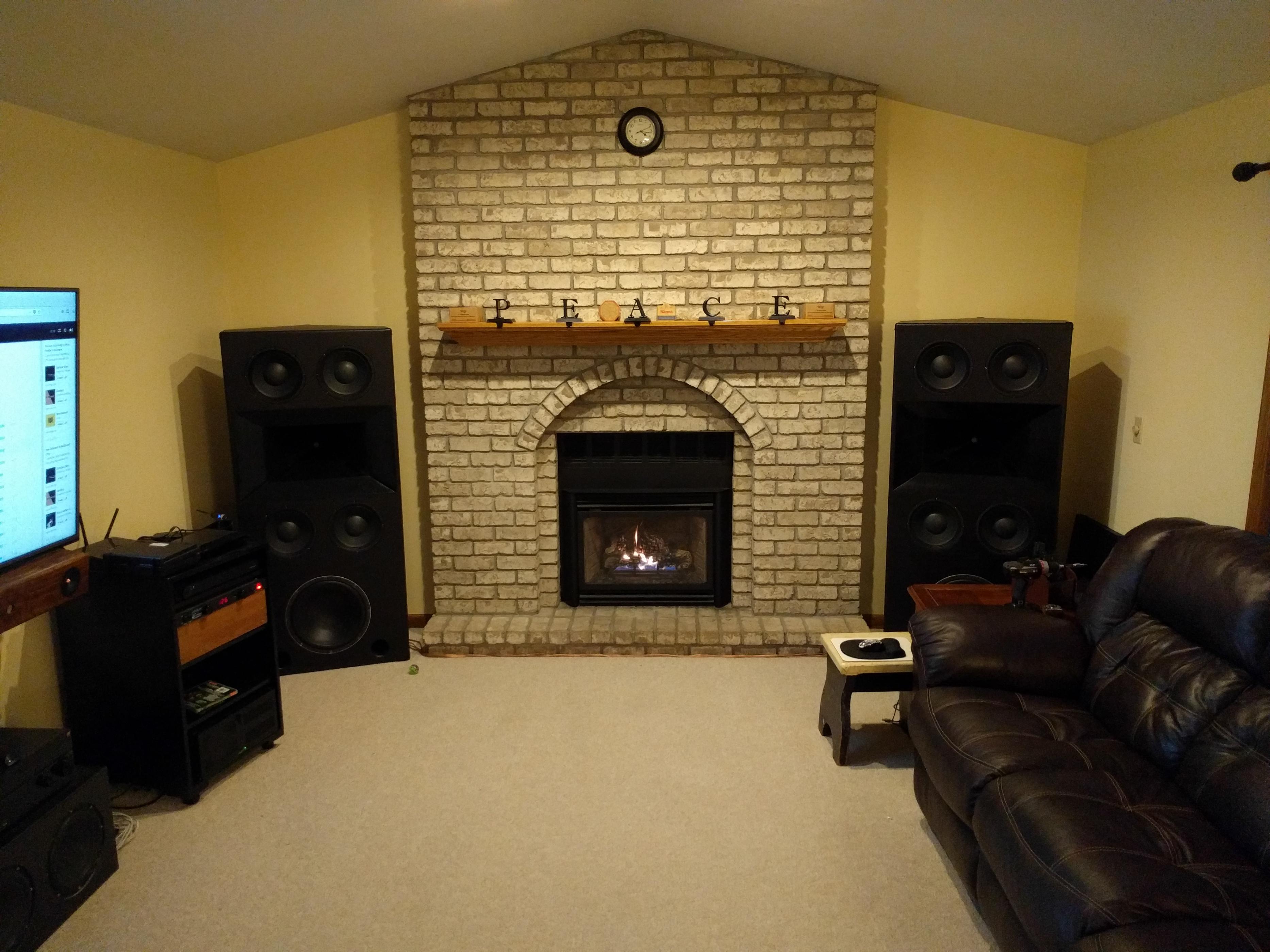

I have always wanted to build a line array and am intrigued. From what I understand a relatively flat power response and clean impulse response is what we are looking for in a great speaker system, and that is mostly why I have been experimenting with Unity and Synergy horns, besides they are just "cool".
I'm trying to ask "what do they sound like?" but knowing that I might be getting a subjective answer.
The last speakers I built have a "giant" sound that envelopes the listener from having pairs of woofers above and below the synergy horns and I am imagining that a floor to ceiling line array or CBT would have a similar quality?
Another advantage of the (multi) single driver line array seems to be no crossover near mid range frequencies, as a result a relatively linear phase, and would that not improve the power response through the mid region?
The other reason I am interested is line arrays would be ideal in my current listening room and would have a smaller footprint than these.
