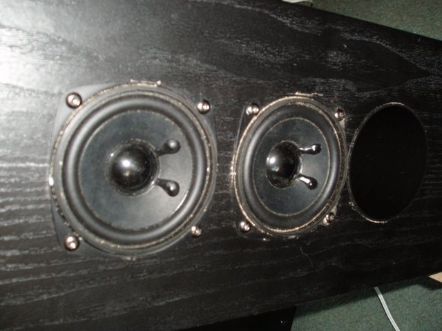

Anyway, onto the project.
Seems appropriate that I start woth driver choice, so I will.
The FR driver is a Visaton FRS8 - these are (in terms of price to performance), fantastic speakers, which sacrifice (seemingly) sensitivity for a smooth run from 120Hz upwards (small, sealed box), with the only dip between 15kHz and 20kHz. With these speakers, cymbals sound metallic, you can hear the sound of fingers picking at guitar strings, and stereo imaging is the best I've heard (I haven't heard Mega Systems, but I've heard good ones), however, the only thing that lets these speakers down is the bass. Now, trying to integrate them with my subwoofer wasn't particularly easy when I attempted, so I looked at other ways of making bass. The idea of a FR driver with some kind of bass unit has always appealed to me, as the XO point is away from the sensitive area (3kHz), so you get the advantage of a FR driver, but with the bass of a larger, 3-way system, which brings us neatly onto the woofer.
I wanted something small (less than 8"), and cheap, but still went pretty low. After looking at various 6"+ Visaton woofers, I arrived at the W130S 8ohm, which models pretty well in a 17L box, tuned to 46Hz, and costs less than £10 each. Many of us know that cheap bass/mids often fall over on midrange if they model well (the manufacturer has to cut corners somewhere, right?), but the beauty of this design is that you can use even cheap aly drivers and avoid the ringing that is often associated with metal cones. So, bought two to make a test, make sure the go as low as winISD says, etc, and, lo and behold, they really go that low (f3 of 42Hz, f10 around 33Hz).
After discussing with Dave, it was decided that having two woofers push push, one on either side of the cabinet would be a good thing, as it would stop the whole speaker vibrating (a major thing for me, as I'm 15, so parents to please...), so, the (nearly) final design is as follows: 2x FRS8 and 2x W130S per cabinet, using a 20:1 MTL for the FR drivers, as the impedance spike at resonance is just one octave down on the XO point, and a 35.4L box (extensively braced) for the woofers.
Made one test box (just one woofer), and, after messing with phase issues etc, got a really nice sound out of it - better than expected. So, I need to make the other test box, then persuade Dad that they sound better than the Missions he lets me borrow (the old 760is), so he'll go and buy the other two.
The final cost for this design is less than £150, so it's ideal for people who are new to this, and those who want to try a new kind of speaker, without spending a fortune.
Thanks for reading, pics attached - please note - this is a test box, made of an old 3-way speaker. The cut outs are very rough, so no nasty comments on workmanship, please

Excellent... when you build the real boxes make sure you champher the back of the FR8 cutout,

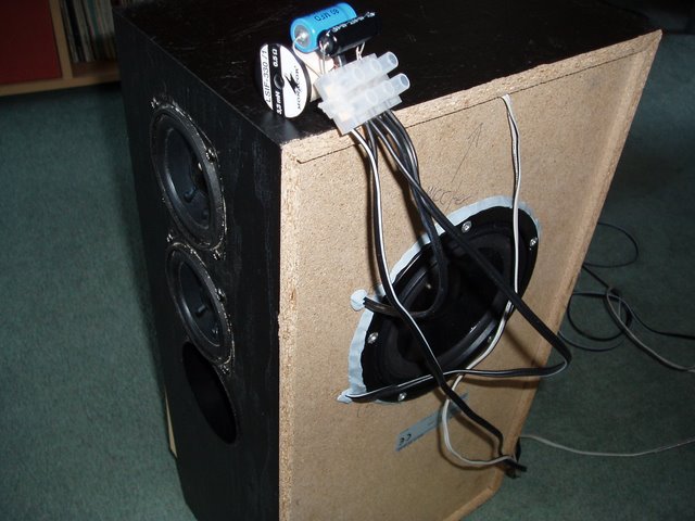

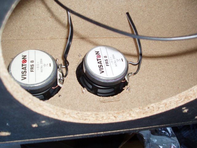

Last night (after posting the above), I made the other test box aswell, set them up with a half-decent 50W amp, plugged into a CD player.
For the driver size, the amount of bass and volume is surprising, but I suspect there's a reason...
Most bass drums are recorded around the 40hz region, and that's where the port is tuned. I can go to 200W around port tuning and the driver is still withing Xmax, but I suspect I'd hit thermal ratings first.
Anyway, listening to those speakers, the whole concept of a low crossover and a woofer to back up a FR driver does make sense. For those who want to try it, I'd suggest you go for it - it is hugely rewarding.

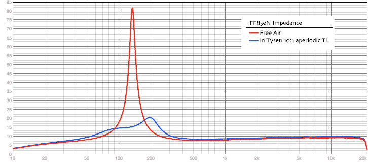

My question is this - will the 30 ohm speak at 150Hz affect the crossover a huge amount? I could make an MTL, but if the effect of it will be minimal, I could keep a small, sealed box instead. From what I can see on winISD, the impedance peak makes the roll-off steeper lower than the peak. This wouldn't be a particularly bad thing, as far as I can see.

Yes, the impedance peak will affect the XO. As can be seen from the impedance plot of FF85 in free air vrs the "aperiodic" midrange TL loading in Tysen, the box has a dramatic effect on impedance (note that no optimization has been done on the line since we went active)

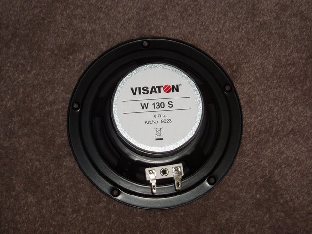

Done some more modelling for you.
Basically, you W130S uses a box around 1/4 the size of the W170S, and the difference is around half an octave. I believe multiplying the box size by 4 to get that bit lower isn't a good, idea, but I am limited on space. You get more SPL from two of the W130s, in a box still half the size (and more power handling).
