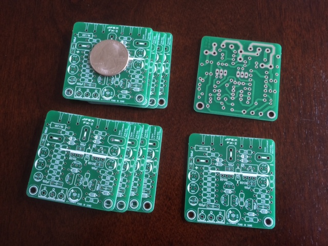

I just built the Apex FX8 amp - it is very small (50mmx50mm board) for a fully discrete thru hole component 100w class AB amp. I am still waiting for the MOSFET output stages to arrive so the ones shown are mockups to get the scale of the device.

I ordered the boards from a Gerber file from thread. Custom PCBs are $10 for 10 if 5cm X 5cm or smaller.
These boards are extremely high quality - like commercial production boards. I used Seeed studio.

I would be interested to compare that board to a well done TPA board. I have a feeling most of the difference in sound is down to quality components, and a board layout someone actually put thought into. The Chinese TPA boards have neither of those things generally.

You got that right. All components bought in bulk from Aliexpress. The output lateral mosfets are the most expensive parts at $5/pair the PCB is $1. The rest of the parts are no name Chinese caps, and 1% resistors, no name signal transistors, VAS transistors, diodes, terminal blocks, etc. maybe $2. So total cost is about $8. Of course I have enough parts to make 10 amps except for the MOSFETs. Other cost is a heatsink and dual rail 35v power supply. Once you get into class A or class AB amps the power supply is something you have and can use between amps for testing. In reality a dedicated toroidal transformer 300VA dual rail 35v power supply will set you back about $70. I have found that cheap $4 CPU heatsink with fan can remove all the heat you want rather than massive aluminum finned heatsink.
