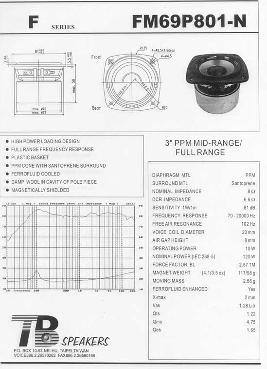

I was looking to build some cheap surround speakers, and have been looking at some designs using the tang band TB W3871S but i am not sure yet and don't want to spend $20 cdn for 10 drivers if they are not that great. Another driver i found is in the attached picture, These are almost 2/3s cheaper than the w3871s and i think they would be better because of they have a larger frequency response, but i really don't know. I really don't know that much about driver specs but i am learning, Electronics is really not my specialty. BTW they surrounds would be used along with a tempest sonosub if that helps at all.
If anyone could point me in the right direction as to which driver to go for it would appreciate it. I want to keep these really cheap but also good quality. I don't think either could be worse than what i use now for surrounds.

Use the 871S hands down.
The others i have measured them and the 871S is a no brainer.
FS is higher but a smoother sound.
SPL is higher on the 871S 87DB to 81 DB on the clearance drivers.
There is a few clearance if they are left http://www.nuera-acoustic.ca/img/datascans/fa69p805-w.jpg
These are sleepers.
The others you were looking at were designed from TB to use in a large array.
Yes 50 per side in clubs over seas.
I have seen the plastic cabinets and they were slick.
They stack one on top or side by side with a plastic dowel.
And the 81 db is a low spot in them for single driver use.
The other is the 319S1, not the high end extention as the 871S.
Use them and you will be very happy.

And there is nothing that comes close to the 871S for the size, cost and out put.
DO NOT LET THE FACT THAT IT IS ONLY 3" FOOL YOU.
