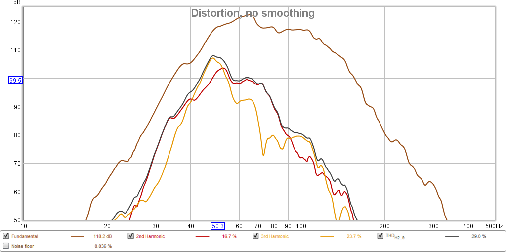

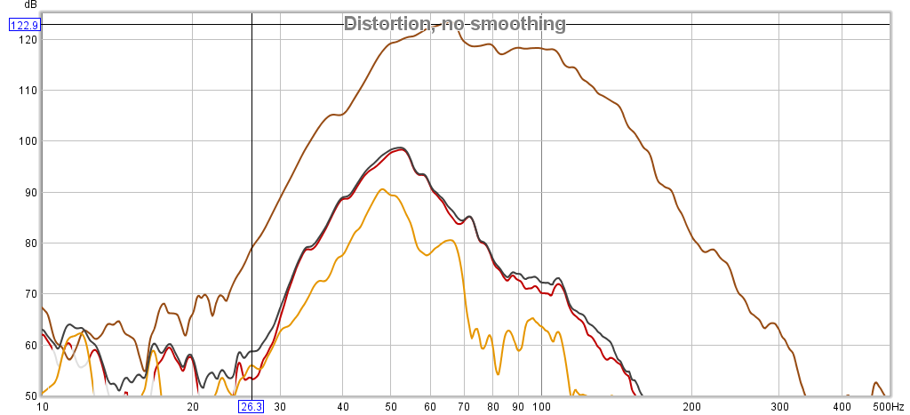

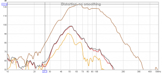

Well, i managed to get my hands on one of the KSubs, and perform a few measurements. I'm not really impressed, and I'm wondering if something's wrong with the sub. At 108dB output, measured about 6 inches from its "vents", distortion is already at 10% in the passband, and there's lots of 3rd order HD too, not something I'd expect from a 12x2 4th order BP system. The built-in amp was nowhere near to clipping at that output level.
QSC calls it a bandpass sub, but the vent seems a bit too large for the front of the enclosure to act as a proper bandpass filter, so I suspect that the rapid rolloff about 100 Hz is more electrical than acoustical in nature, and it would explain the higher 3rd order HD than I expected.
Maybe one or both of the drivers is shot? I'm tempted to pull the amp out of the enclosure tomorrow and do a DATS run against each driver to see it turns up anything.

If I'm reading your chart correctly, it seems to be about what I'd expect from the KSub at one meter half space outdoors at or near full output, though you don't specify anything about test conditions for the chart. The spec rating of "130dB peak" certainly would not happen near either end of it's rated -6dB down points of 48-134 Hz, and would have to be a very short peak ;^)
The chart shows the distortion down around -22 dB from 120dB at 50Hz, about 7.94%. The distortion response at 100 Hz is more than 40 dB down, <1%.
That does not seem to correspond with your statement "At 108dB output, measured about 6 inches from its "vents", distortion is already at 10% in the passband", perhaps at 6" there was enough vent velocity to clip the test mic?

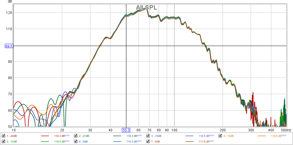

Hmm, the graph is a bit misleading, perhaps I should have included the legend. I'd run a linearity test on the KSub, which involved basically measuring its output at different input levels and offsetting the measured data to compensate (e.g. at -24dB, I'd offset the measurement by 24dB in REW, at -21dB I'd add 21dB, etc.). This way makes it very easy to see any changes in linearity in REW, as these changes can both be seen in the graph and read of the legend. When I switched to distortion measurements, I didn't remove the offset.
The actual measured distortion at the level that produced the 122dB peak was just below 30%, and no the mic wasn't clipping. And this was with the Deep Mode option off. When switched on, the distortion got considerably worse.
In comparison, under more difficult measuring conditions my POC6 hit 9.6% in its passband, and that was primarily 2nd order HD (3rd order HD as just 2.8% at that point). The POC3.1 (basically POC3 loaded with the Eminence Kappalite 12" driver) measured even better. OTOH, the KSub's THD sloped down quite a bit from the peak at 50 Hz, possibly due to the its bandpass design. Unfortunately REW does not allow direct comparison of THD measurements.
This KSub is a well-used one, and the high distortion might just be a side-effect of the abuse that it's seen over its lifetime. I didn't have enough time with it do a direct comparison between it and the DIY subs I had on hand.

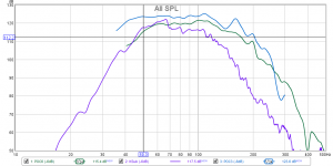

The last chart shows a comparison between the three subs. The SPL levels are not directly comparable, as they were taken under different conditions, and the KSub is active while the two POCs are passive. There was also a 200 Hz LP filter on the output of the POC subs. But from the graph, it looks like POC6 gets almost as low as the KSub, and POC3.1 gets quite a bit lower.
