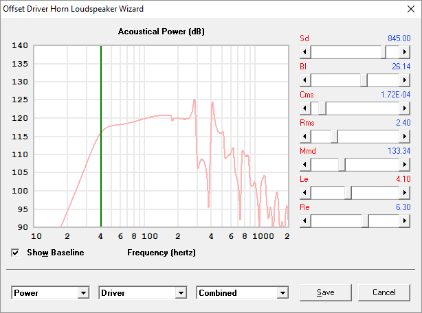

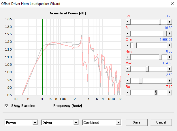

That second response for the 380 looks more like what I would expect from a accordion surround woofer vs the rubber surround. Thanks for that.

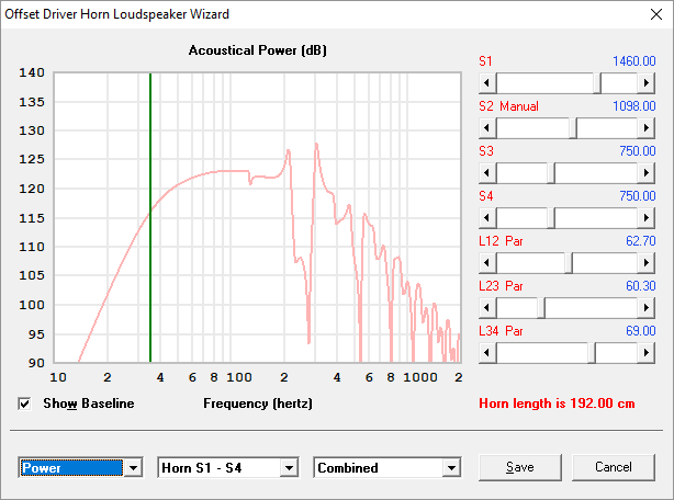

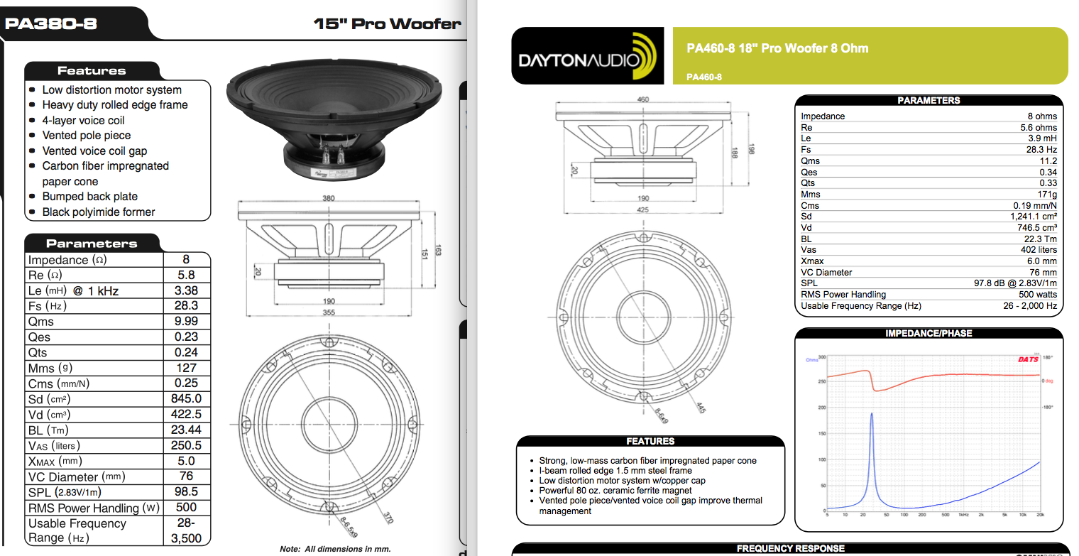

The response curve is primarily dictated here by the strong motor and the highish Le. Measured Le for the PA310 was a bit lower than published though, and I'm hoping for the same with the PA380.

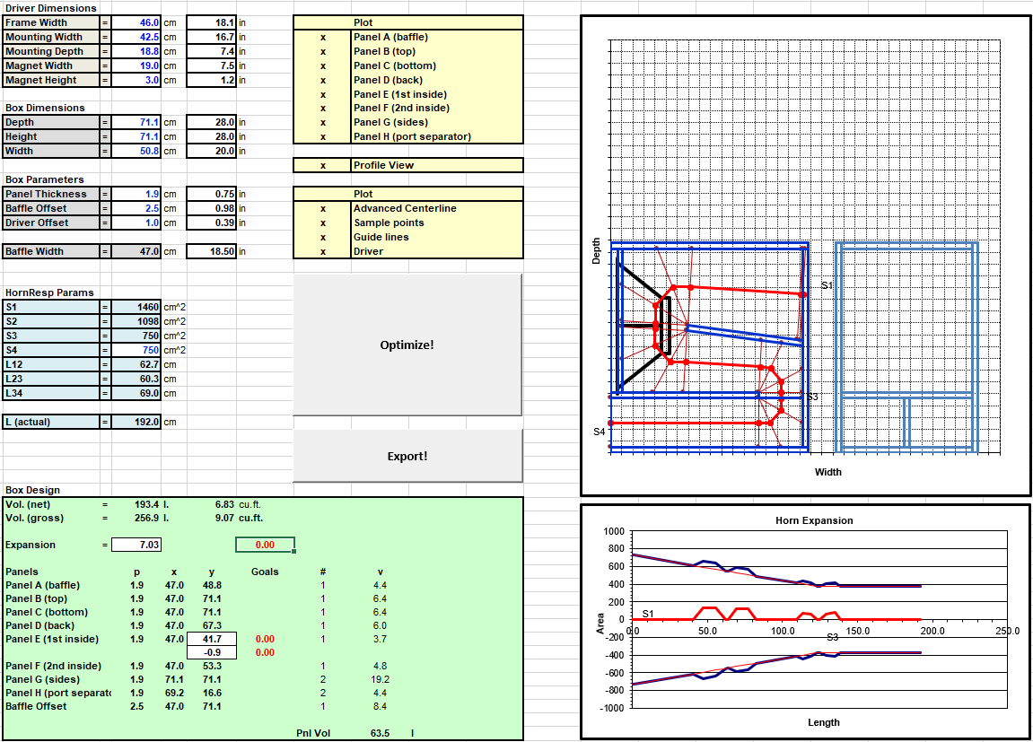

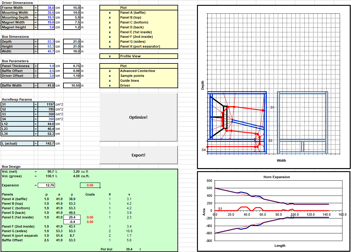

If I get time I'll try starting with your cab and maybe increasing size a tad to move the bump lower.
I've attached a copy of the workbook I used to make the sim. It might make it a bit easier to come up with a different alignment.
