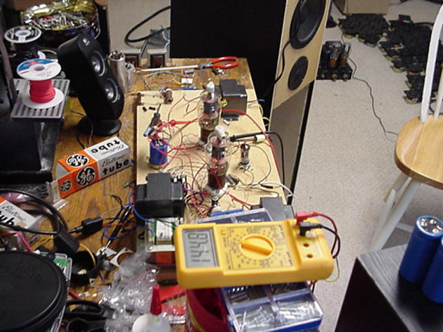

I put these into the amp and proceeded to turn up the juice. If you look carefully in the attached picture you can see the voltmeter on the power supply ix maxed at 400 volts. The digital meter on the right shows 110 mA. This is 44 watts per tube. There is an even glow on the plates, and the tube is stable with no hint of runaway. It ran at this current for an hour with no problems. I turned it down to 80mA and there is no glow. I am sure that I could blow up this tube if I really tried, but they are really tough.
I have been listening to these for 3 days and find them to be the best overall compromise. In triode they are almost as good as the EL-34's and in UL they are close to the 6550's.
Overall the Edcors have surprised me with their sound and price. I am working on a new amp design using these transformers. The idea is to make a low cost SE amplifier that sounds almost as good as a TubelabSE.

As for "stress testing", the most that I have fed any of these transformers was a 6LW6 triode strapped at 110 mA and 400 volts. I was using the 8 ohm tap with a 4 ohm load to present a 1.5 K load to the tube. Under these conditions I was getting 15 watts at .8% distortion. This combination had the best bass and transients of any thing I tested at the time. I was drive limited so there was some power left behind. I will try this again when I have more time. ( this was mentioned in the 6AV5GA thread)
I briefly tried 6HV5's in the same amp and could not get them to work right. I only have two of these, so I did not spend much time. My amp can not do positive grid voltage without modification, and my B+ was limited to 400 volts, so I could not get much current.
