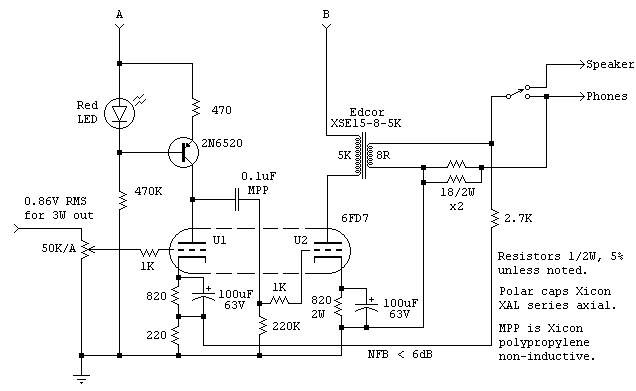

I scrapped the 6EW7 as too insensitive and went back to 6FD7 (they sub for each other, but the 6FD7 U1 has higher gain)
PS circuit for it and writeup.

found this link ?, but 2 watt only
http://www.audiohobbyist.com/images/6ew7/6EW7sch.JPG

OK, despite the football game on TV, I got the transformers tested. I have lots of data, too much to post here, so it will be posted on my web site in a few days. The short story follows:
I took my TubelabSE, which is currently running Shuguang 300B's through custom 5K ohm Electra-Print transformers, and measured the vital statistics. I used this amp because it works very well and has excellent 5K transformers. The other transformers were connected into the amp and compared to the Electra-Prints. This amp is running a small power transformer so that 45's, 2A3's and 300B's can be used. The B+ voltage is about 300 to 310 volts with 300B's, depending on the bias current. This (and the 5K load) limits the power to 5 or 6 watts.
Three different low cost transformers were tested. Both electrical and listening tests were performed. The bias was adjusted to the point where the third harmonic was minimized. This was 50 mA on the Electra-Print transformers. The 3 other transformers were tested at the minimum 3H point, and at 50 mA.

Edcor XSE=15-8-5K
These are a new player in low cost transformers. Best sound is achieved at 80mA. This transformer makes about 2.5 watts more power than the Electra-Print. Specs at 1 watt: frequency response is8.3Hz to 45.9KHz with 50mA, and 16.6Hz to 45.6KHz with 80 mA. Distortion is .75% with 80mA (mostly 2nd harmonic). Distortion is 2.6% at 7.2 watts.
Low frequency effects at 5 watts: Visible saturation can be seen on the scope for any frequency below 74 Hz at 50 mA, 61Hz at 80mA. No clipping was observed at any frequency below130Hz with 80mA, and none was noted at 50 mA.
Low frequency distortion tests at 1 watt: 100Hz lowest distortion was 1.41% with 57 Ma. At 36 HZ .61% occurs with 44mA

The Edcor unit showed some anomalies in testing:
I adjusted the amps bias current for lowest distortion at several different frequencies. The Edcor transformer wanted less and less current as the frequency was decreased. This effect was not near as severe with the Hammond transformer. Both Edcor transformers exhibited this effect.
The Edcor transformer produced considerably more power than any of the other transformers tested. I got 7.5 watts at the onset of clipping with the Edcor, 6.1 watts with the Hammond, 6.0 watts with the Electra-Print, and 5.2 watts with the Triode unit. This indicates that it is a really efficient transformer, or that it is a lower impedance than 5K ohms (more likely). I will test this in the next few days.
Despite the low frequency anomalies I liked the bass better with the Edcor transformer. I believe that the Edcor unit sounded better, but there was a 1/2 hour setup time in between tests that makes it hard to tell. In fact the Edcor and the Hammond sounded very similar. Both sounded far superior th the Triode unit which was never meant to be used for HiFi. Neither sounded as good as the Electra-Print which costs (and weighs) 5 times as much although the differences were subtle.
All listening tests were done at 70mA of bias current (the Triode unit was tested at 50mA), which was the most that I wanted to run for a continuous (2 hours) test, since I was pulling 180mA (2 X 70 + 40) from a 120mA power transformer. I did not notice any saturation type distortion when listening to a bass guitar solo at full volume. The clipping that occasionally occurred did not sound very obvious (observed on scope).
The Edcor transformer has a UL tap which opens up some more possibilities for designing a low cost amp. I guess I will have to re-visit the 6AV5 torture testing, and maybe try out some of the other popular pentode tubes.
This transformer may respond well to cathode feedback. The Hammond 125CSE sounds remarkably better with the secondary wired in series with the output tubes cathode. I can't do this with the existing TubalabSE board, so I didn't try it yet.
I would consider this a great transformer for under $20. This one has convinced me to try some of their other transformers. It would be cool if they made a 200 watt SE transformer.
