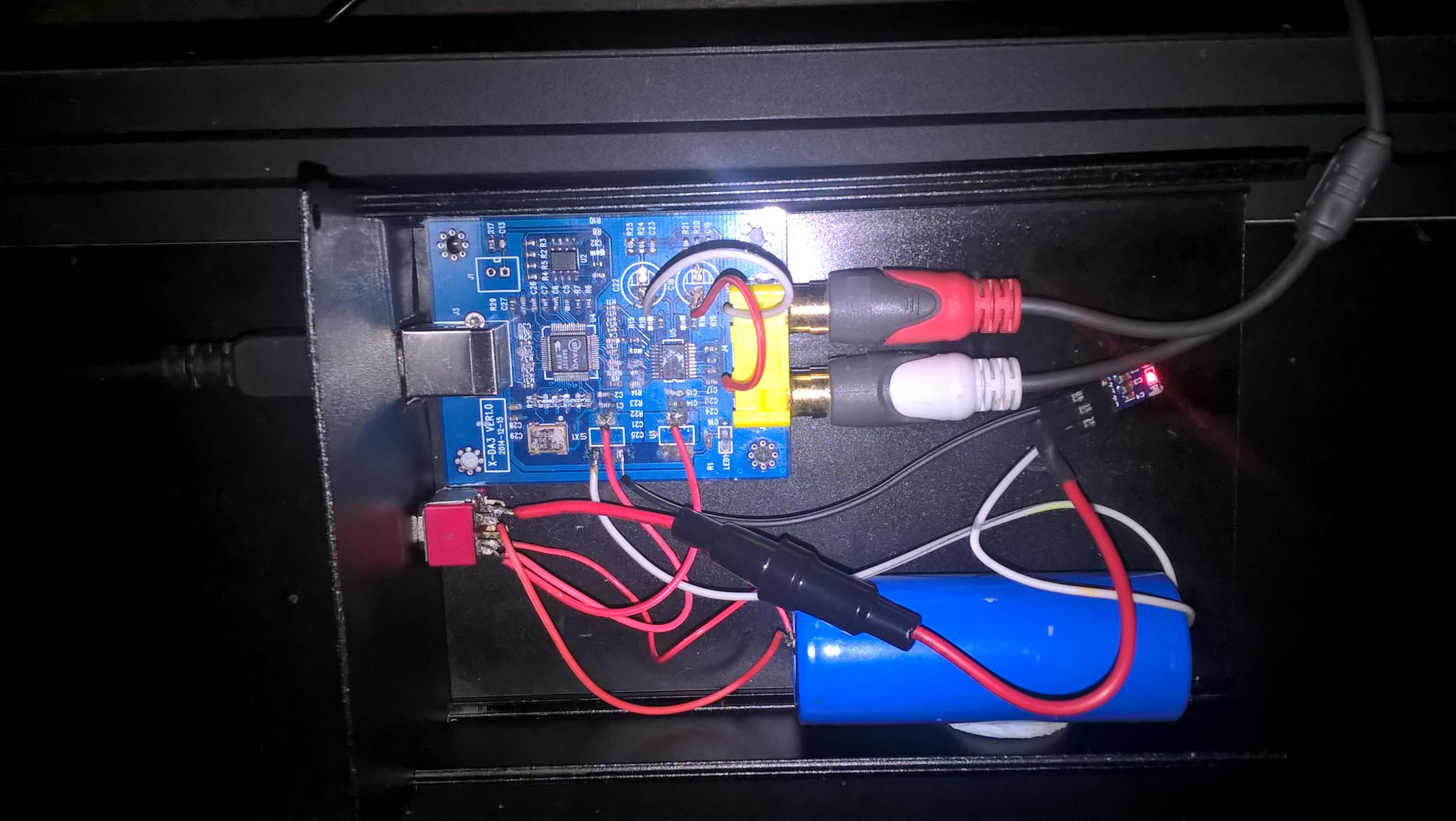

Here is latest incarnation of the DAC in a new 150x105x55mm case. Having tested various linear PSUs (LT3042/ADM7150 etc), I have now gone down the 3.2v 26650 LiFePO4 battery route. These batteries have an extremely low resistance and a stable output which is perfect for feeding this dac.
The onboard AMS117 regulators have had their 3.3v supply to the board cut and instead provide a float/trickle charge of 3.3v to the batteries through a resistor to limit current to about 500ma. The batteries then feed the board directly via a dual pole switch (no regulators etc). In addition because the batteries are able to supply current so fast all the capacitors on the supply rails have been removed (even the bypass caps). There is debate and argument on various forums about the merit of this but the sound quality is greatly improved by doing so. In addition the low pass filter and DC blocking caps have been removed and the phono sockets wired directly to the DAC analogue out. Only C24 & C20 remain in place, C14,C15,C16,C16,C18,C19,C21,C22,C23,C25, R20,R21,R24 & R25 have all been removed.
I have tried various things with this board, but this by far provides the best sound quality by some margin - bass, depth, vocal space, top end.

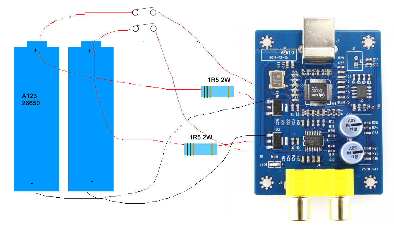

Will you be so kind to draw all that has been done, with the correct values and connections.

Please see attached for the power arrangement (NB the regulators have had their 3.3v supply to the board cut)
You do need HF decoupling for the DAC, and there is significant distance between the battery terminals and the DAC IC, so this means significant inductance. Retaining the low value bypass caps right beside the DAC pins will result in better technical performance (if not your subjective preferences).
Also, do the regs remain in circuit during use? If so they will still be injecting noise during playback (albeit the 1.5r series resistor and low ESR of the battery will reduce this). If the regs remain in circuit it's hard to see the technical advantage of the batteries vs low ESR caps (again, subjective differences may vary).
Yes they do, to provide a float charge to the battery, but the sound does not change if they are disconnected which leads me to think that either the battery absorbs the noise or it never reaches the DAC. The only way to appreciate this is to try it.

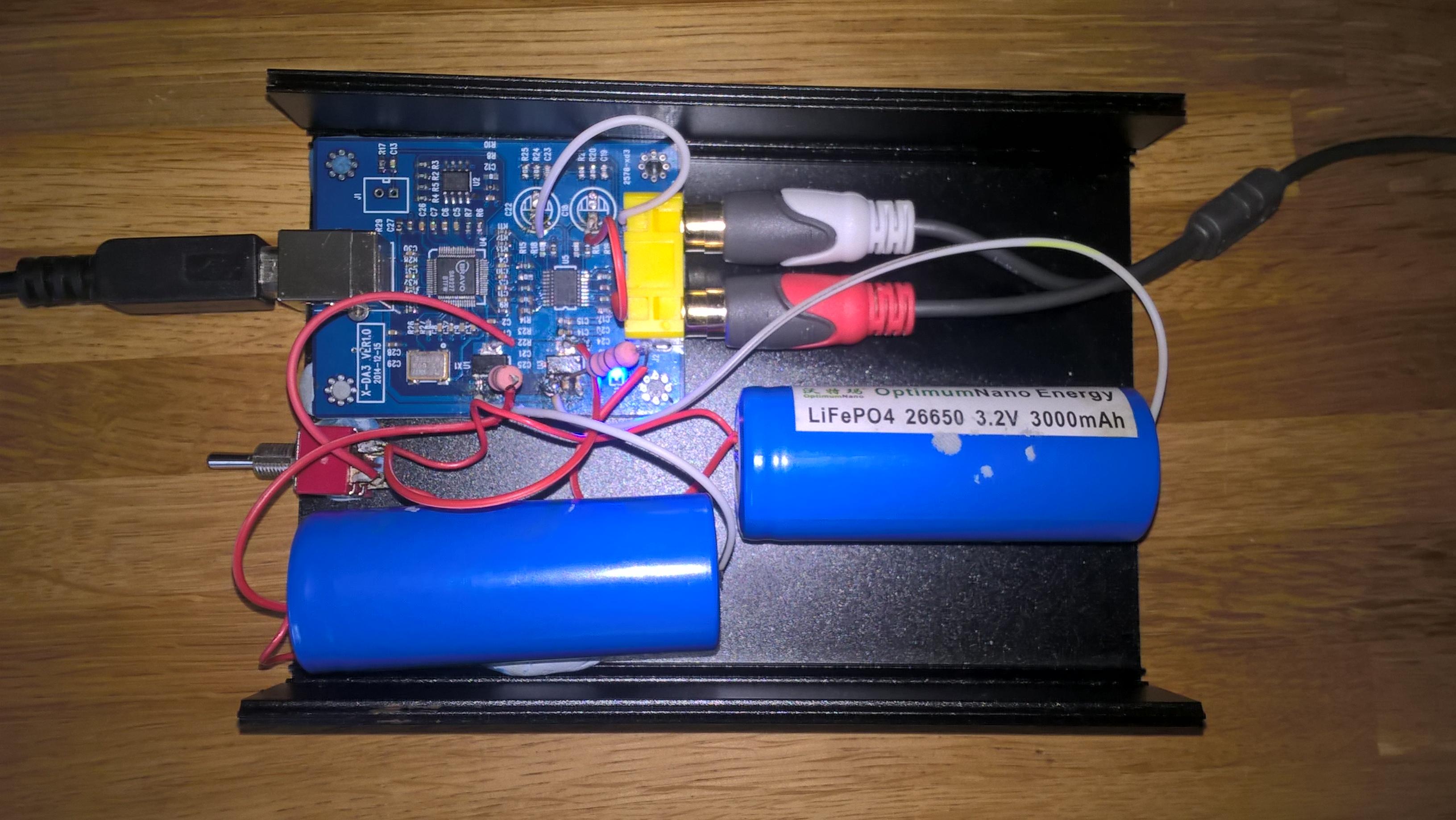

Here is latest incarnation of the DAC in a 150x105x55mm case. The 3.2v 26650 LiFePO4 battery provides an extremely stable pure DC voltage with no AC ripple.
Having removed all the power bypass capacitors around the DAC, I have now removed all the caps around the SA9227 receiver chip, eprom and USB clock. This has reduced noise, improved timing even further and as a result sound quality has improved no end.
The onboard AMS117 regulators have been removed as has the onboard LED. There is a separate 5v to 3.3v power supply float charging a single battery which feeds the USB and DAC circuits. Only C13, C20, C24, C28 & C29 remain on the board. The float charge to the battery is protected by a 250ma fuse and both the charge supply and the supply between the battery and the board share a dual pole switch (so the battery can be isolated when the device is switched off). As the battery keep its charge so well there is no need to constantly trickle charge and any recharging only takes place when the device is being used.

Hi, what does it mean: "There is a separate 5v to 3.3v power suppy"? Is this a separate ams1117?
Yes, there is a separate AMS1117 board which provides the float charge protected by a 250ma fuse. The switch disconnects the battery and the charger so the battery is isolated when not in use. It does not lose charge so works well.
