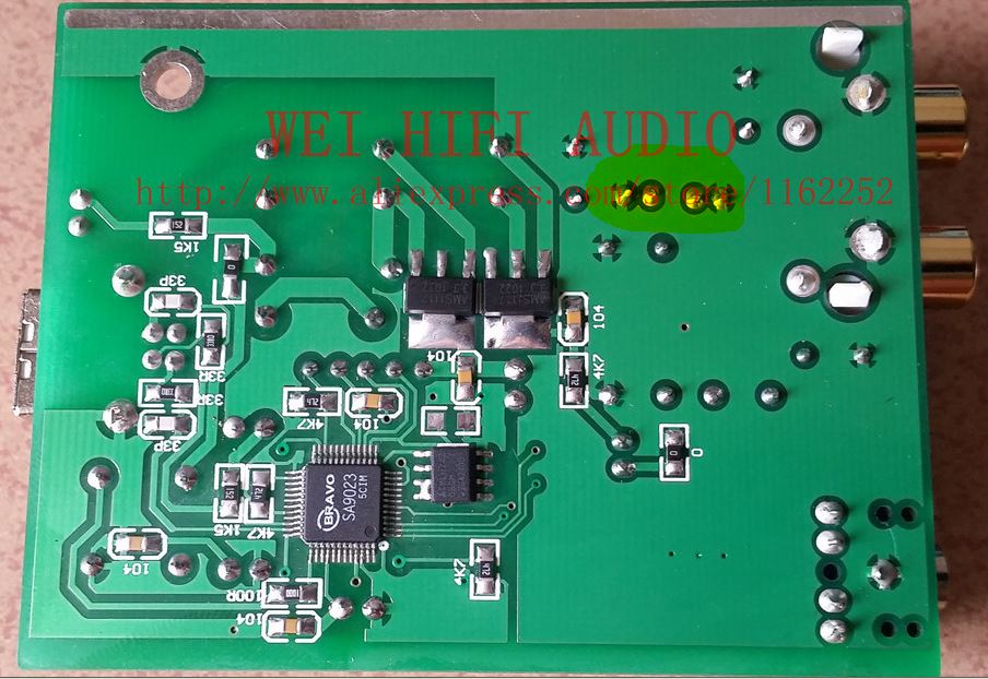

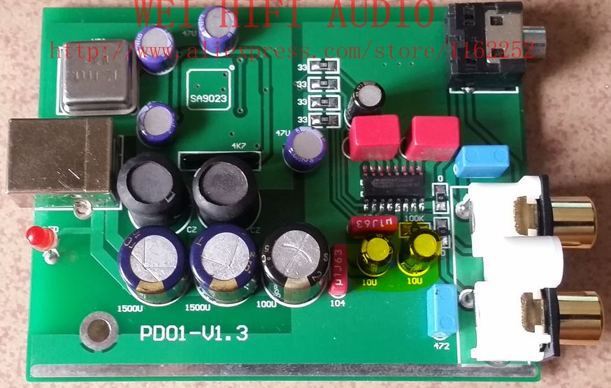

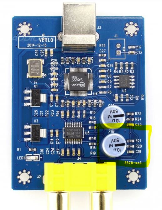

I have this DAC that combines the SA9023 and ES9023 and it sounds very good for the price. I notice that they have the two 10uf caps [see attached pics] so my question is whether it is worthwhile [for the sonic improvements to be had] to remove them, short their pads and solder in caps to the AMS1117 regulators like was done in post 4 or just remove the caps and short their pads for cleaner output?
Just remove them. I wonder who designed these circuits. It'd be strange to use output caps since these DACs (ES9023 & PCM5102) are mainly advertised for direct output (ground centered, 2Vrms).
Thanks!Just remove them. I wonder who designed these circuits. It'd be strange to use output caps since these DACs (ES9023 & PCM5102) are mainly advertised for direct output (ground centered, 2Vrms).

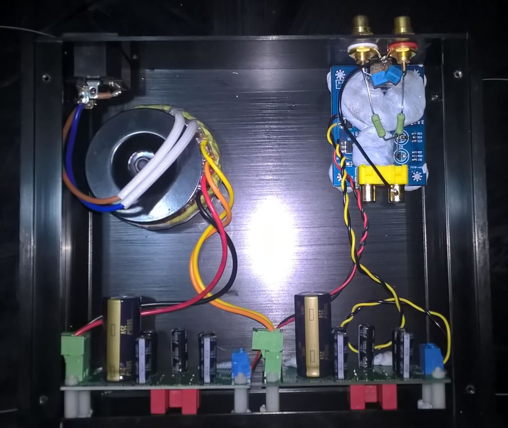

Now that the DAC is in a case, thought I would upload a pic. Two ultra low noise external 3.3v feeds bypass the regulators to supply the DAC and USB chips and the output stage has been modified to incorporate a 470R Kiwame resistor and 2N2 Evox Rifa PFR poly prop cap hardwired to new phono sockets as recommended on the PCM5102A datasheet.
The 5102 has three 3.3v power inputs, are they all powered by your new supply on the same rail, or are there further regulators on the board?
yes one supply feeds the dac the other feeds the receiver chip. The DA3 only has two regulators so the Dac power pins share the same feed.
Weren't the caps and the resistors [both SMD's] already present on the board?<snip>......the output stage has been modified to incorporate a 470R Kiwame resistor and 2N2 Evox Rifa PFR poly prop cap hardwired to new phono sockets as recommended on the PCM5102A datasheet.
There looks to be 2 caps and a resistor on the board but I wanted to try a boutique option especially the resistor as it's in the signal path.
Correction, after the 10uf blocking cap, there is a resistor going to ground, signal path resistor and then cap going to ground.
