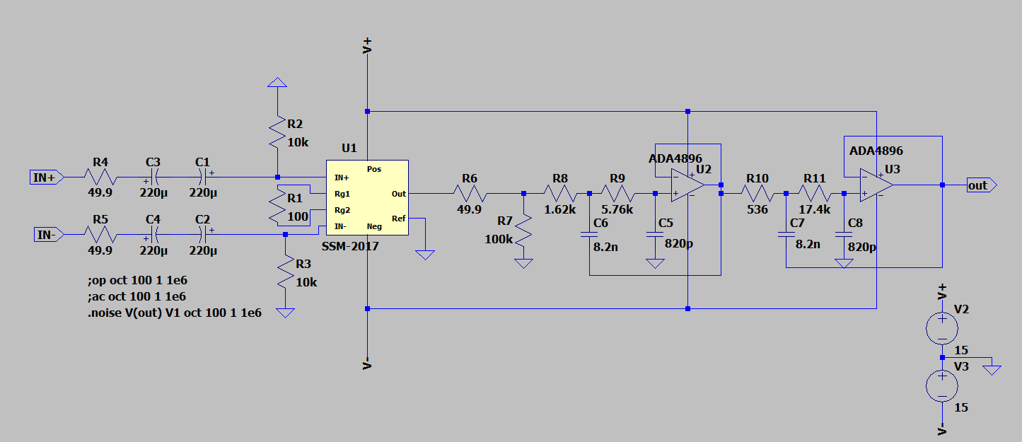

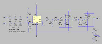

i was going to suggest a modification to WJ's 1995 articles on power supply testing -- he used an SSM2017, the SSM2019 which replaces it tests under 1nV/RtHz and there are similar diff amps (Tex Instruments, THAT corp) which do just as well, if not a touch better.
If you measure the noise in the 20 to 20kHz bandwidth (you'll need a good RMS detector) you'll get a very useable figure-of-merit with which to compare with other power supplies (R6 is unnecessary):
Sounds cheap enough, even for a cheap-skate like me 🙄, but would think that if you can actually hear it you have a really big problem.
And if you can't hear it...
As is R7 I guess. Do you have a PCB for this Jack?

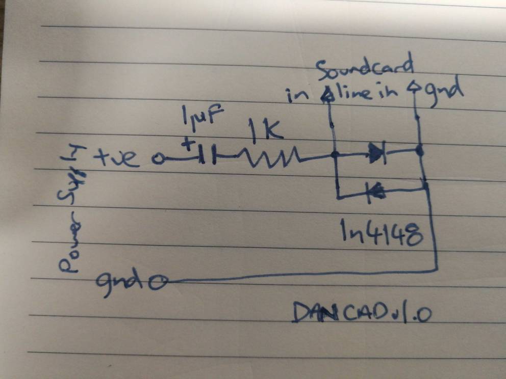

I'm pretty much ready to go now. Collected the Lexicon USB ADC yesterday and have made up a lead with a 1uF electrolytic inline. Hope to install the software this evening, then test tomorrow or weekend.
Is there anything else I need to be aware of, to avoid blowing the input of the Lexicon?

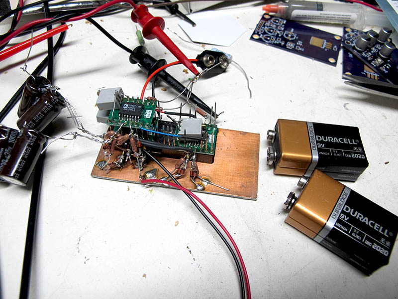

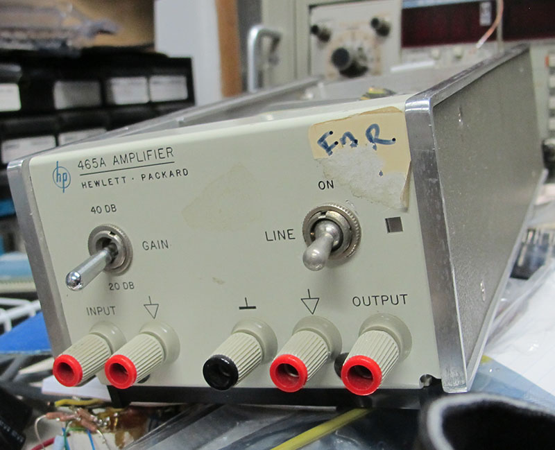

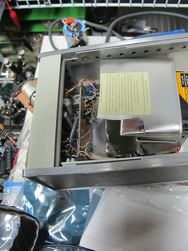

Dead bug style -- there are more elegant ways of doing this. One I have mounted in a HP465 amplifier carcase with gain of 20/40/60dB. It's input impedance is too low for work with tubes:
That's a nice case of re-purposing a piece of equipment! If the designer would only know to what honors his simple case was to be elevated! ;-)
Jan

If you wanna play safe, put a resistor in line (say, 1k, that shouldn't add significant amounts of noise or attenuation) and put 1n4148 or similar diodes both ways across the input. That will limit the peak voltage to around 0.6v.I'm pretty much ready to go now. Collected the Lexicon USB ADC yesterday and have made up a lead with a 1uF electrolytic inline. Hope to install the software this evening, then test tomorrow or weekend.
BR.
Excuse the crudity of my diagram, I didn't have time to draw to scale or to paint it.
