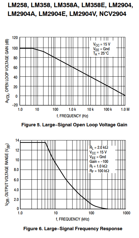

Here's an LM358 configured as an inverting amplifier
The LM358 has no bandwidth to speak of, its not suitable for audio signals, its commonly used to set DC control signals in equipment as its very cheap, low power, and can handle DC tolerably well, basically protecting the output pin of a DAC... Personally I avoid it because it its easy to be bitten by its limitations (you forget how slow it really is!) and there are literally 100's of much much better rail-to-rail opamps these days.
Same bandwidth as the uA741
_
The full swing bandwidth is only 5kHz. Normally devices for audio tend to quote a full-swing BW of 100kHz -- several MHz, because to keep distortion under control it helps to have plenty of headroom for gain and for slew-rate. The 741 manages twice the full-swing bandwidth of the LM358 despite having the same slew-rate of 0.5V/us.
Only because the LM358 datasheet authors have chosen to plot full swing bandwidth with single ended supplies, while the uA741 datasheet plots full swing bandwidth with twice-as-big supplies, namely plus AND MINUS 15 volts. Chips work the same, chip marketers spin them differently.
Too bad the LM358 can't reproduce a 5 kilohertz sinewave when operating at a gain of -1, despite having a bandwidth of 500 kHz at a noisegain of 2 (which is an inverting gain of -1)
According to the TI datasheet, the slew rate of the LM358 is typically 0.3 V/us. The LM358B has a typical slew rate of 0.5 V/us.
According to the ST datasheet, the LM358 has a typical slew rate of 0.6 V/us and a minimum slew rate of 0.3 V/us.

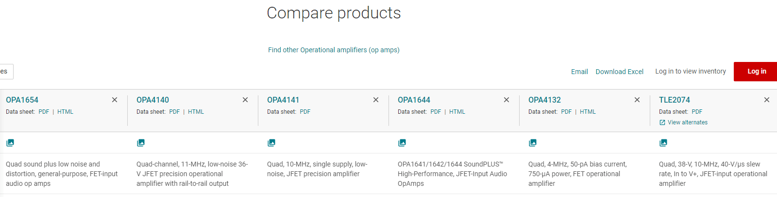

Anyway back to topic. Is there any good quad low noise jfet opamp?
I find OPA1641 is a very nice quiet upgrade for TL071. I haven't used many, but I haven't seen popcorn noise (and I do look for it). The really alarming thing about popcorn noise is that it barely shows on a noise spectrum, even though it is obvious in the time domain.
