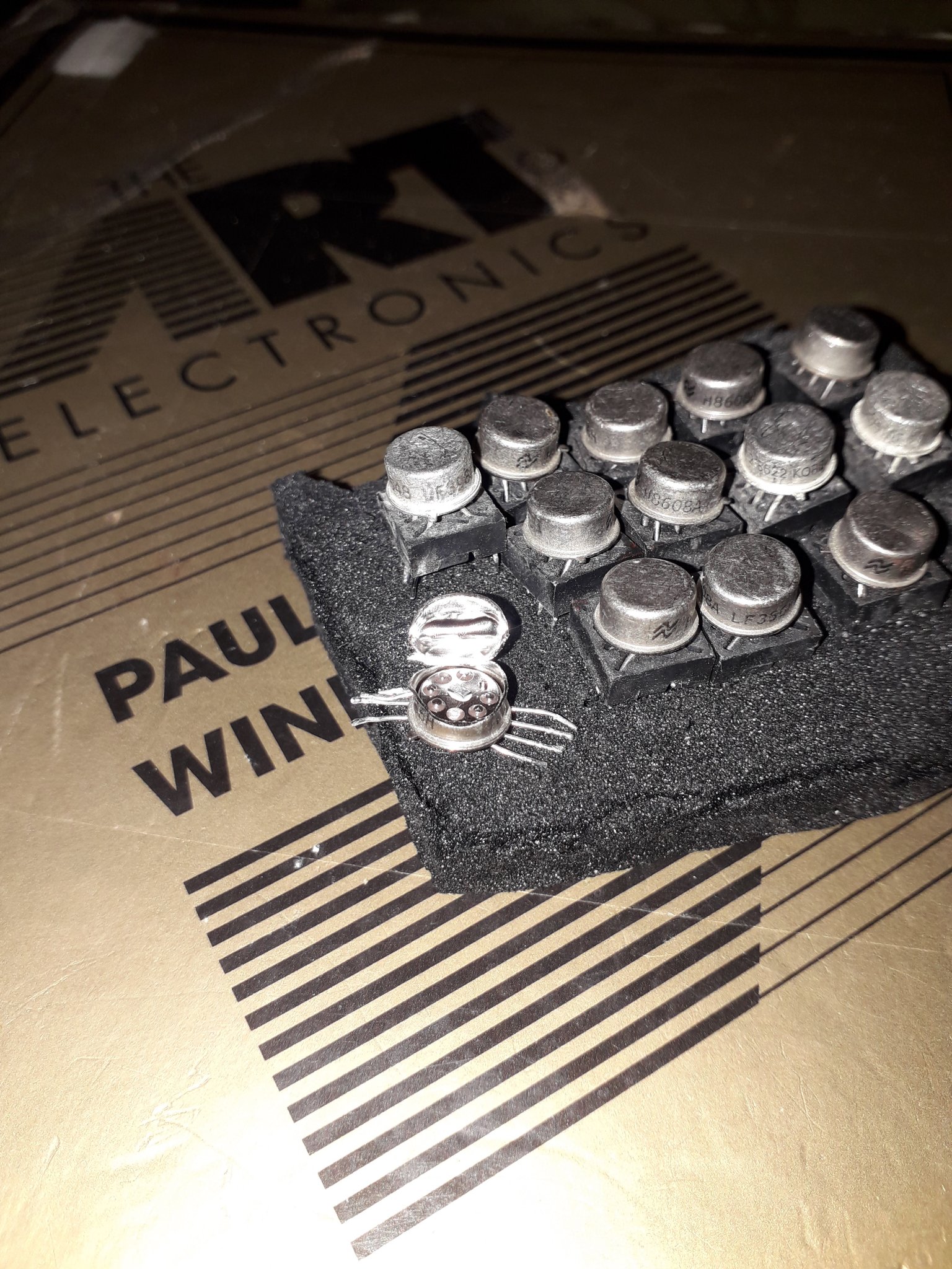

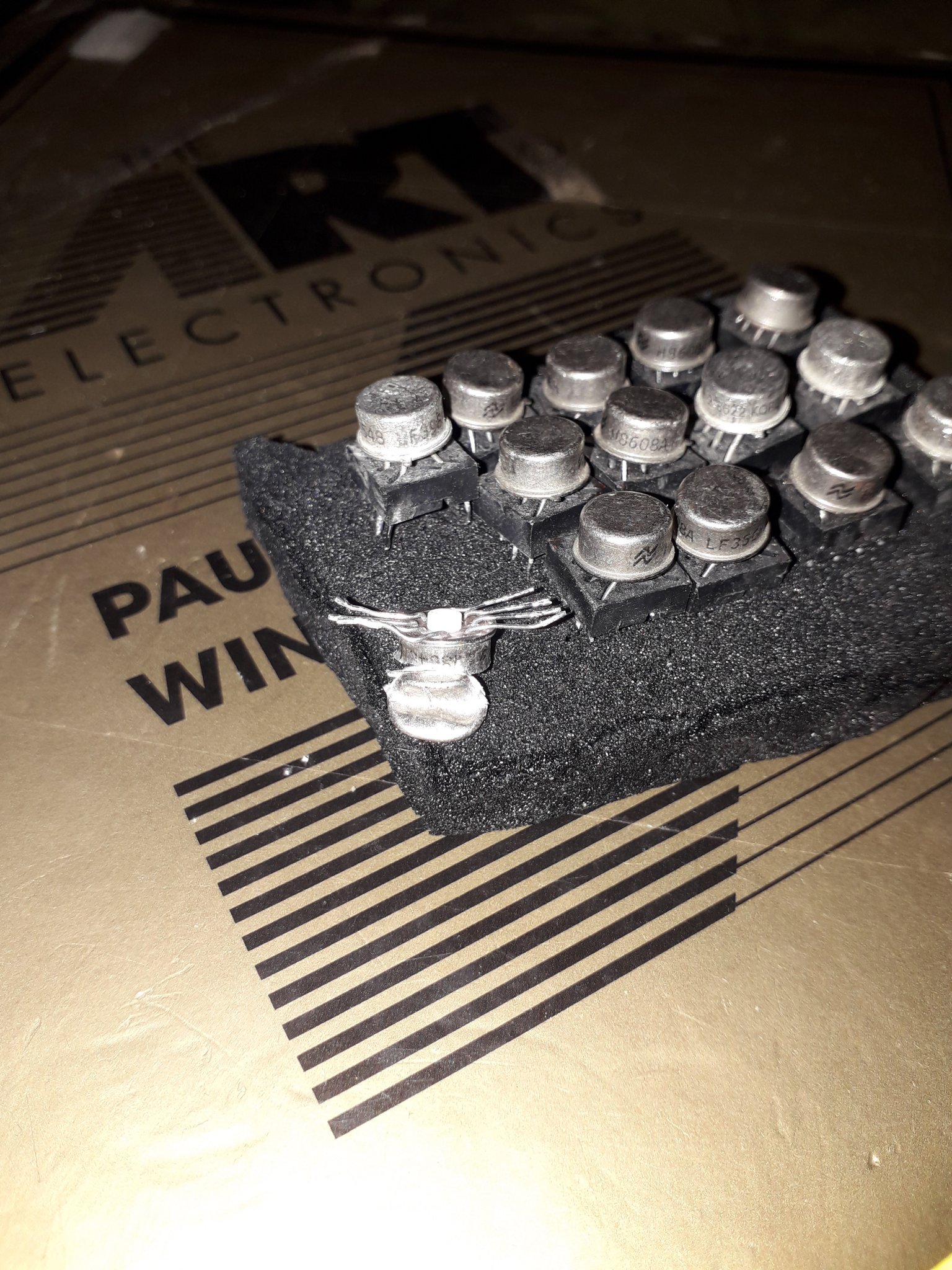

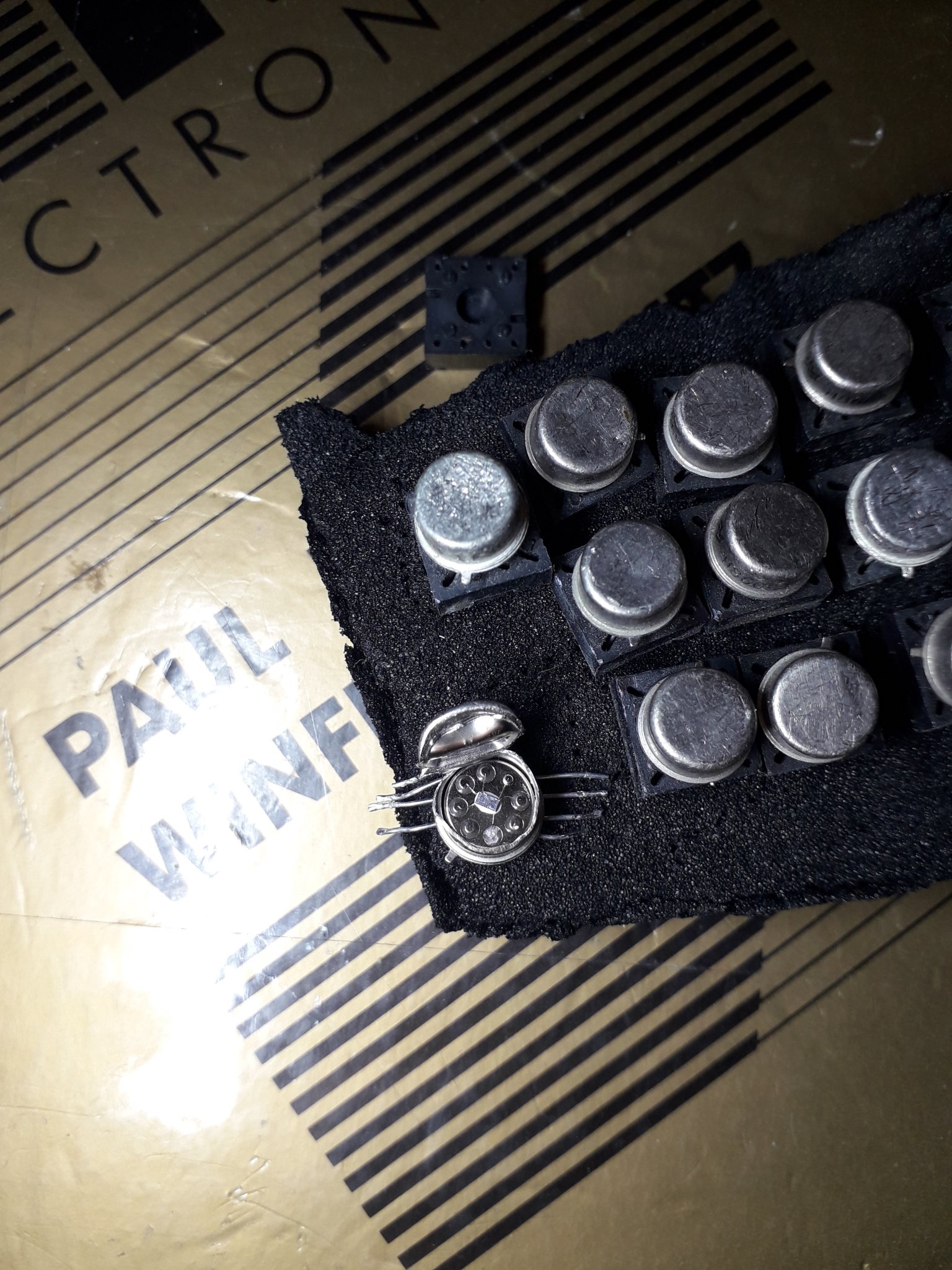

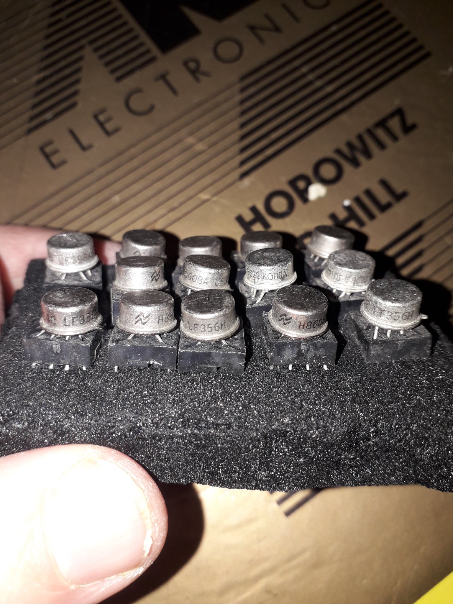

Thanks to the OP and all the others who gavd me real hopes of giving these little guys a new life! I just desoldered them from a 1 million euros old MRI scan controller board.They didn't even get warm during the desoldering process...

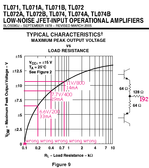

short circuit current was never specified for the old parts because it's probably only a handful of mA.
Hmmm. I never had trouble going by the 1978 data for voltage into load resistance, fig 9.
Except 0V in 100 Ohms is just wrong-- some draftsperson thought the graph had to go to the corner, not thinking-out the log scale. At reasonable loads 200r and up it fits with, not a current limit, but dumb resistance. Slightly higher than the 192r explicitly given on the schematic. As always you prefer to load 10X high, 2k, but it 'works' in hundreds of Ohms.
