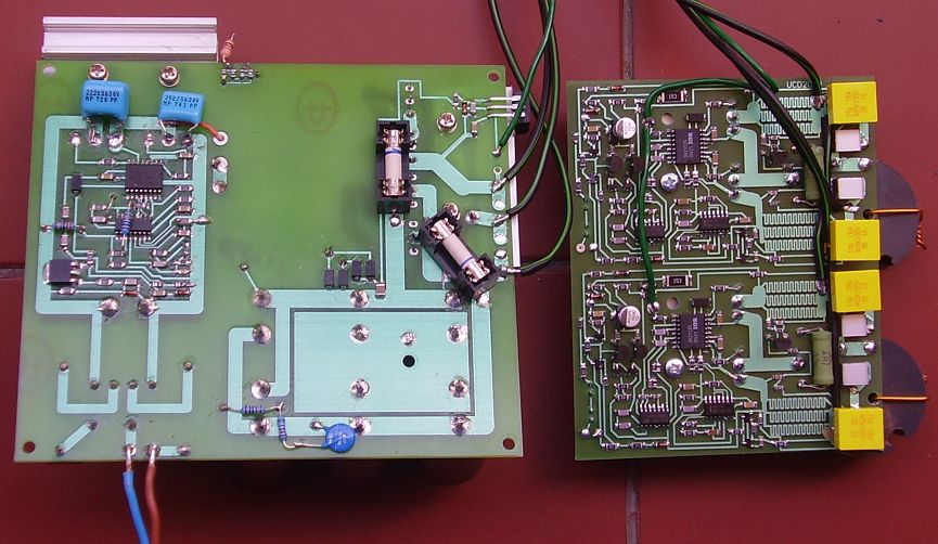

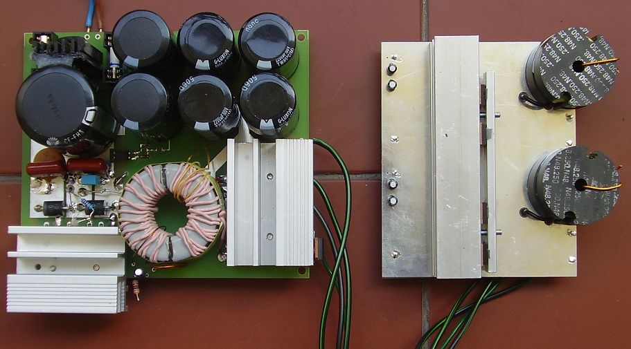

I tried it with the amplifier, both sine and music, it worked well, but there is no other interesting information or nice picture.
There is only one news: I had to replace input NTC to a bigger one, because it heated too much.

You can get shocked only if you don't use protective earth, but this is quite usual. And how? There can be very high voltage spikes on network sometimes. They are generated for example by disconnecting some big load, or by terciary effect of lightning. They can make a small spark, then the line voltage can go thru. Some kind of dirts can ruin isolation too. 1 mm can be good for many years, but...

I understand and I don't use it. I wanter, but I decided I don't need it, I just made it so I can say it works...maybe to prove to others that it is not hard at all, you just have to take it step by step

I didn't use EE, but if you would you only need to get right material and enough cross section for power you will use, other then that I don't care what core it is...maybe just, how easy you can wind it, but most are easy to
