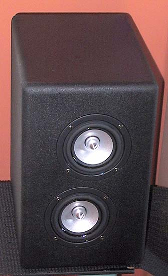

I know what you're thinking. "2 three-inchers?!?", but I heard these at the NW DIY and was pretty inpressed. I don't know if you'd be able to beat the sound for the price. $389 for 5 speakers. If you add a sub, you'll be laughing. They're in Canada(BC) which is a bonus customs-wise. The boxes are all CNC cut so they're pretty easy to put together.

The picture on the link at CSS is a custom box. The kit, with some textured black paint, looks like this:

I heard Jim Griffin's pair (the one shown in the pictures on that site with the purple sides) at DIY2002, and they are impressive considering the small drivers and the price of the entire package. With a subwoofer, you will find a hard time beating this speaker set for the price.
