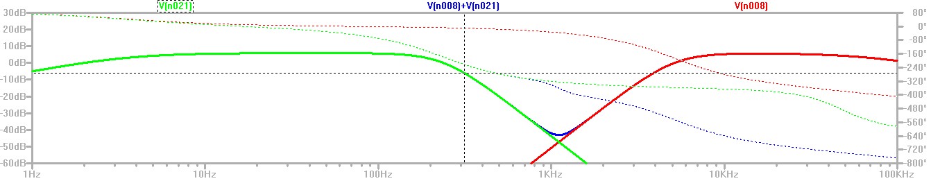

I've just tried simulating this circuit in Ltspice, because it does look rather elegant and well it does work. The bad news is that the filter frequencies are all wrong if I did the simulation correctly. These will have to be recalculated.

I'm afraid my post wasn't that clear. I've used the schematic and component values from the post here: http://www.diyaudio.com/forums/analog-line-level/289754-cheap-chinese-active-x-o.html#post4683842
The filter frequencies are just wrong. (see attached plot)
I assume the reason behind this is that the schematic was a 3-way crossover at some point and somebody removed the bandpass part. Although I don't see any harm in having a gain stage as an output buffer, because as you've stated it can be converted very easily to +0dB by removing R11/R22 and fitting a piece of wire instead of R8/R19.

I used this to calculate the filter parts:Pronine Electronics Design - Sallen-Key Active Low Pass Filter Calculator
You can input two values to get the third.
And this one:http://sound.whsites.net/project09.htm#download_esp_lr
It works better than the first one if you only want to calculate the frequency with standard component values.
