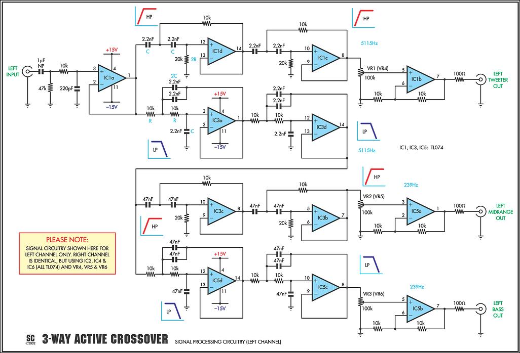

The above circuit buffer opamps 1b & 5b are a gain of 2, with a level trimpot in front, this isolates the also the xover opamp 1c 5c from the outside world.
It would have been nice if the Chinese xover had this and a level trimpot as well.

Trouble is with this Chinese xover if the amps are not the same gain then you have no adjustment of volume over the highs or lows on this xover, so to get the balance right.
So it would have been nice to have a level control with output buffer after the highpass and low pass sections, to fine tune the balance between highs and lows. (just like the one I posted)

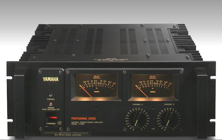

the world is loaded with poweramps with volumecontrols🙂
The majority of poweramps usually don't, at least the ones I've had in the last 40 years of hi end audio.
Sorry one did the 1976 Yamaha P2200 poweramp did, and it had a very good pot, an Alps Black Beauty, even better than the Blue Velvet, the amp was OK'ish good bass, mids and highs so so.
Why not just have a level trimpots on the xover like all active xover have, and then it will suit everyone.
Cheers George

Here is the three way of the same active xover. Very well thought out, as you can see input and output buffers to keep all active xover components isolated from the outside world, with level pre-set trimpots before the output buffers.
http://archive.siliconchip.com.au/cms/A_30278/article.html
