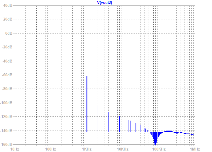

The graph is unusual too (I have never simulated anything that has zero features before)
Not to burst your bubble too much, but THD is one of those things that is often not covered well in the simulation models. Your sim shows that you didn't make any obvious mistakes. I highly doubt measurements of the circuit will come even remotely close to the simulated values.
Regardless, it should still be a pretty nice amp. Watch the power dissipation in those itty-bitty packages, though.
Tom
Here is an interesting surprise, I replaced the LME47720, the supposedly "king of the low THD" opamps in TI's arsenal, with the lowly OPA1688 (which is also serving as the buffer).
Simulations of THD, while using only basic functional opamp models, make no sense. It will not produce any meaningful result. Those models are made from a bunch of controlled voltage and current sources. The only nonlinear effect they usually take into account is supply rail clipping.
There are transistor level models of opamps, but the one you have is not one of them.
For comparison, somewhat similar nested feedback circuit perfomance:
OPA1611 "The Crocodile"
vs
OPA172 - "The Crocodile"
LME49720 is a bit more nonlinear in those conditions compare to OPA1661, but not by a huge lot.
You can open a model in a text editor and have a look what it contains.
Some models have an input stage "made of" transistors, to model noises and other effects associated with an input, and the rest of it made with controlled sources.
The fact that it runs a low does not say a lot. It may be happening because something makes spice to use very small timestep and not because if complexity of a model.
Here is the OPA1688 model from TI. The following are modeled (see bold below) - seems quite comprehensive to me

As i was saying, it does not contain a single transistor. Modeling distortion with this model useless.
There was no even need to go that far, it was obvious from spectrum you posted.
BTW, whatever it says this model covers in its headline is often far from being real. Yes, those header can lie 🙂
It appears to be a phenomenological model not a network of discrete actives. That doesn’t automatically make something “useless” - a company like TI with armies of engineers would probably not release useless models of their parts.
With Lser=0.15ohms for the PSU rails, the distortion sims are higher in THD and probably closer to reality. it really is sensitive to the series resistance of the power supply rails. The cases before were idealized ultralow ESR cases.
Here is 28Vpp into 50ohms with PSU Lser=0.15ohms:
attachment.php
FFT Components:
Harmonic Frequency Fourier Normalized Phase Normalized
Number [Hz] Component Component [degree] Phase [deg]
1 1.000e+03 1.402e+01 1.000e+00 -0.04° 0.00°
2 2.000e+03 7.864e-06 5.609e-07 -178.42° -178.37°
3 3.000e+03 8.375e-09 5.974e-10 -5.85° -5.80°
4 4.000e+03 3.135e-06 2.236e-07 -176.02° -175.97°
5 5.000e+03 1.392e-08 9.926e-10 -3.43° -3.39°
6 6.000e+03 2.004e-06 1.430e-07 -173.77° -173.73°
7 7.000e+03 1.946e-08 1.388e-09 -2.37° -2.32°
8 8.000e+03 1.473e-06 1.051e-07 -171.53° -171.49°
9 9.000e+03 2.501e-08 1.784e-09 -1.75° -1.70°
Total Harmonic Distortion: 0.000063%(0.000000%)
So it does respond to changes in circuit design and is not stuck at zero THD. Also note that the character of the HD is descending higher orders with dominant 2nd order, whereas the LME49720 has dominant 3rd order as shown in Post 1.
First off, TI does not have "armies of engineers". When I worked there, we were all stretched pretty thin. Secondly, just because something is not "useless" does not mean that it is useful.
Models will always have their limitations. When you model something, you usually get to choose between having a model that fits broadly but isn't super precise, or a model that is very precise within a narrow operating range.
I think TI did pretty well in their modelling of the OPA1688 - at least judging by the feature list. All the important stuff is there: Small signal response, large signal response, loop gain/phase, etc. But you will also notice that THD is not on the list.
Your notion that "it takes a long time to simulate, therefore it must be a really good model" is laughable. The reason it takes a long time to simulate is most likely that the simulator has a hard time getting the simulation to converge on a DC solution so it can start the transient sim.
You've already shown the world that you have an amp that's probably not broken. Now do yourself a favour: Build it and measure it. Have a listen.
Tom

Modeling opamp thd using model build only using controlled sources is useless, period. Results will have nothing to do with the reality.
I'm sorry I've broken your virtual zero thd dream, but your simulation results are misleading and give a wrong idea to others.

Only design decision based on sim was to use 1688 for the voltage gain driver in order to get a 2nd harmonic dominant profile (wheres 49720 was third order dominant). And low ESR rail caps to get low distortion based on low Lser values in sims. So is the 1688 model not accurately showing relationship between PSU series resistance and distortion? I think the model of the 1688 does account for distortion. Lack of an explicit section on THD doesn’t mean it doesn’t model distortion arising from other non-linear effects as we can see when changing the Lseries or the load impedance.
Please show me an opamp model that explicitly accounts for THD and has “transistors” inside.
Saying that a Spice model of an opamp is useless because it doesn’t contain transistors is like saying a model of a transistor is useless because it doesn’t explicitly contain a section of N and P doping on valence electrons.
Again, absolutely no connection to what I was saying. If you want to continue a conversation with me, please read through all my previous posts.
You have made your intent clear. You make an assumption: I do not wish a conversation at all. Your attitude is one sided and arrogant and I know all the arguments on both sides. YOUR critical thinking is important here; an open mind.
You can assemble a test bench in simulator and verify if psrr matching a spec. This would be answer to your question.
Psrr can be reasonably accurate modeled using controlled sources. Although it will not show psrr vs supply voltage dependence.
