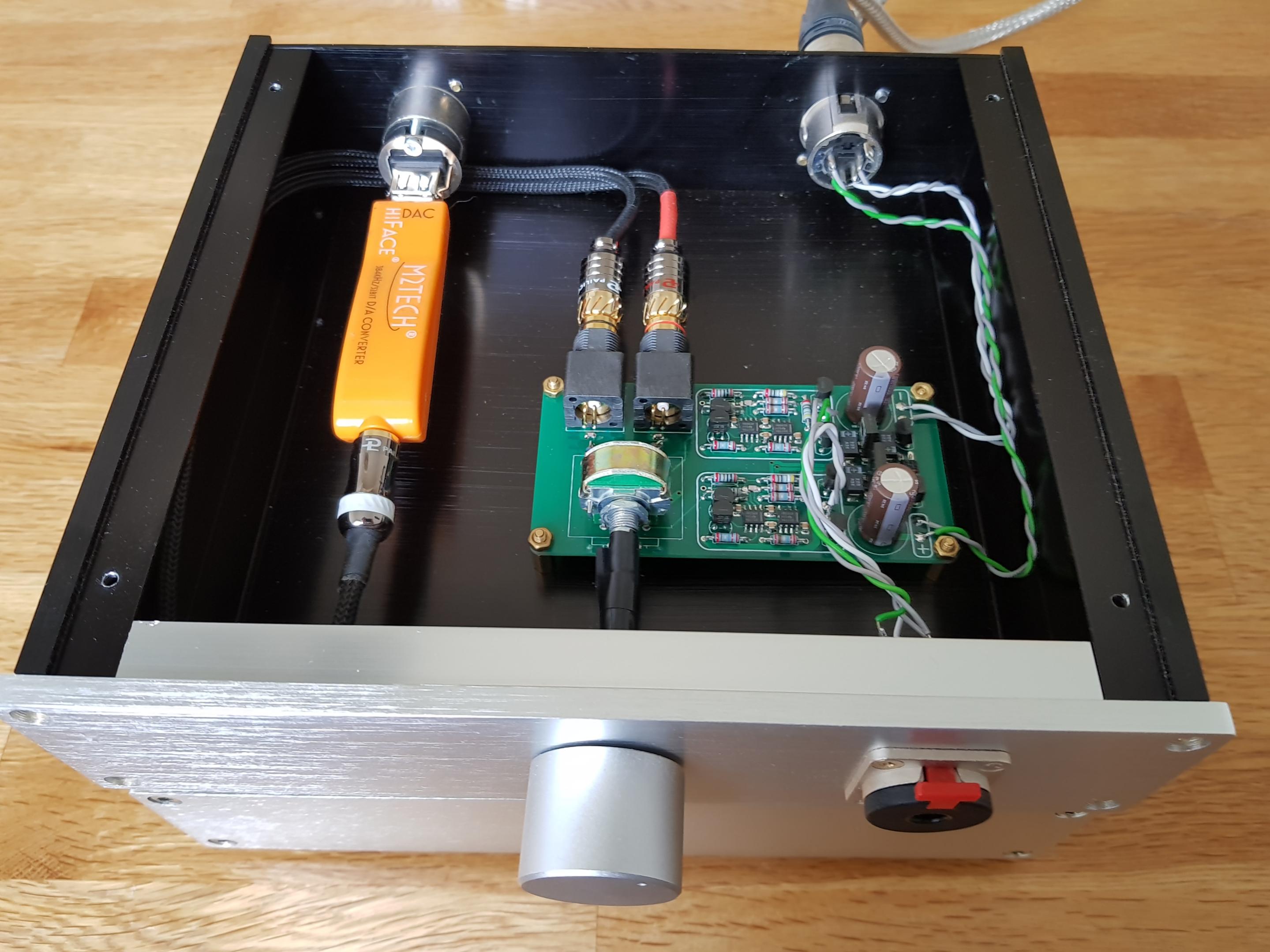

I made a similar amp earlier this year (when I realised the M2Tech dac I bought cheaply on impulse could not drive my headphones)
I used 2xOPA2172 per channel i.e four opamps per channel (however with all contributing output current) I also added some low IDSS 2sk170 for biasing and included regulation (simple Zener followers) +/- 5V

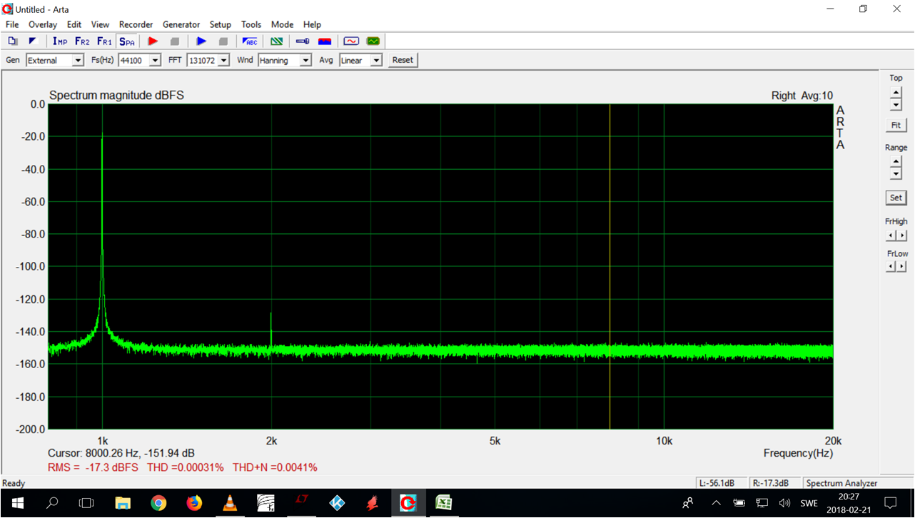

The measurement shows 1Vrms into 50ohm.

Nice design! Did you use the 2SK170’s to bias the rails into Class A?

It's a very nicely sounding opamp and is easy to work with, it has FET inputs and low offset I usually use it for servos but in this case its specs allowed for not needing AC coupling.
>> xrk71

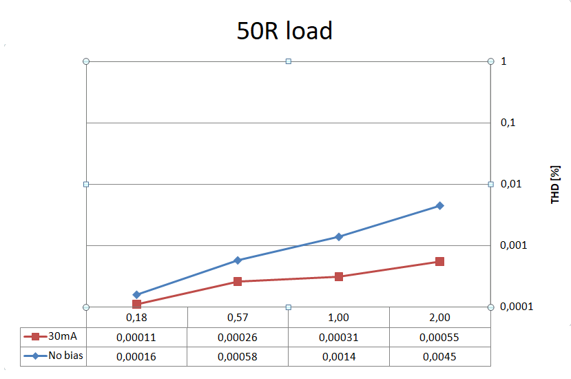

Thanks! I couln't resist adding some bias about 7mA on each opamp, simply beause I have lots of spare fets in that IDSS range, also it is nice to have some current through the emitter followers.
I attached some measurments with and without bias to this post but the without measurements may contain some measurment error as some BNC connectors where difficult to mate properly. I did not notice at first as I found the measurements to be resonable. When I remeasured with the bias added I noticed the offending connector and was more carefull to make sure it was mated as good as it could.
