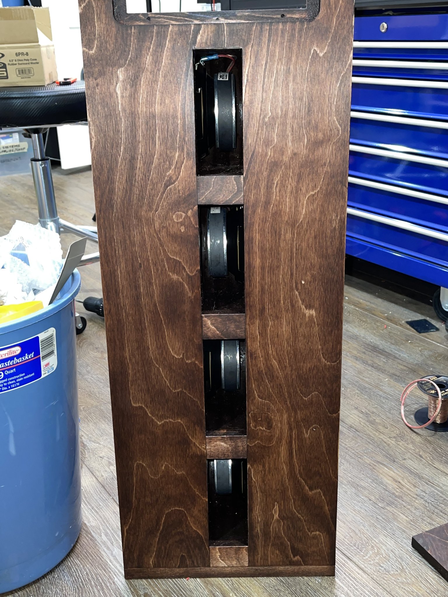

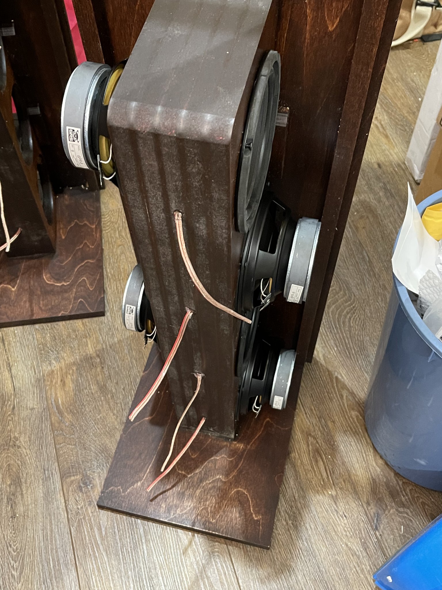

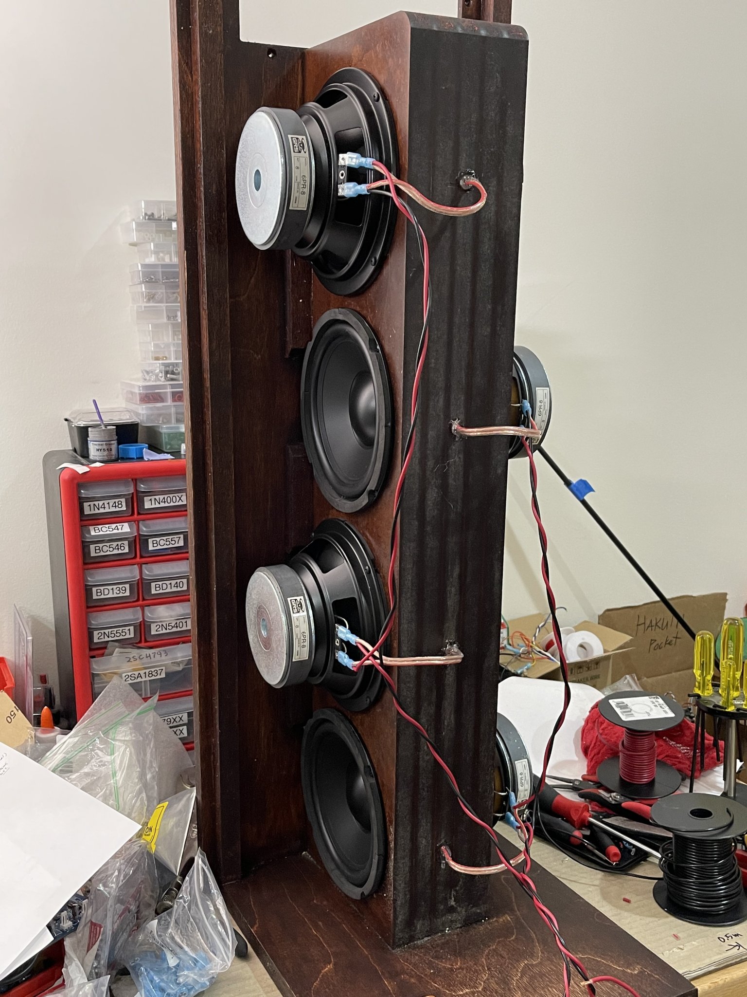

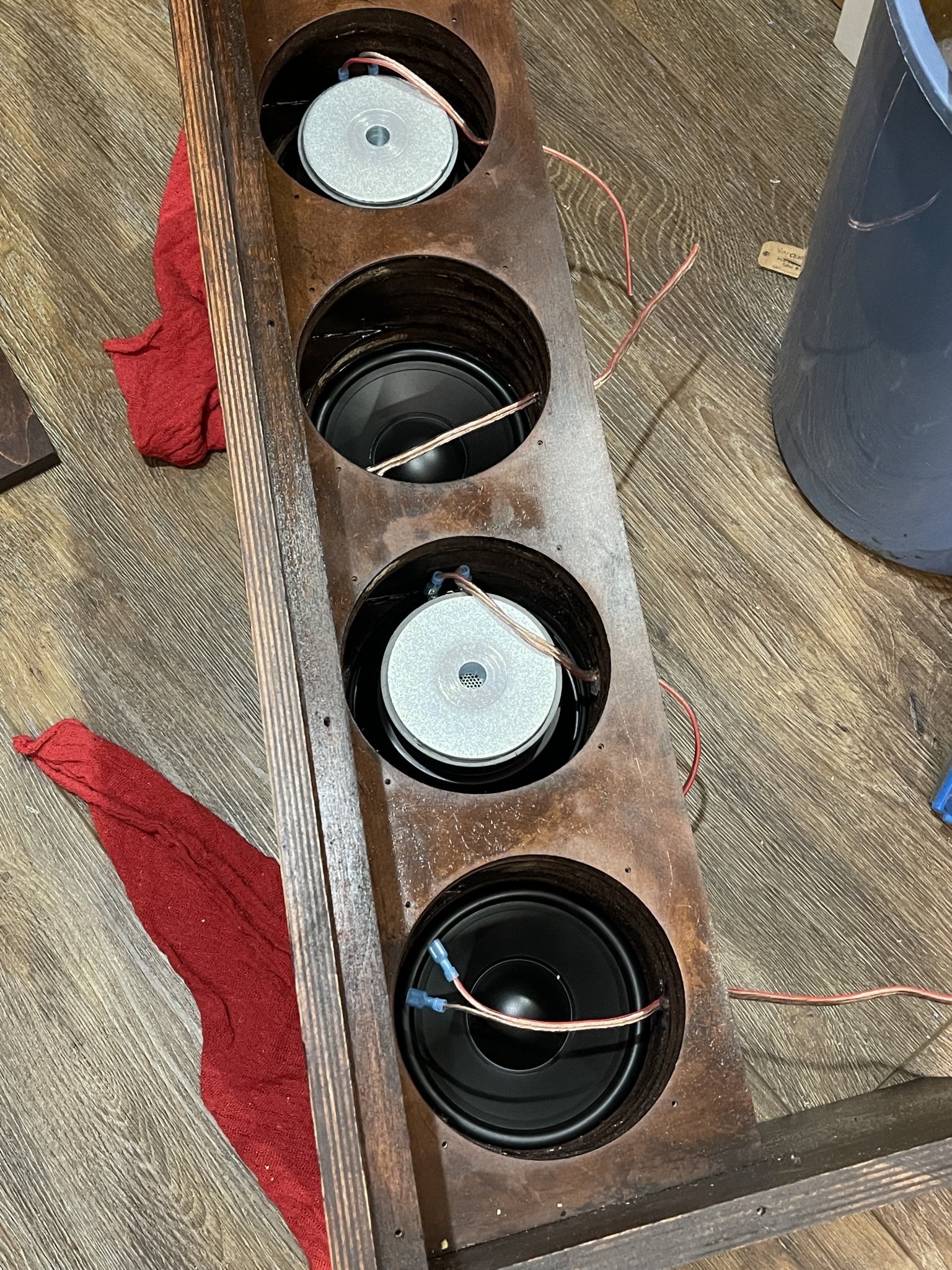

Installed the woofers today. 4 sets of parallel and 2x series then parallel those for 4ohms nominal. Alternating drivers in and out. All wired up and tested polarity with 9v battery. All drivers push in and squeeze air out of slot on +ve polarity.
The weight of 8x woofers is really noticeable. This is a heavy speaker now. Listing it up onto the bench to do the wiring wasn’t easy. About 52lbs now I think, before tops or wings or XO boards.
As I have no experience with SLOT woofers: Work all 8 Woofers in the same phase? I Wohls be happy for an answer

Yes all in same phase such that they squeeze air out of the slot together. Push-push. But if you install drivers such that the magnet is outside on one side and magnet inside on the other (to reduce suspension induced distortion), then the phase of the driver with magnet inside the slot is reversed connection so that it moves on the correct direction.

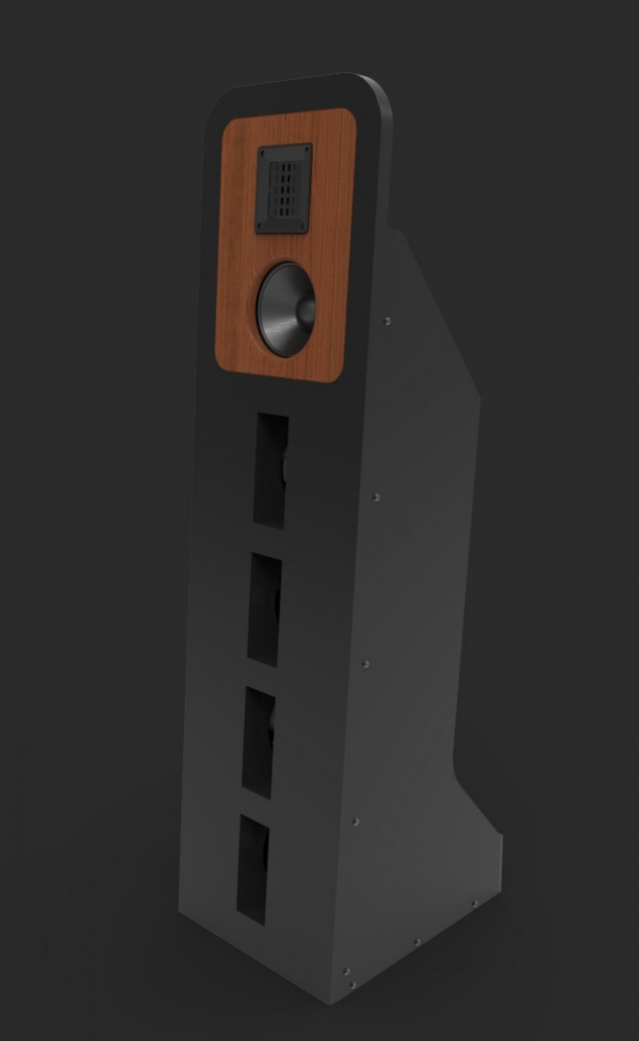

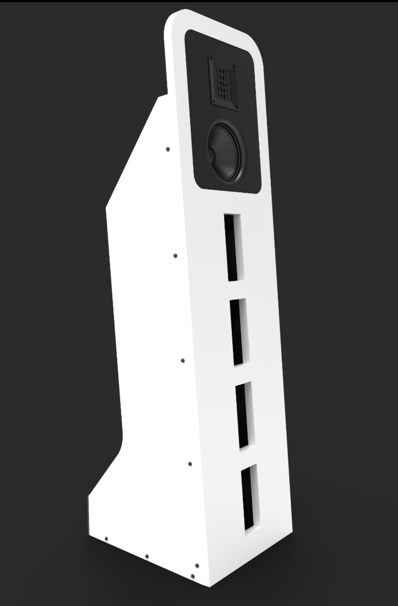

White or black? Maybe both…
Tweeter waveguide should be flush. Rebate not deep enough in render.
