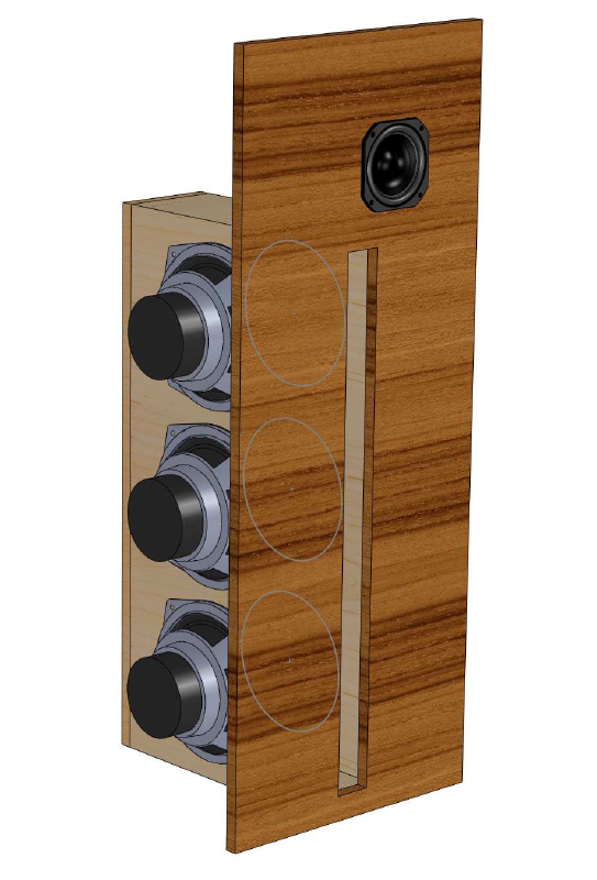

6 Driver Slot loaded OB
Here is a design I am thinking of: 12 in wide x 30 in tall x 10 in deep. I will probably add a rear H frame to this to extend the bass. The 3 drivers opposite the visible ones are mounted with basket facing in so that they can operate out of phase electrically but in phase acoustically to reduce distortion caused by hysteresis in cone movement.

I am still playing with the design to get the woofers to go up to 500 Hz as the small 6 in baffle makes it hard for the Vifa to go much lower. The woofers actually can go up higher very well with the slot loading but it is not flat and will require DSP to flatten. Thanks for the link to the OB project with flat phase. That is what I want to work on next.

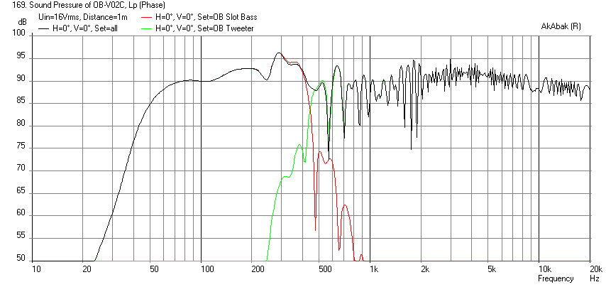

Here is the latest evolution of this OB design, now with a 5 in wide baffle for the Vifa to improve polar dispersion and imaging. The slot woofer chamber is now 7 in deep x 3 in wide x 21 in tall with a 1.75 in wide x 21 in tall slot. The lower woofer baffle has a 7 inch deep wing. It is interesting that adding a 0.5 in lip extension surrounding the exit slot port really helps to smooth the mid-bass. I am now running the woofer with a low pass at 210 Hz (-12dB/oct) and the tweeter with a high pass at 500 Hz (-12 dB/oct). The Vifa has to be attenuated by -3dB to match the output of the 6 woofers.
Here is the response at 16 volts rms corresponding to xmax.
Do you hear a difference with that narrower baffle?
That measurement looks steeper than 12db/oct. And looks like the Fc is about 450hz.
Sorry forgot to mention that the above is a simulation (thought everyone knew I was still in design stage) - says Akabak in top right corner of plot. 🙂 I have not yet built the slot baffle OB - drivers are out of stock until April!
Regarding baffle width: the imaging on the Nataloss monitors is superb and the baffle is 5 in wide. I have not measured the polar with the 12 in wide baffle but would imagine it to not be as good. I am just adapting the design based on Rudolf's measurement of the Vifa in a narrow baffle.
One caveat: It is not the narrower baffle per se, which leads to better imaging. It is the compact off-axis sound pattern of the narrower baffle with less SPL radiating sideways, which leads to less unwanted reflections. If you sit 20 feet away from your speakers, the narrow baffle will make no difference, because you are already drowned in reflections. If you sit 5 feet away, the difference should be literally "re-veiling". For anything in between, it depends on your rooms acoustic quality. If your room is "dead", it won't make much difference. But if your room is "live", you will appreciate the improvement.Do you hear a difference with that narrower baffle?
