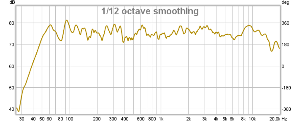

I took my own advice and reconfigured the XO at 210 Hz to avoid having to EQ out the bump at 270 Hz. It worked! Here is the in-room response at listening position with some miniDSP REW magic applied. You will have to interpolate the 5dB grid with your eyes as it is 10dB. My mini netbook screen is too small and at 5dB the image gets clipped. Anyhow, this speaker sounds quite nice - only had a chance to test out some vocals and jazz so far but liked what I hear.

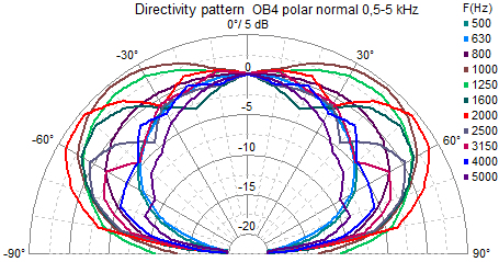

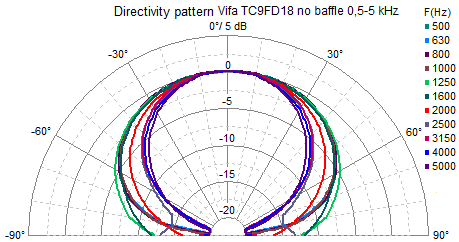

I mounted the TC9FD18 in two open test baffles and compared the polar response from 0.5-5 kHz:
Left baffle is 50x45 cm, right baffle is 14x21 cm.
This is the 0-90° response of the large baffle:
And this for the small baffle:
I choose 0.5-5 kHz because that's where the imaging happens according to Toole.
Just to make you guys aware that there is more than the 0° response 😉.
If I normalise the large baffle response to constant spl at 0° too, it looks like this 😱:

That's a good test! Very revealing outcome!
Wonder what it would look like without any baffle at all...

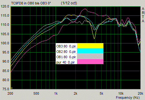

OB1 is 40x14 cm (HxW), OB2 is 21x14cm, OB3 is 14x14 cm. "pur" is without any baffle. I voted for best imaging with OB2. It does barely work down to 500 Hz. I'm not sure if the 50x45 cm baffle reaches 200 Hz.
Each of us has to choose the compromise that works best for him. I just wanted to show that it's always a compromise and no "optimum".
There you are:Wonder what it would look like without any baffle at all...
It seems that a small baffle can be helpful at times.
Rudolf
