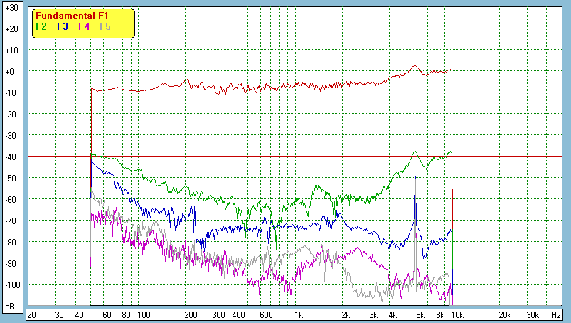

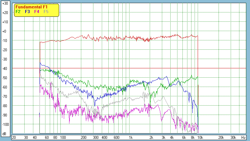

The SB drivers are half way there. The tweeter and woofer both have copper within the gap and this results in drivers that punch well above their price point in terms of distortion, especially with regards to the woofer. The midrange however, the SB12MNRX25-4, contrary to what Troels says, does not. This is an extremely odd decision made by SB as it results in significantly higher third order distortion than you'd want.
You can see how it compares here.
Zaph's measurement of the SB12 vs the SB15..
You can clearly see the difference.
If the SB12 had shorting rings/copper in the gap it would be an amazing driver, sadly it does not and as a result it's simply run of the mill. There are many drivers out there I would use in its place, in fact I wouldn't ever use the SB12 just because of this omission. Why should I when other drivers outperform it?
