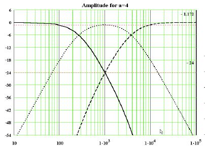

I would fancy a BW3 three way, but the classic 2nd order bass and 4 element mid plus third order tweeter is one way to go. Mid and tweet are offset to the centre to reduce diffraction issues.
