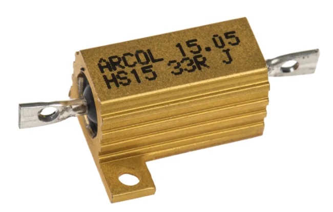

I often use the chassis to heatsink semiconductors via some sort of aluminium heat spreading/coupling system, when in doubt about performance I mount a aluminium housed wire wound resistor on the the thermal coupler powering it from my bench top power supply with a known wattage for a couple hours so the temperature rise above ambient can be measured and the system can be parameterized.

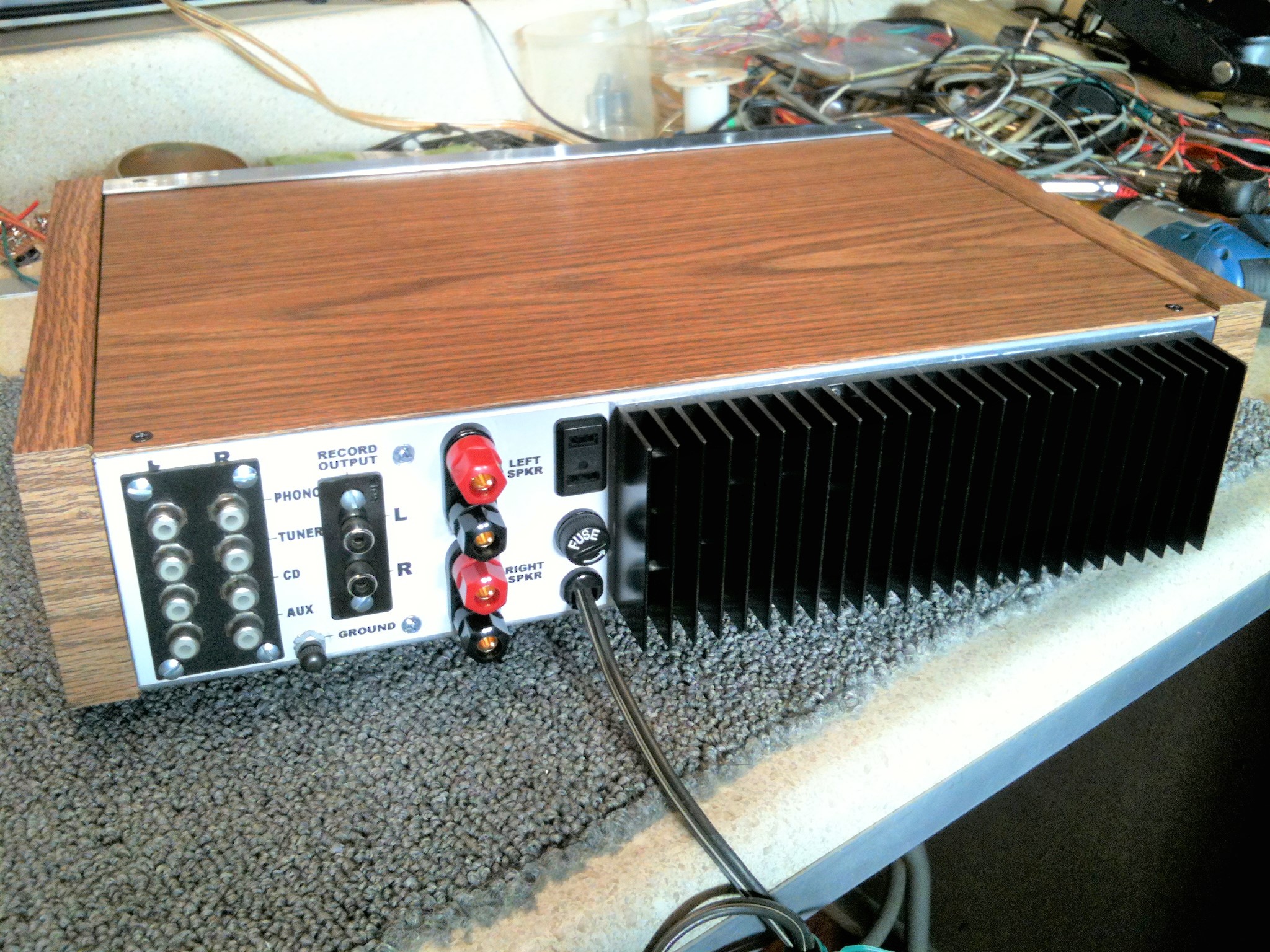

Here is an amp I did last year, the fins are 2.5" high on a 3" rear panel.
For a piece of the 10 inch material they told me the fin height is 96 inches, 8 feet. Their stock comes in 8 foot lengths from the aluminum extruder supplier. So when they cut off a 2 inch long piece for me, the fin height is 2 inches, the width of the stock is a fixed 10 inches. So a 2 inch piece gives you a row of vertical fins 2 inches high, spread out 10 inches by whatever the fin interval is, I think about 8mm or so. They also have 8 inch stock. I'm not sure if this answers your question. 🙂
I'm still a bit confused.
Look at the rear view amp I posted.
See the vertical dimension is 2.5 inches high, and it's 6 inches long.
The 2.5 inch dimension of mine, is what I'm talking about.
It's not clearly described on that website's charts.
I understand the lengths, and the fin extension from the plate, just not how wide the fins are.

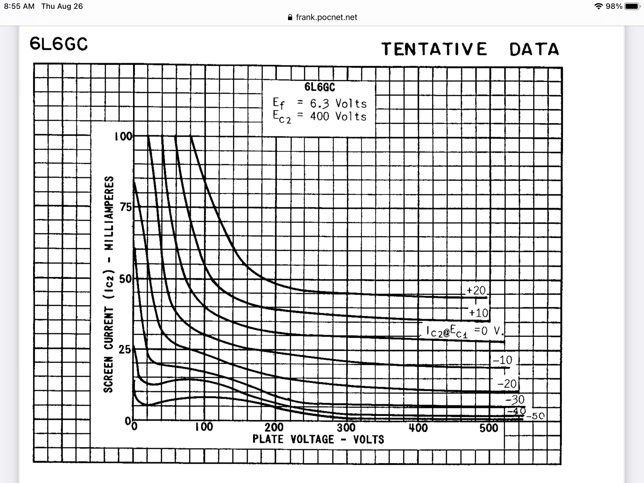

Keep in mind the PEAK screen currents which can be present - and can (on a cycle by cycle basis at clipping) go way up beyond 20 mA per tube. It has been known to cause mosfet regulators to fail unexpectedly. The heat sink heats up based on the average power. The transistor needs to be able to take the peak current, at the VDS voltage, at the temperature the heat sink gets to. This is a good reason to keep the temperature LOW, even if simple math based on average dissipation would let you get away with 125C case temp. Short duration 100 mA peaks per valve are not uncommon. At 100 volts that’s 10 watts (each), 20 per pair. Modern mosfets sometimes have trouble with 20 watts at 100 volts, and it only gets worse with temperature.
Sure, so to repeat your heatsink there... You'd just tell them to cut off 2.5 inches of their 6 inch wide stock material. Then you'll have a piece with 2.5 inch high fins in an array that is 6 inches long. Remember their stock is extruded 8 feet long by a fixed width, in your case that is 6 inches. So the only "variable" in any of this is the fin length when you make the cut.
Got it!
Thanks. 🙂
Thank you! I agree with everything you said. I'm thinking about using the regulator for screen grids and input stages only. The input stage will have a very low peak current. The screen grids are a different beast, and I was giving a 20mA peak per pair, based on 6L6GC in AB1, datasheets show a range of 11 to 22 mA (both tubes) depending on the configuration.
That’s an average. Peaks can go well north of 50 mA even in AB1 and if you want low distortion you have to allow that. It does only peak like that on one side of the push pull at a time, but then you add quiescent to get total. Your regulator needs to tolerate that without misbehavior. I usually plan for 100-150 mA per valve pair with audio tubes (less with sweeps because the screens draw less). Above that you can let it drop out of regulation to protect the hexfet but you don’t want that happening with a valid audio signal and proper load.

Thank you! I'm really surprised with the high screen currents, based on those curves, yes, they can be quite high. But the average current is still relatively low, and the power dissipation, as far as I understand (I may be wrong!), is about the average current. The MOSFET, of course, needs to be able to handle short high current peaks, but the one I'm planning to use can handle 1.5A continuous at 100deg, and 9A peaks, so it should be OK.
My first try will be without voltage regulator anyway, I will try several options, like UL taps, or unregulated voltage, and will take it from there.
