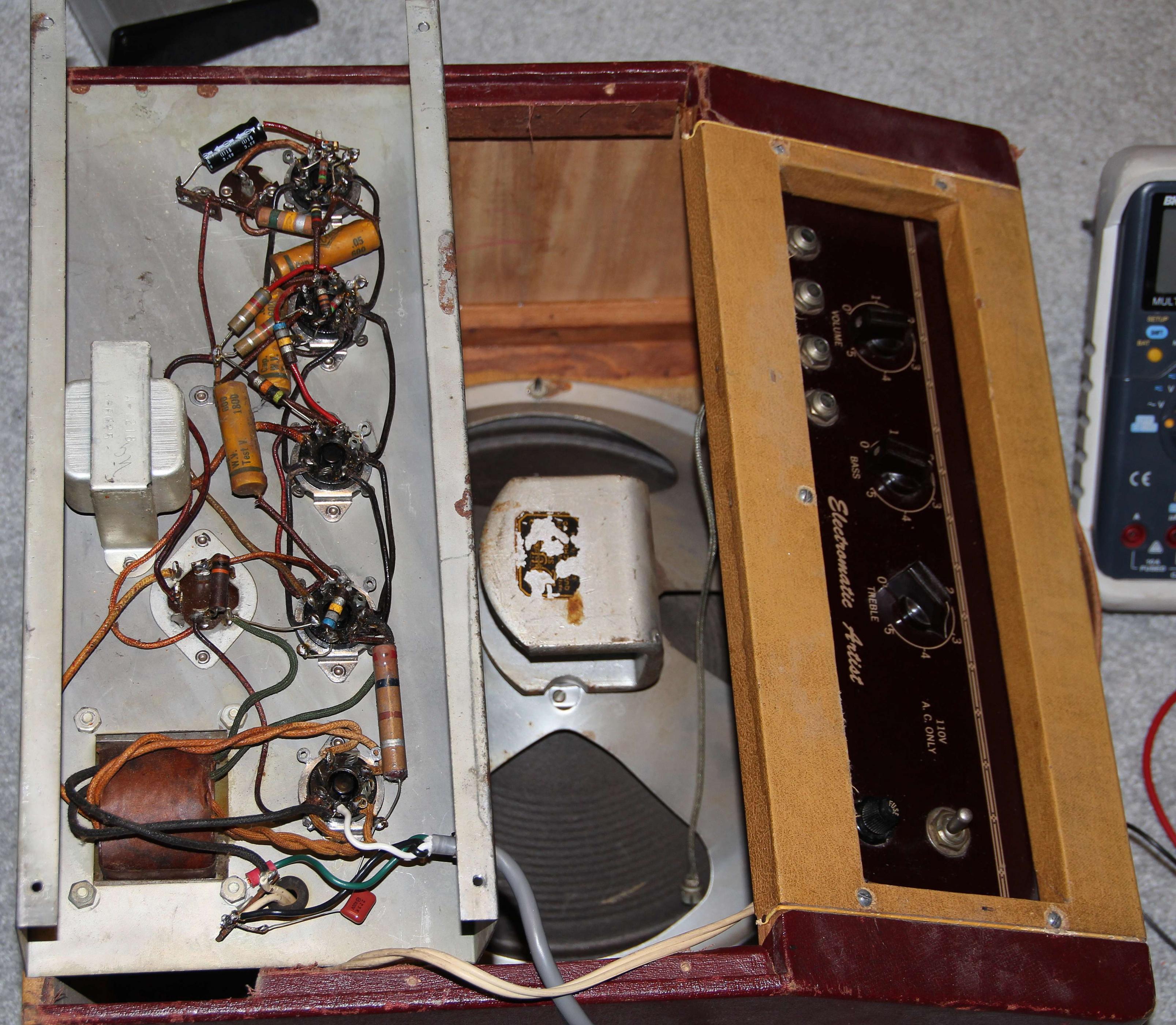

Here is a picture of a little Gretsch amp I have. It has the filament circuit grounded on one side and everything else is grounded all over the chassis and it's pretty darn quite. And I even put a three prong plug in it with ground to the chassis. So something is wired wrong.
Just list the pins on the input tube and what is attached to them as far as resistors and voltages.
I just took some alligator leads and connected the earth grounded chassis, the ground bus, and the signal grounds, and the hum went away and everything works as it should. I think I'll just keep doing it that way.

My bus wire had HV center tap, filter cap negative and any part of the circuit that was negative with respect to b plus. The chassis was third prong earthed. The metal backs and the sleeve of the input jacks were tied together and hooked to the bus as well. I found 120 ac on the sleeve of my output jack so I connected everything to the steel chassis. Hv center tap, cathodes, sleeves, filter cap negative, and. The body of my pots. No more deafening hum, works as expected.
OK, you must have omitted a ground connection somewhere. Now it is all grounded, although perhaps not optimally. Connecting everything to the chassis puts you back to 1950s grounding practices, so you will get 1950s hum.
Undoubtedly so DF. I don't know, what I missed. I really had high hopes for this build and wanted to make it quiet; but the truth is I'm a solder slinger. As much as I would like to, I don't build beautiful instruments to soothe man and beast. I build monstrosities of iron to bludgeon the masses with.
