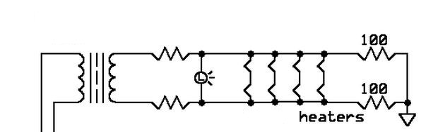

A heater supply must have a DC reference voltage, which in many cases may be ground. Nothing inside a valve envelope should be left floating.Frankly I would not earth one side of the heater supply.

you only need the last two. anything from 47R to 150R - make them 1W.

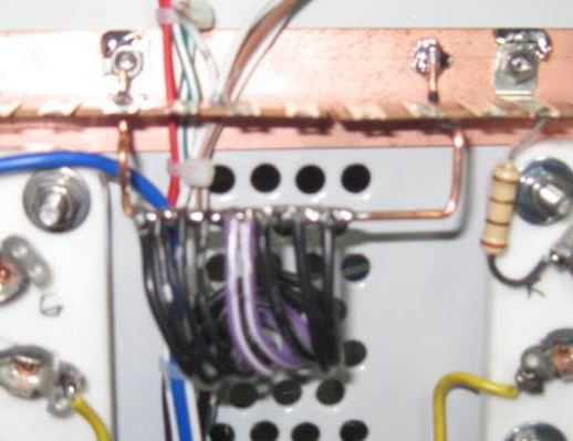

this is how I set my buss up. I stripped the insulation off of a length of 12 gauge copper wire and left the insulation on the ends which formed into loops and secured it with nuts and bolts. The hv center tap, and all other circuit grounds go here I earth grounded the chassis to the third prong.
well your picture is not showing, but no matter.An externally hosted image should be here but it was not working when we last tested it.this is how I set my buss up. I stripped the insulation off of a length of 12 gauge copper wire and left the insulation on the ends which formed into loops and secured it with nuts and bolts. The hv center tap, and all other circuit grounds go here I earth grounded the chassis to the third prong.
If I read your explanation correctly you hooked up your chassis to your mains supply earth, but kept your signal ground away from it, right?
That should be OK, so you lifted your ground, why? do you get more hum otherwise?
Also from a safety point of view, since this is a guitar amp, have you considered what happens if you get a live short to your signal ground? yep, it will travel to your pickups and YOU!
If you got ground loop problems, at least connect a 10R/2W between your signal ground and chassis - for safety.
Yes, that neatly combines a ground bus and a ground loop all in one simple piece of wire.KenTajalli said:My idea of star (err sorry BUS) ground.
A 2W resistor won't last very long if there is a short. It may give the illusion of safety until something nasty happens. You need something which can survive a fault current longer than the mains fuse or breaker.If you got ground loop problems, at least connect a 10R/2W between your signal ground and chassis - for safety.
Ok use a 10W - my home circuit trips instantly, but I suppose in older systems with a wire fuse, you would be correct.A 2W resistor won't last very long if there is a short. It may give the illusion of safety until something nasty happens. You need something which can survive a fault current longer than the mains fuse or breaker.
