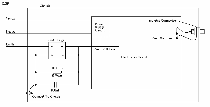

So, I have a question or two about the way that the filaments are connected in this schematic. It is very strange to me, I have never seen it depicted that way before.![]()
I have, but this is usually an RF technique. It spells hum problems for an audio frequency circuit. Grounding one side of the heater directly to a chassis ground serves to "short out" any RF that escaped across the stray capacitance between the heater and the cathode sleeve. Not a factor at audio frequencies.
For an audio amp, there is no need for a Lo-Z ground return, so the heaters are best connected to the heater secondary by two wires twisted together to reduce4 magnetic coupling.
Can I just put the filaments in parallel and hook it all to the filament supply like I usually see it done? If I put the center tap of my HV, one side of my filament supply, the power supply filter caps, and all the signal grounds in a star ground kind of configuration won't that cause a lot of hum? Also, the capacitor on the AC mains side, isn't that going to make a ground loop? If I am totally wrong on all counts, how should I separate all of the grounds?
A star type ground, or a semi-star, will help reduce hum greatly. You want the circulating currents from filter capacitor re-charge out of any commons. Even through a low resistance connection across a chassis that doubles as a ground plane can give enough voltage to be amplified as though it were a signal to make for clearly audible hum. Same applies for heater current that returns via a ground plane. That's not a consideration for RF circuits since any mains hum will be filtered off by LC tuners and/or BPFs. Having a Lo-Z return is the greater consideration in RF design.
You also don't want the AC mains connection shown here. The AC mains bypass capacitor is on the wrong side of the line (will make chassis somewhat hot even if switched off) poses a serious shock hazard if it fails short, and defeats the purpose of the PTX: removes isolation from the AC mains.
You're much better off using a three wire connection to the AC mains. You can include a ground loop breaker (attached) to help with hum reduction, and the chassis directly to ground will ensire that all metal will stay at ground potential even if there's a fault somewhere that would elevate the chassis above ground. Back in "the day" it wasn't done since three wire sockets weren't available. That AC mains bypass served as a hum reducer if the plug was in right. These days, that's neither necessary nor desirable.
Ok, I am confused. if I put all the filaments in parallel, use the center tap and filter cap negative for voltage ground all going to one point that is isolated from the chassis, and put the third prong to the chassis, where do I ground my audio so that it doesnt get the cap recharge noise? Also how would I isolate my potentiometers and other audio components from the chassis and still have a complete circuit?
Are you doing a new build or fixing an old amp? The schematic shows the filaments in Parallel, just using grounding to the chassis instead of a separate return wire

I am sorry that I didn't make this clearer. I am building this amp, right now it is a pile of parts and a drawing. So what I think I need to do is this. Put the earth ground from the three prong plug to the chassis. Put the center tap of my HV, and my filter caps to the chassis, and make an isolated star ground for all my signal grounds.
Yes.stridor said:Put the earth ground from the three prong plug to the chassis.
No. Putting CT and filter caps negative to chassis is what people used to do 60 years ago and it is why old equipment always hums.Put the center tap of my HV, and my filter caps to the chassis, and make an isolated star ground for all my signal grounds.
The power CT should go to the filter cap negative, then wire from there to the audio ground. Personally I would use a ground bus, not a star, but each to their own! At some point you can add a connection from the audio ground to the chassis.
Had I not seen that kooky way of hooking up the filaments I was going to ground it this way. HV center tap, filter cap negative, and every ground that is depicted here except those crazy filaments to the chassis, and use a two prong plug. This is the way I have always built amps because I have been cloning amps from the 30's and 40's, and hey it's rock n roll, expect a little hum. It hasn't been anything major, and certainly nothing that I couldn't drown out with humbucker pickups. Now that I have been told there is a better way, well I am open to try it, I just don't understand is all. If put my filter cap negative, and HV center tap together, and third prong earth ground to chassis where do I ground points 21, 22, 23, 14, 17, 28, 25 and so on on the above schematic without getting the cap recharge noise someone was mentioning? I have to have someplace to take potential difference from and it can't be the chassis either since that apparently creates the hum, so where is this point?
Well, if I'm doing a scratch build, I use a star/bus ground combo. Power transformer center tap to negative side of first two filter caps. That creates the first "star" ground. Then extend a wire to some other convenient point in the amp (the wire becomes the bus). This end of the bus becomes the star ground collection point for the audio circuit grounds.
Filter caps down stream of the first two are connected to ground along the bus, near the power supply end. Filament supply reference to ground is connected to the bus in there somewhere also--find the lowest noise location. Connect a wire from the star/bus ground to the chassis at one single point. Experiment to find the lowest noise location, probably near the input tube. Thus ALL grounds are essentially connected together, it's just a matter of connecting them in such a way that loop currents flow locally, not globally across the entire bus.

Frankly I would not earth one side of the heater supply.
I suggest you build it, without earthing the heater supply, use twisted wire from one tube to next to form a ring (from transformer to each tube, back to the transformer), and see if you have any induced hum from heaters. Test should be simple, run the amp, if there is any hum, just disconnect the heater supply, if hum immediately goes away, it is the heater supply!
Next step is to use two resistors, say 1W 47R connect then in series between heater supply rails and earth the middle.
Again, you may not have to, first build and see.
Well, I got done with this build, and I must say that I am thoroughly dissatisfied. When I was ignorant and connected each and every single ground to the most convenient place I could put a dollop of solder on the steel chassis I got better results than this meticulously planned pile of crap I have built. The hum is so bad there isn't any audio. It's like I connected a dc power supply, and a poorly filtered one at that, to a speaker. Obviously I have some issues to sort out. I will take some measurements and let you guys know the results.
