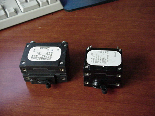

Re: If you require a switch...
Be aware though that this switch is single pole and only switches the hot wire. If you're OK with that, it's a great deal, but it's safer to use a double pole switch to switch both the hot and neutral.
Re: Re: If you require a switch...
What is wrong with only switching the hot wire? I have seen a lot of schematics that only use a single pole switch. Will this cause complications?

It is good practise to use a double pole switch in all mains applications, as it ensures the item is safe, even if phase and neutral are reversed, (quite common in domestic wiring or in countries where plugs are reversable).

If this is the case, wouldn't it also be a good practice to fuse both primary ac wires as well?

I wouldn't discard the idea of "cool little AC inlet" switch yet. There are always people who are paranoid about safety, and electrical power in general.
If you check the Aleph schematics, you will notice that they all use single fuse and one pole switch on mains, only😉

It is not that much about safety, as it's about common sense.
An amplifier is a device built to be connected to the mains. If you feel that one pole switch is not good enough, don't use a switch at all, and remove the power cord from a socket (to be completely safe) when disconnecting the amp.
That's the approach that I have chosen in my chassis design.

All of the light switches in my house are single pole, my table saw is single pole, my switch on the refrigerator for the internal light is single pole, my corded drills, jig saw and compound miter saw are single poled.
My 220 Volt AC electric stove has single pole switches for the burners. The power switch on my 220v dryer is single poled.
If installed correctly, single pole switches are COMPLETELY safe.
The ONLY time your fingers should be in the chassis with power present is when you’re troubleshooting. At which time you should be HIGHLY alert where you put your fingers any way!

Thanks, you've helped bring reality back to the discussion. All of these devices are potentially just as deadly as an amplifier, so if they're safe, then I'm ok with a single pole ac mains.
So, Apex Jr. will be hearing from me soon.
