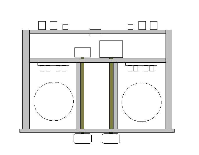

I have a sort of idea, how the chassis could be done, will try to make a prototype today.

Here's proposed layout. The main frame is H shaped, with front and rear panels attached to it. Volume pot and switch have shaft extenders. Rectifiers board is mounted in the same compartment as transformer, vertically. Amp boards are on the opposite side. RCA inputs are in the center part of rear panel and binding posts are on the outside. Initially, I wanted to place amp boards on side panels, but the physical distance was to large and the wiring would be a mess. Another option would be placing cross bar (from center plate to rear panel) and mounting both chips to that. This would allow for true dual mono configuration, the only problem is running wires from inputs to selector switch. Both pots, switch and transformer will allow a lot of substitutions as there will be enough space. I added wood panels on the sides, as I needed something here to fill that useless space created by the knobs being reasonably spaced off the sides. This will also reduce the size of top panel, wiich usually introduces most resonances. One reason for that was also adding the inside cross panel. It provides sort of shileding from transformer, allows mounting of pot and switch, but what's most important, it also prevents top panel from excessive resonances. It might be interesting to use a perforated aluminum for that purpose, but it's mostly up to you, as a slotted, 1/8" top cover can be also made at reasonable cost.
All comments and suggestions are welcome.

Some thougts:
I have seen the AC inlets placed right next to the trafo on the bottom side of the box, (this would ofcourse need a 90degree IEC plug to work) and its not very versatile but i think its a cool arrangement 🙂
If it where possible to place the selector and pot behind the GC boards they could be placed closer together making wiring simpler (and shorter) and the box thinner but there are ofcourse some drawbacks with that arrangement.
With woodensides there will probobly be lots of request for different woods. maybe best to leave that part to the builder?

While two transformers are nice, it makes the chassis much bigger and I would rather go for really true mono in this case: monoblocks. As long as there is a shared switcher for both channels, the wiring won't be simplified that much either.
I also like the attachment of the AC entry module on the bottom, but this requires 1" height on the feet. With a small chassis it may not look good.
I also want to make it smaller than the usual full size chassis. It's a GC, right?😉

Here's the prototype in progress. The size is 9 x 10 (with wooden panels on). I also managed to find a place for AC socket (if mounted on 0.5 standoffs the feet don't have to be that tall). The rectifier board should be on an opposite side. I tried to make the size as compact as possible, yet allow few different transformers type (Plitron 400 VA will fit too) as well that big Taiwanese volume switch. I will make front panel this time out of 1/4 aluminum, but thicker stock is possible as well. Top and bottom will be 0.2 aluminum.
The only way I can see mounting the chips (in such compact layout) is by using that center bar and the chips would be mounted face to face (the bar is 1/2" thick) . I attached another plate on the bottom to mount the board itself and there is about 0.2 clearance between bottom and top covers to run the wires.
Now, if someone doesn't want to go into source switching, this allows pretty much dual mono configuaration (except for PS).
