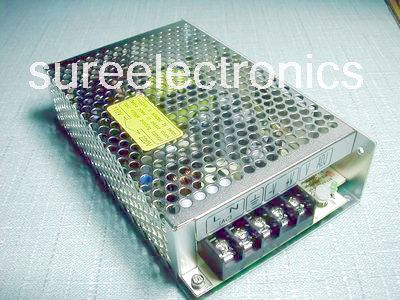

Does anyone have any experience of the quality of these?
"12V DC 4.2 Amp Regulated Switching Power Supply NEW".
They are available on ebay from china and are a good price.
Are they any good for Charlize?
