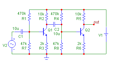

Well, I have learnt a lot here about feedback. To clarify, I have prepared the circuit (attached, working, I can encourage purists to build it). This circuit is built from two identical stages. Every of the stages has a gain of 5 (R2/R3 and R5/R6). Considered as single stages, they are feedback circuits. The feeback is constituted by R3 and/or R6. The gain of the stages depends only on resistor values when standard BJT device with h21e=300 or so used. But the amplifier as shown, created by cascaded connection of the two feedback stages is non-feedback or zero feedback. Great. I am finishing with this kind of discussion.
Regarding that ultrafast no-delay transistor, this is a complete nonsense. As an example, emitter follower is happily oscillating circuit under some circumstances. Should there be no feedback it would hardly oscillate.
