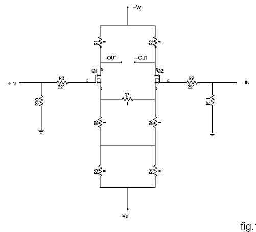

ps. Can you attach example of non feedback with single differential?
lumanauw said:ps. Can you attach example of non feedback with single differential?
Son of Zen
R7 is a source coupling resitor of the differential MOSFET pair. Regarding its value, R1 and R2 values and the gm of MOSFETs the voltage gain is estimated. The higher the R7, the lower the gain and distortion. R7 creates voltage feedback in the same way as for single transistor it is created by emitter resistor.
Since any device's limited transconductance is the same
as Source resistance, you are saying that there is no such
thing as non feedback. I disagree, for reasons previously
outlined.

Nelson Pass said:Since any device's limited transconductance is the same
outlined.
Maybe not exactly. There is always intrinsic Ree etc. that creates feedback.

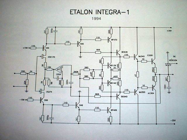

Does anyone have more complex example, like 3 stages with non feedback? I wanted to see how DC can be controlled with only single differential.
Charles, this is ETALON. What do you think of this? I have difficulties in calculating bias in first and second stage. How can I calculate bias with such a "self-biasing" stacking Fet pairs?
lumanauw said:How can I calculate bias with such a "self-biasing" stacking Fet pairs?
The exact bias will vary depending on the Idss of each FET in the pair. However, it is easy to make a rough estimate, which is all that is needed. Download the data sheet from the Toshiba Japan website. Then look at the curves of Vgs versus Id. Draw a load line of 36 ohms starting from the origin of 0,0 up with a slope of 36 volts per amp.
There will be several curves. Assuming you are using the BL devices, the Idss will be around 8 mA, so use that curve. Where the load line intersects the curve is the operating point.
Charles Hansen said:I disagree that R7 introduces any feedback. Please explain your reasoning.
It reduces voltage across the transistor according to changes of the output voltage. Just voltage feedback - reducing gain and distortion. Same principle as for opamps, only the opamp triangle symbol is not apparent.
