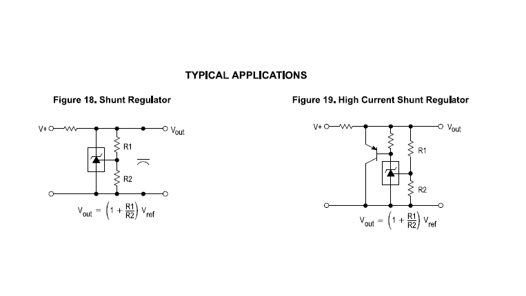

In practice either of these shunt circuitries are adjusted to start drawing current when the voltage across the batteries to be protected reaches a voltage level defined by R1/R2 (can be a suitable value trimpot with center out). For SLA's a good standby voltage would be 13.5 VDC for a 12 VDC battery - and a maximum set to 13.8 VDC. The top left corner resistor could be e.g. 0.1 - 1 ohms again depending on shunt current draw (in a preamp case it likely would be less than 100 mAs if all batteries are equally new).
If you'd like to prevent the batteries from over-discharging - e.g. because you forgot to switch on the charge circuitry again - a 555 timer circuitry controling e.g. a power relay can be used to switch the charger back on after maybe 2-4 hours.
If you disconnect the charger while listening an LM317T in many cases is adequate to charge the batteries.

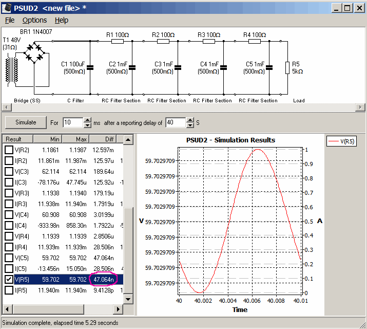

Do you even have an idea how much ripple is acceptable? (Remember the preamp's designer also thought about this-- not commercially profitable to design a preamp which needs a power supply more expensive than the audio-bits.)
Just with junk-box parts, I could get sub-microvolt ripple from raw AC. Yes, it looks like a fine sine wave but this is an extreme blow-up. (One advantage of multiple R-C is that the higher more-audible harmonics go WAY down.)
i guess it would be more than enough for me really ... there will be the PSRR of the amplification circuit (know nothing about it anyway)
But your result is really excellent
Thanks ! very very nice. Which SW have you used ? i love the output. I would like to buy one copy. Is it expensive ?
I guess this solves completely my problem ... ok i can add a high voltage TL783 regulator at the beginnig ... but this is really impressive.

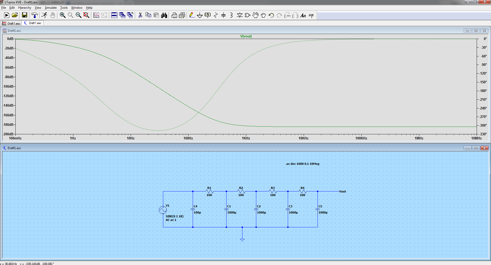

Regarding using a battery or not I might suggest a simulation software called LTSpice. It is free for download and there's a thread here on diyaudio dealing with getting from "beginner" to "advanced". Although one still has to have a good electronics knowledge in my experience it has helped clarify many questions I have had in relation to electronics and various circuitries. The thread is here:

FYI I have simulated the circuitry you posted above with respect to its frequency characteristics (in LTspice) - it is attached.

> what is this ?
Google is your friend.
Hi ! yes 😉 i guess is PSU Designer II ? 🙄
i read "to help you with the design of simple linear (unregulated) mains power supplies"
i think it is very interesting for filters ... but usually for preamp i see regulated power supplies ... actually i think to use some bjt/darlington to smooth the voltage before the filters.
