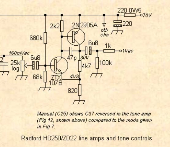

The stage you show takes 6mA. Not hundreds.
Yes ! i was just staying ample ... very conservative 😱 if i will adopt 70V the trasformer could be quite small ...

... You mention a 4-stage R-C filter ... i will look for schematic and calculator...
Do you even have an idea how much ripple is acceptable? (Remember the preamp's designer also thought about this-- not commercially profitable to design a preamp which needs a power supply more expensive than the audio-bits.)
Just with junk-box parts, I could get sub-microvolt ripple from raw AC. Yes, it looks like a fine sine wave but this is an extreme blow-up. (One advantage of multiple R-C is that the higher more-audible harmonics go WAY down.)
Hi ! no idea at all. It is for a line preamp. Actually two ... one will be based on the Nelson Pass design Bride of Zen ... the other one will be taken by an old schematic from 70s ...
Both will use around 60V supply ...
i guess it would be more than enough for me really ... there will be the PSRR of the amplification circuit (know nothing about it anyway)
But your result is really excellent
Thanks ! very very nice. Which SW have you used ? i love the output. I would like to buy one copy. Is it expensive ?
I guess this solves completely my problem ... ok i can add a high voltage TL783 regulator at the beginnig ... but this is really impressive.
The circuit will be class A so current draw (no more than 100mA) will be constant.
