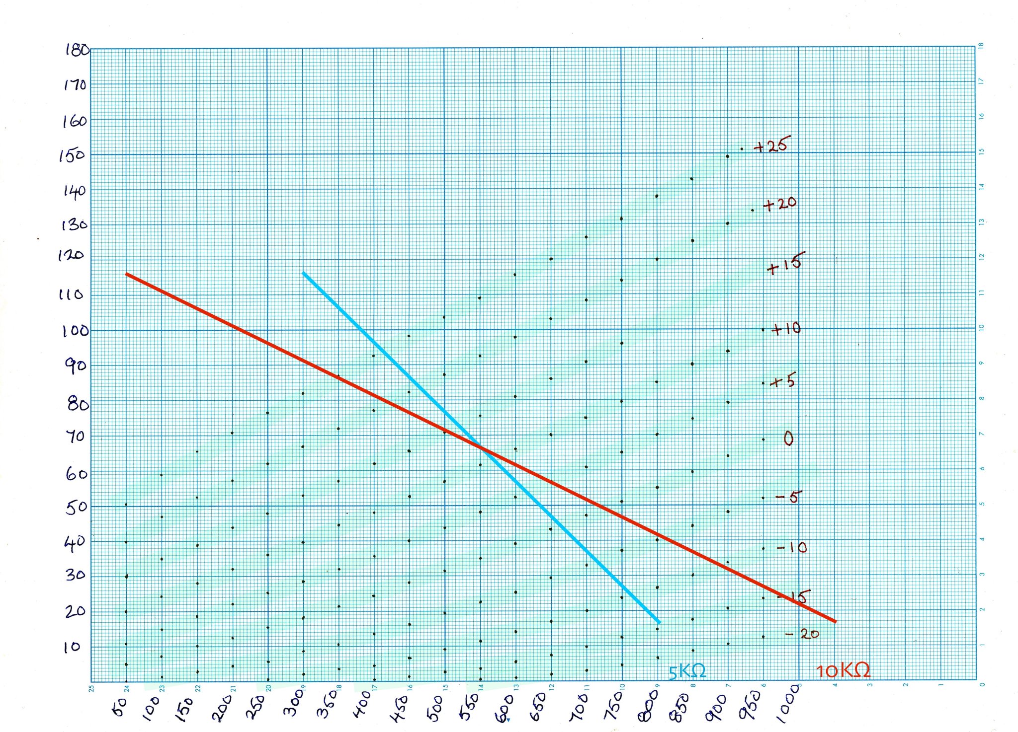

Neither .would you test then with an output transformer, like a real SE circuit? or just best keep it simple, using a resistor as a load?
For a tube with unknown DC operating curves.

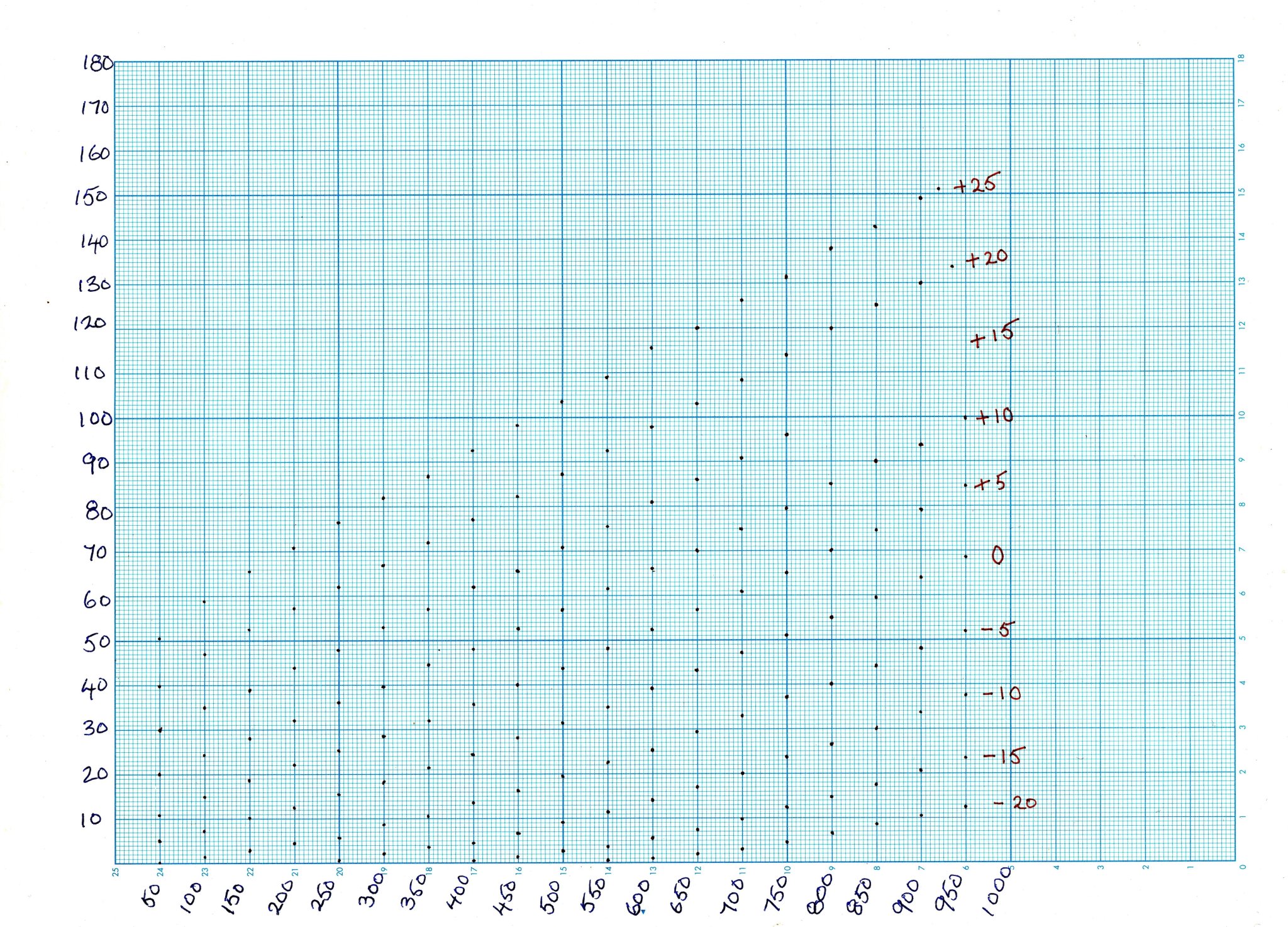

With variable voltage supply for the grid(s) and using a simple variac controlled B+ power supply, test with no plate load .
Current measurement resistors in series with relevant electrodes, run the tube through the voltage range of interest , and plot V / I points on graph paper .
Once the physical set-up is ready to go, the left hand goes in pocket and the only thing I touch with the right hand is the variac knob and the pen to mark the point on the paper. Then B+ to zero, shut it down, change the grid voltage , power up and sweep the next set of of points.
Connect the dots after to show the curves.
The curves get used to decide on the load impedance for the circuit I intend to build.

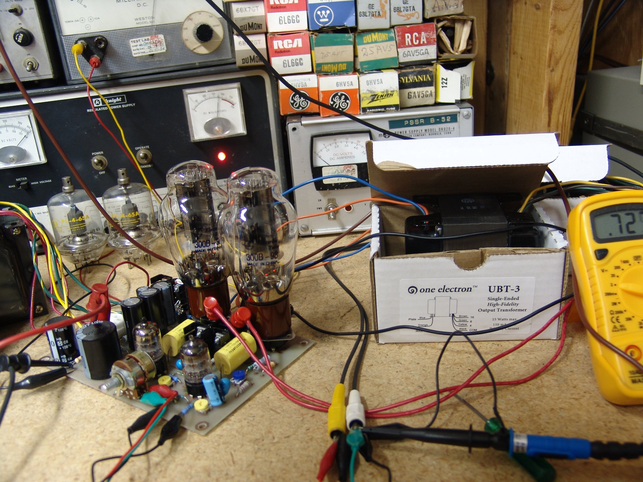

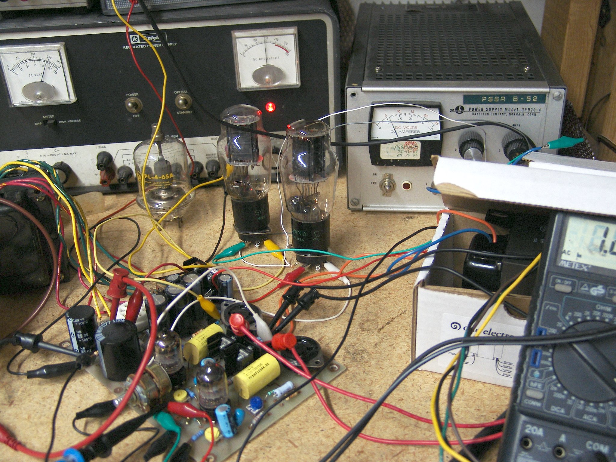

If someone wants to make a test jig to characterize tubes, good for him, I have built several. Sometimes it's just a hacked up version of one of my amp boards.
Here a Tubelab SSE board gets used to "characterize" a box full of 6LU8 and 6LR8 TV tubes. This led to the SPUD board which never made it into production for reasons beyond my control.
Also, a board that would eventually become the original TSE with 300B tubes got to test a bunch of different TV tubes.
