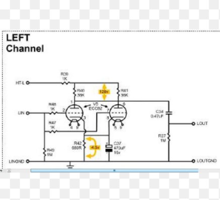

changing the value of coupling capacitor
Hello!
thank you for your answer. the only reason to change is that I have a pair
of Mundorf Silver Oil 0,56 for test here!
Maybe i let it better by 0,47uf!
Best regards!
You can certainly test this very nice cap in this very poor line stage.
It can only drive high input impedance power amps with either valve or fet inputs and offers no real advantage to a passive preamp. For most applications gain is also excessive.

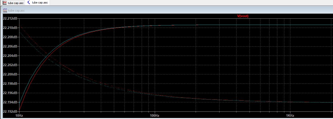

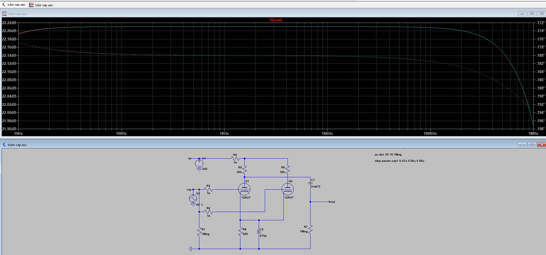

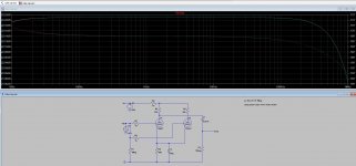

Just for interest, I threw a schematic together in LTspice and ran an AC sweep (hopefully correct). I used the .step command to see the effect of the two stated values.
attachment.php
As expected, there is little difference except right at the very bottom end:
(Close up of the audio range)
attachment.php

Coolio… 2 things:
Note a subtle mistake … not connecting the pair of 12AU7 triodes anodes together. Per the original schematic on page 1.
Second, note on the right hand vertical scale legend (in the “closeup”), that the difference at 10 Hz is only 0.04 dB. Not something humans can hear. The most golden ears, with even paced music playback (i.e. not sine waves) can't tell the difference of even 1 dB, let along 0.04 of them.
ratio = 10dB/20
ratio = 100.04 ÷ 20
ratio = 1.0046​
So, about ½% difference. At 10 Hz. Which we don't hear anyway.
Thank you tho' for the sim.
I appreciate simming: tho' it makes it easy to see response curves, I am always a wee bit suspicious of the internal accuracy of the valve-model used in simulation. Real life results tend to differ.
Just saying,
GoatGuy ✓

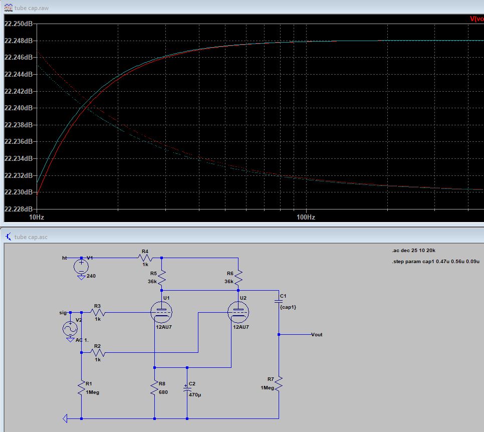

Coolio… 2 things:
Whoops.. good spot, I missed the join when I ran the wires.
Not much change:
attachment.php
ratio = 10dB/20
ratio = 100.04 ÷ 20
ratio = 1.0046​
Thanks for the Math! It helps my understanding when I see worked examples like that.

avtech₂₃;5906109 said:
Whoops.. good spot, I missed the join ... Thanks for the Math! It helps my understanding when I see worked examples like that.
You are welcome, fellow DIYer. Note that even I, the goatish math guy, made a mistake too. It wasn't –0.04 dB at 10 Hz, but –0.003 dB. Even less to worry about in the wee hours of the morning. Nice work. GoatGuy ✓
