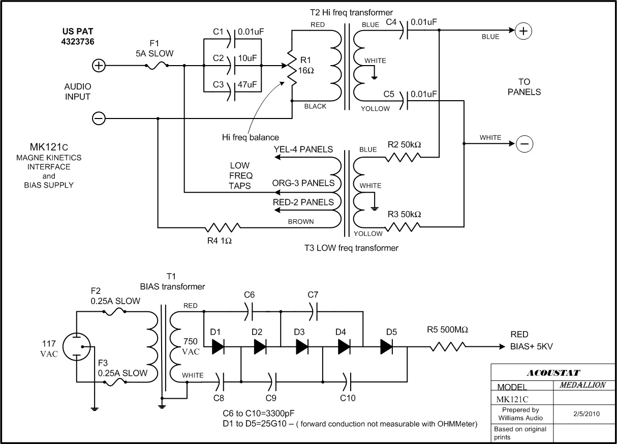

I have a pair of Acoustat 3
1- I want to lower it by 35 cm from the wood lower base, wife factor is a very difficult issue, is a problematic change could affect the sound dramatically?
2- I want to make it easier for the power amp that drive it; the dc resistance is around
1-2 ohms, the ac impedance is nominal 4 ohms but with severe changes,
so by disconnecting the hi and low branches at the xover input and drive each branch with a separate pwr amp it will reflect a higher impedance for the amps,
So it will be much easier to drive it, I think so.
Best regards,
Williams
hi wayne,
take a look and figure out your self
williams
