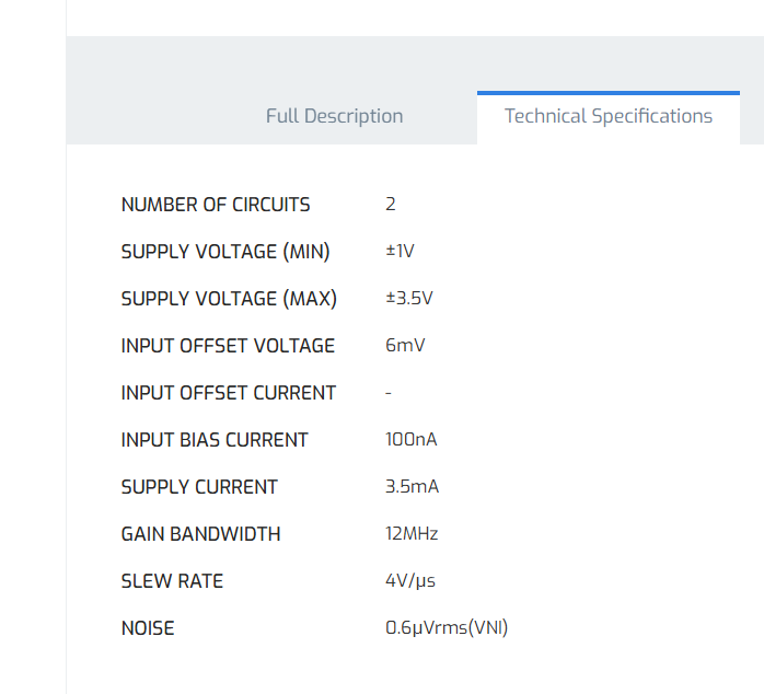

Wouldn't the NE5532 (my favorite do it all opamp) need a little more voltage?

@Turbowatch2 As long as the load isn't too hard, any of the NE5532 are just fine with +/- 5 VDC. The 22 pf cap in the NFB loop is important for unity or low gain circuits, as is some small ceramics on pins 4 and 8 to ground.

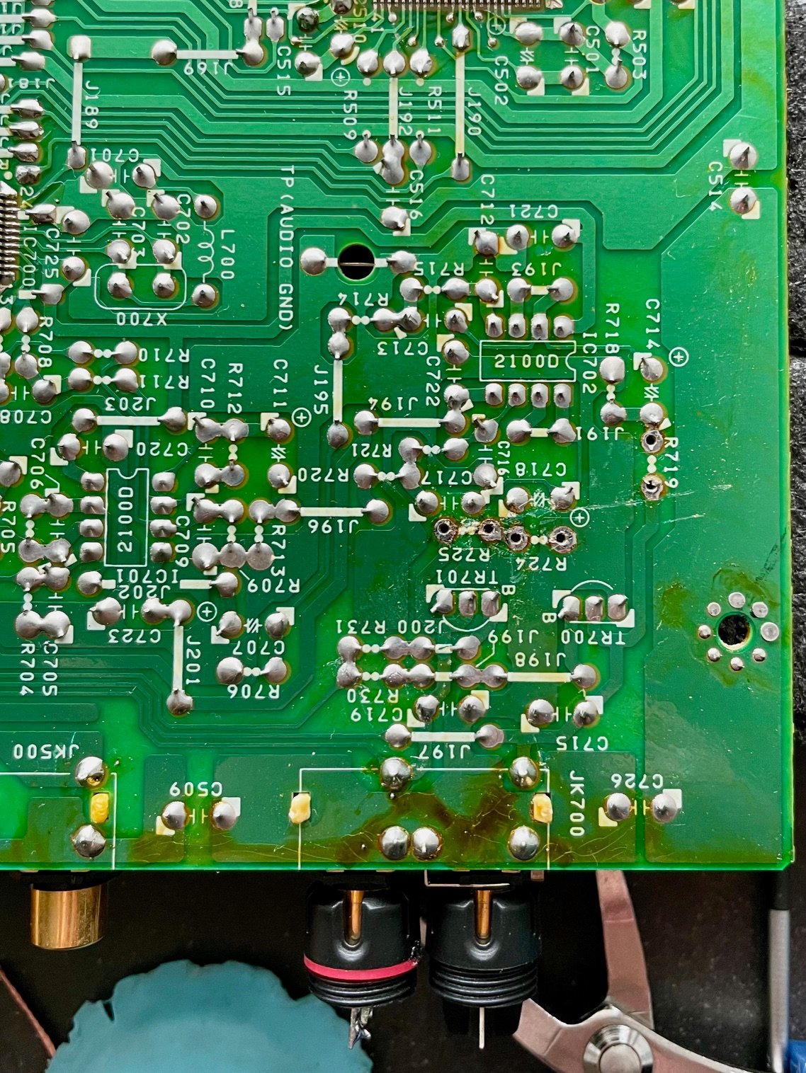

I go with the capacitor / resistor swap first. But I will look all the tips you all give me.
I first tought there was one op-amp pr canal. But L / R signal comes from same op-amp and then go to RCA. A 4.7uF cap and 220 ohm resistor in series with signal. And 3800pF couplingscap.
Here are the partlist.

As we don't have a shematic for this player, most are some ideas that could work, but not percise instructions. If one had the object on the table, there could be other options, depending on voltage measurements for example.
If you are right about a single opamp driving the output, what is the second one for? Just seen from the pictures, there are two identical set's of parts around the two opamps. Also both opamps have an identical pencil mark. So maybe check again?
Turbowatch2: The path goes from pin 7 ( output ) on Op Amp ( IC701) ) to pin 5 ( + input ) on Op Amp ( IC702 ) then out on pin 7 to RCA right canal.
The adder goes from pin 1 ( output ) on Op Amp ( IC701 ) to pin 3 ( + input ) on Op Amp ( IC702 ) then out on pin 1 to RCA left canal.
So they then are in series I think. The pin 5 + input on ( IC701 ) come from IC200 ( HD404729S ).
The pin 3 + input on ( IC701 ) comes from IC700 ( 5876 ).
Hi again, now the parts are in place. The board is back in the player. I power it up and put in a cd, the drawer goes in.
The cd starts to spin ( clockwise seen from the label side of cd, not readingside ), it spinns for 2-3 sec. And at the same time the laser trying to go to center of cd, hitting the end stop ( I can see it move into center and it make a rattling noise, think maybe the tiny plastic driving wheels also jumping some teeth ). But I see the mecanism of the tooth rack driven by the driving wheel has a spring effect, so I think it is a security if motor just pushing on it skip insted of damage anything. So after the 2-3 sec it stops and start spinning backwards for a 2-4 sec then stop. The laser look maybe week but I can be wrong. I have also 5 times check the pcb for right value, direction of electrolytics and solder joints. Damn, now I have done it 😱

Hmmm... so you have gone from a working player to a zonked one following the recap 🙁
You need to recheck all your work and look for things like tiny solder splashes that might be shorting traces or leads. I'm afraid we do see this a lot following recaps and the like. No easy answer I'm afraid and without circuit diagrams it all becomes a whole lot more difficult. Recheck everything for a start.
