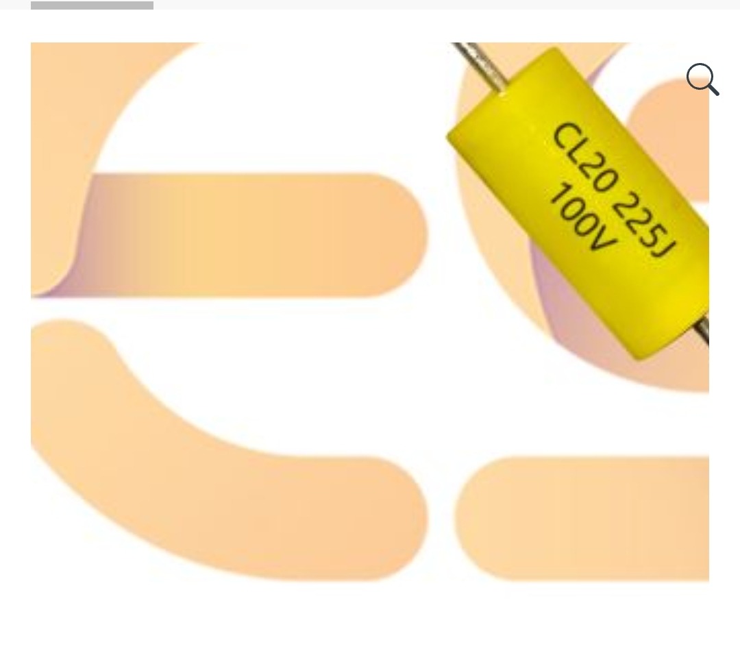

Change in ohms of bookshelf speakers
Just curious, are you measuring speakers while still connected to amp output?
Because Multimeters do not actually measure ohms but a small voltage 😱
Offset voltage will be read and displayed as if it were a given ohms value.
20 to 40 "ohms" value sounds suspiciously similar to 20 to 40 mV offset, very common values.
No first i disconnect it from amplifier then measure it
Moreover if I was doing something wrong the other speakers ohms too should fluctuate but only this one goes 20-30ohms other stays always 6ohms

the resistor might still have a purpose. When one leg of the resistor is connected to the capacitor and the other leg is connected to the tweeter, and a wire is bridging both legs, it might form a specific impedance network or alter the crossover slope, affecting the frequency response of the tweeter. This configuration could be part of a particular crossover design to fine-tune the audio frequencies sent to the tweeter
But "@Galu" it's bilge
So again in confusion regarding the purpose of resistor in my circuit
so resistor is just thrown in by manufacturer and bridge
And has no effect on audio it's 0 ohms
So now why does my ohms change
I don't think capasitor might be a culprit, resistor doesn't have anything in circuit.
What else is the issue?
Both when measured shows 6ohms
But one of the speakers suddenly shoes 20-40 ohms

What you describe is quite likely to be something as simple as a poor interface between test meter, the leads and the speaker. It is a common scenario.

And any how I will close the speaker now using glue for more rigidity or else it will keep on vibratin
Now should I replace that capasitor which film 2.2uf 100v
Or just keep the old one
What do you suggest?

Or residual charge, voice coil magnetism, multimeter interface, poor contacts/joints, some combination... I think you should replace the capacitors, reflow all solder joints, clean and check all contacts, and see how it goes. If that doesn't fix it, then there could be a problem with a driver. But there's nothing you can really do about that other than replace it, and I don't see any need to do that until you start to hear a problem.
Attached below capasitor I am getting this
Is it ok ?
