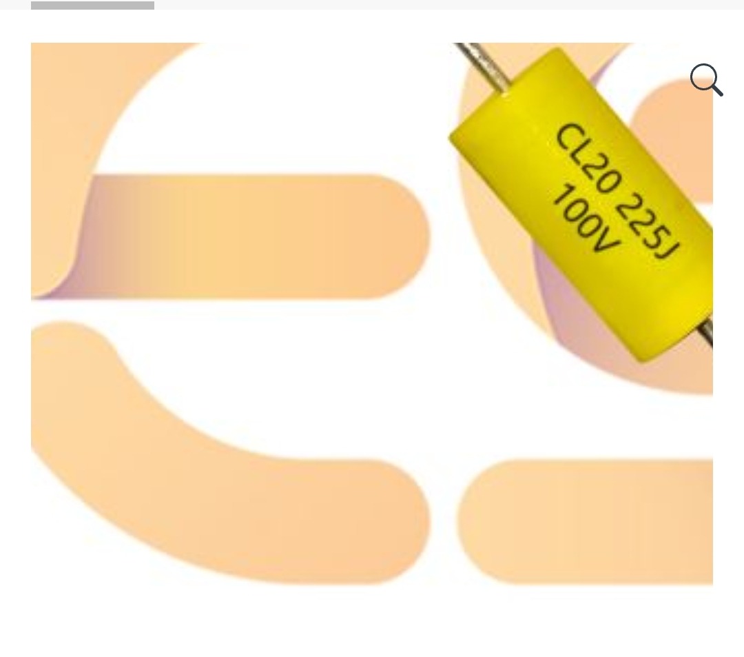

You can get high quality 2.2 uF film type capacitors for very cheap.

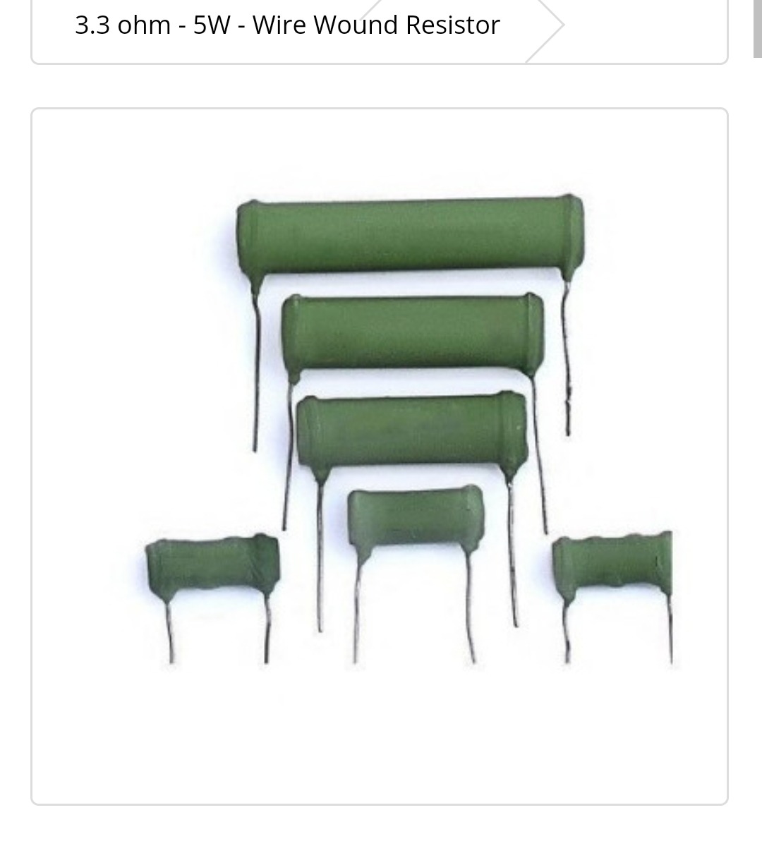

While you're at it, replace that crappy sand-cast resistor with a non-inductive type wire-wound 5Watt type, which should be about $1 each.
You'll be impressed with the improved clarity of sound.
But that resistor is not in use,they have put jumper in between of resistor legs if I want to replace that then I have to remove that jumper wire or should I just buy new and place it there as it was
The jumper wire in between both legs of new resistor?
Capasitor and resistor
Resistor if we are using it i will buy
And will it really change sound that much then why they have put a jumper wire in between just for sake of loudness?

How should I know? They're your speakers. I don't even now what speakers they are. I have no idea what they sound like.
I advise you to test it both ways, just like others have advised you to do. Then you make the decision yourself.
Then tell us what you heard. We're curious.
but as @baldrick mentioned mostly it was someone else modified I can try removing the jumper and check
That was also explained to you in your previous thread by Ralph.
"I imagine that the previous owner modified the crossover shorting the resistor. This way the tweeter sounds louder, how much depends on its impedance. Hint: the solder on the resistor appear different."
You then didn't appear to accept that such a modification may have taken place!
It appears we are going round in circles talking about a crossover that currently consists of a single capacitor.
P.S. You don't need a new resistor. The present one is non-inductive enough for speakers of the calibre you are using.

So that resistor only lowers the voice so better we keep it with jumper and just try changing capasitor
By the way that resistor is inactive or is it doing something when it has jumper
Coz I am thinking to remove it as it has no use what do you guys suggest
