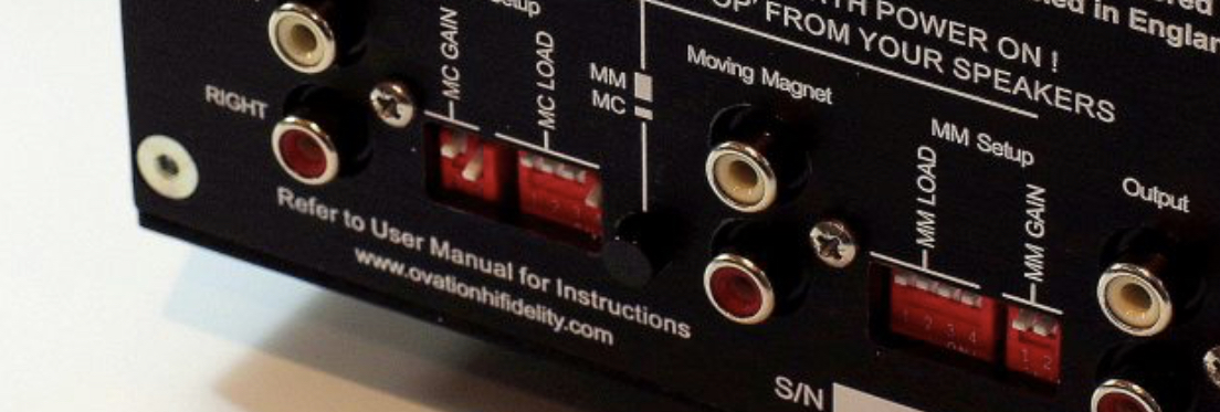

The DIP switches on my commercial pre are accessible from the rear through a slot in the housing.
If you don’t want that, best way is with a rotary switch driving relays.
Note, using dip switches still results in some pops.

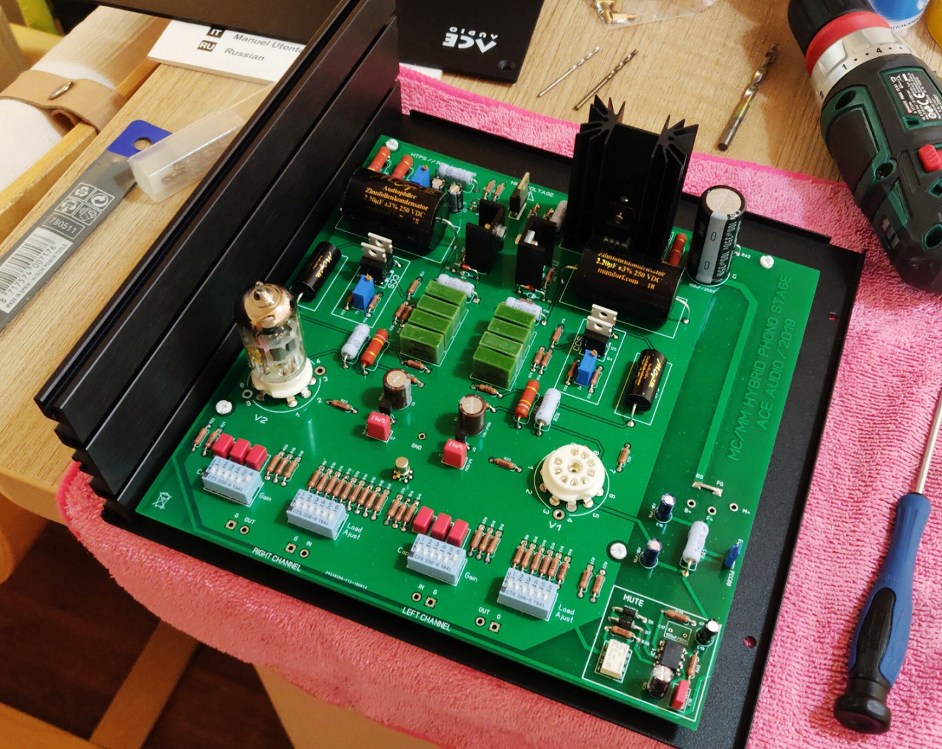

Hi Ronny, I already built the phono preamp with switches. It's a MM/MC with adjustable gain (47-50-54-60dB). It is inspired from Allen Wright hybrid JFet/Tube in cascode configuration. It works flawlessly with DIP switches and since I found the sweet spot for my cartridge, I am not adjusting anymore. I was looking for on-the-fly method so I can implement it on my future projects.

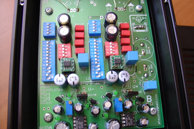

Thanks to dipswitches I got very short signal path.
I had no problems (pops etc) with switching when music was playing - one resistor has to be fixed in circuit, the rest is parallel.
Only when I change the gain I turn down volume a little in amplifier.

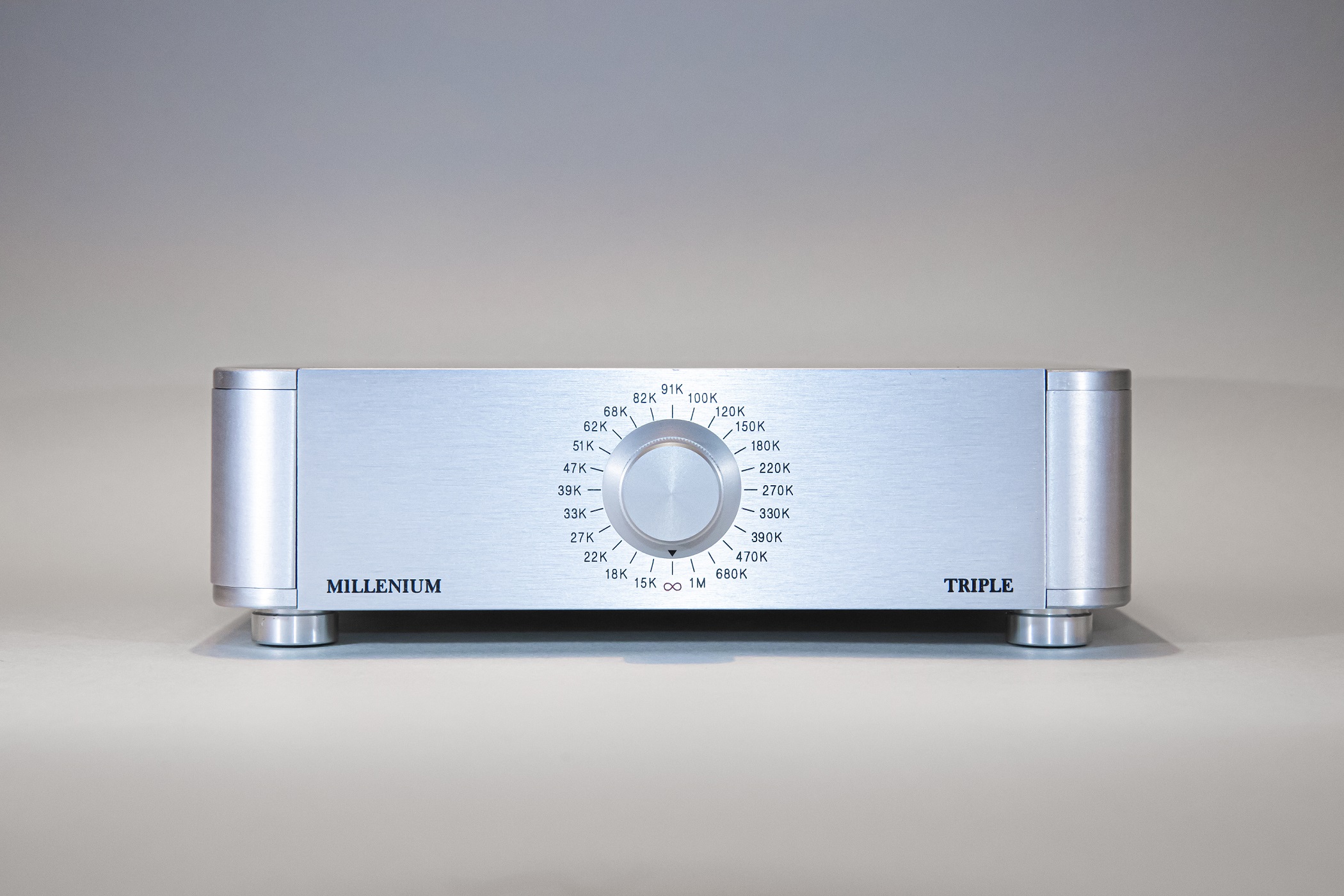

Months ago on nr. 400 of Audioreview in Italy was published an article about the coupling of MC with a step-pu trafo ( in this case a Tango 999) .
I have realized a box with an Elma 24 position switches where is possible to change the resistor put in parallel with the standard 47 kohm MM circuit.
In this way the reflected value on primary can be trimmed .

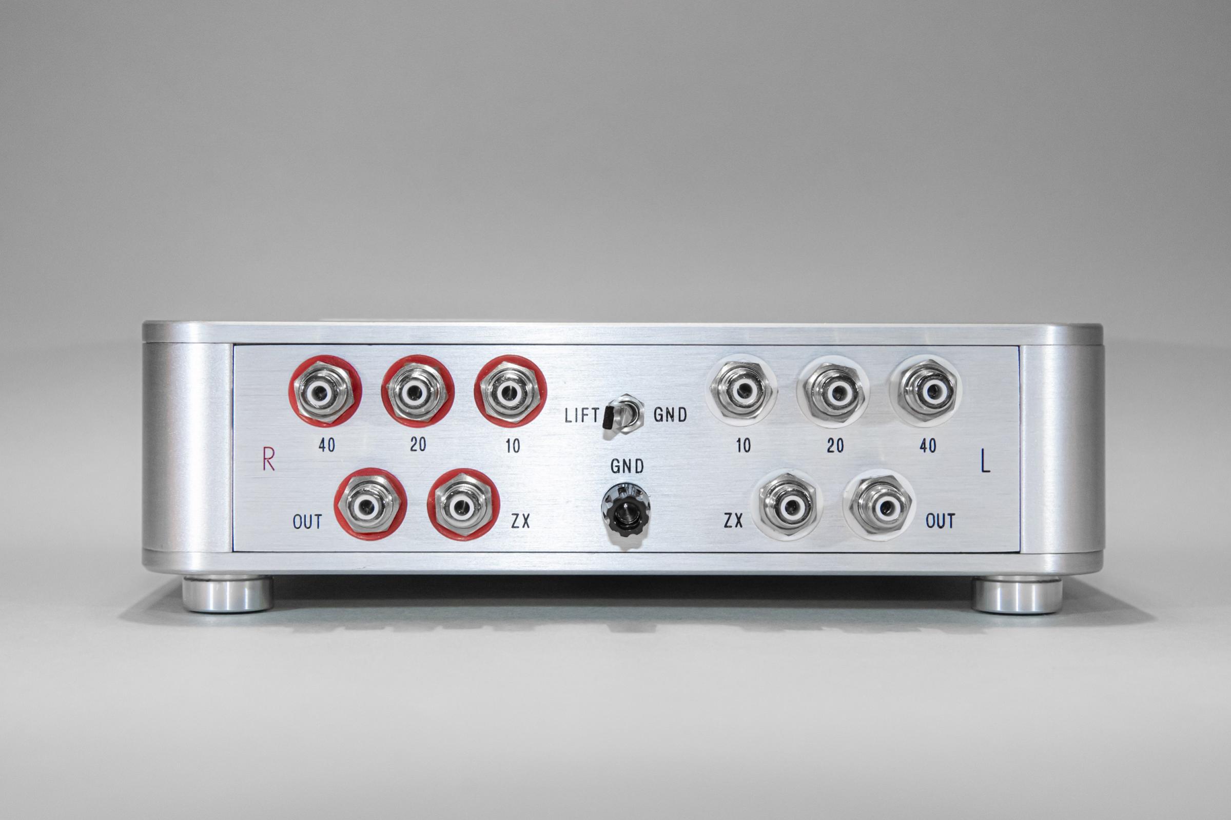

Time ago I have built a Triple step up with a trafos made for me from Sowter with three ratios:10, 20 and 40 same as venerable Tango 999.
In photo the front panel of it
I plot a lot of measurement same as 999 and the results are very interesting.
On practical use is possible to change the value on the fly without any type of noise or rumors.
And the sonic impact is very interesting.
In some phono stage , changing the input ressitor from 47kohm to 100kohm the range of reflected impedance is wider with more options.
There are two excel pages ( for 47k and 100k) with the real impedance reflected related to the value selected with the switch and the ratio on step up

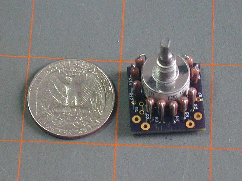

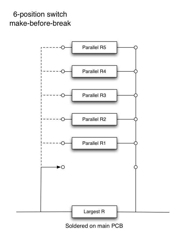

As suggested, use a make before break switch. Simple to fabricate, allows multiple values or types of load resistors. My 30 year old phono amp has a switch on a front panel that has 6 positions, one being a custom socket position. Switching on the go allows for customising your sound, for rock more highs( higher load value), acustic (lower loading value) etc. Even different sound due to type of resistor, if you believe in that effect.
I'm looking for a "easy" and simple to implement (no programming required) solution for cartridge loading/gain change on-the-fly without having the pop sound from dip-switch or relay switching. Loading and gain adjustment will be a matter of paralleling resistors. A schematic will help a lot.

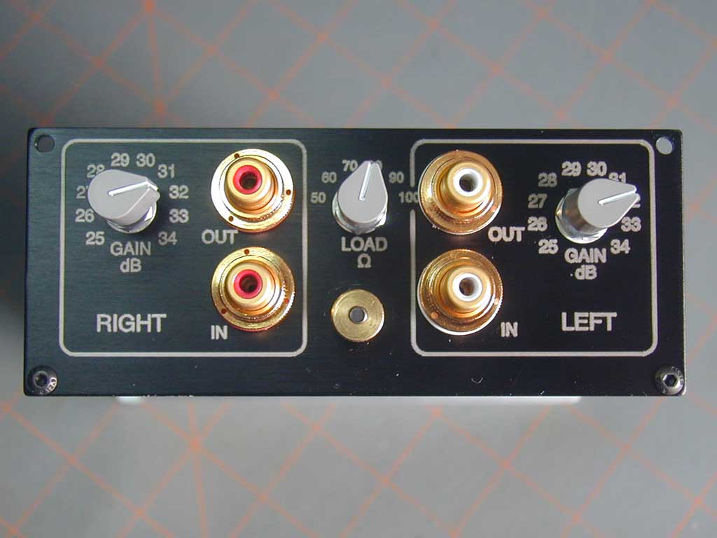

I concur with what others have recommended. Presuming your load and gain are determined by a single resistor:
  1. use a make-before-break switch.
  2. have the highest value resistor on the main PCB
Then wire the switch across that resistor, like this:
I recently built an LOMC head amp with both load & gain switches using that arrangement. I can switch both while music is playing without any clicks, pops, or transients of any sort. This may however, depend on the overall circuit topology.
Close up of the load switch:
And the finished back panel:

Nice project. What brand is the switch? Does is have gold plated contacts? Where to get one? Thanks.
