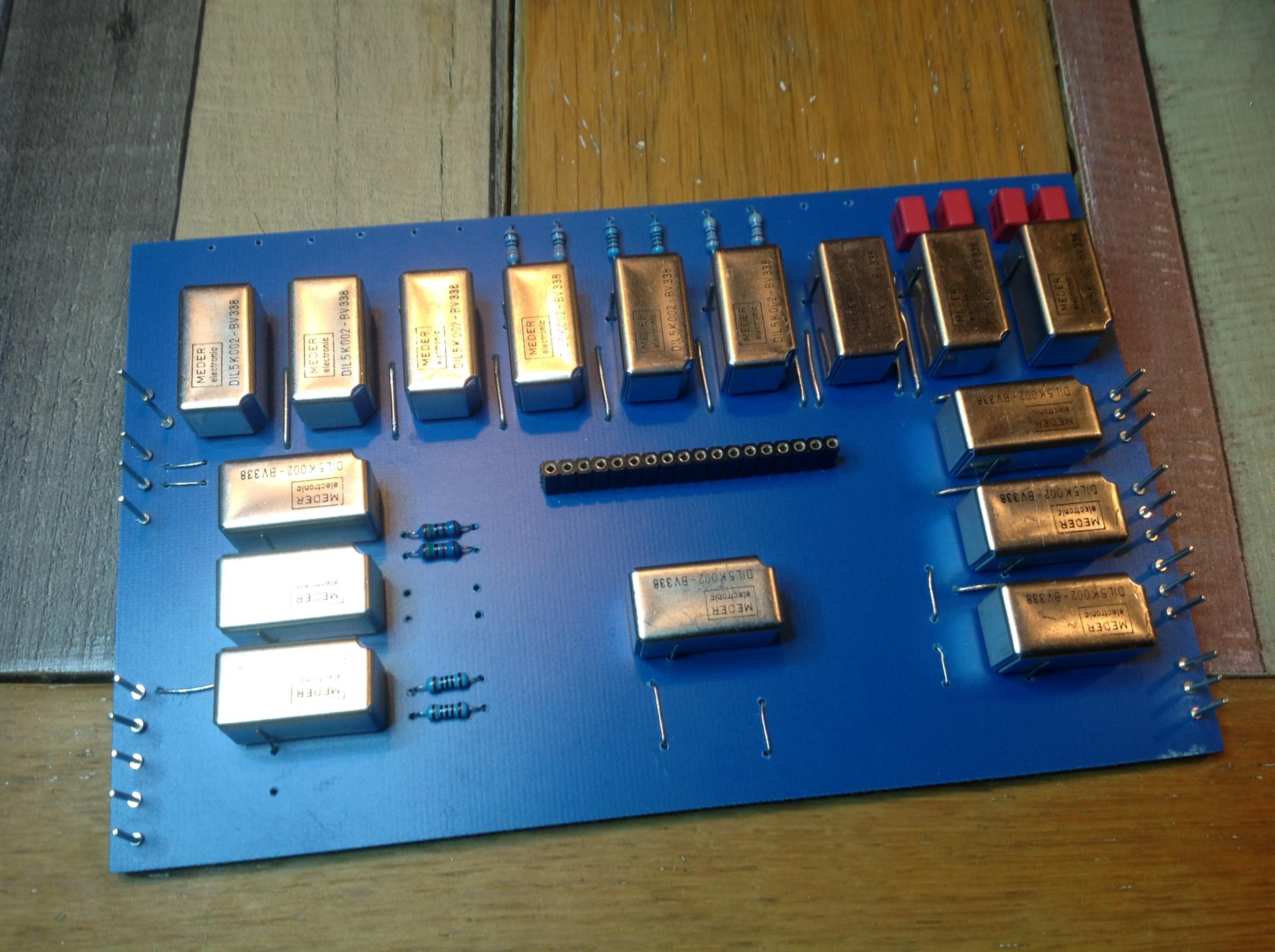

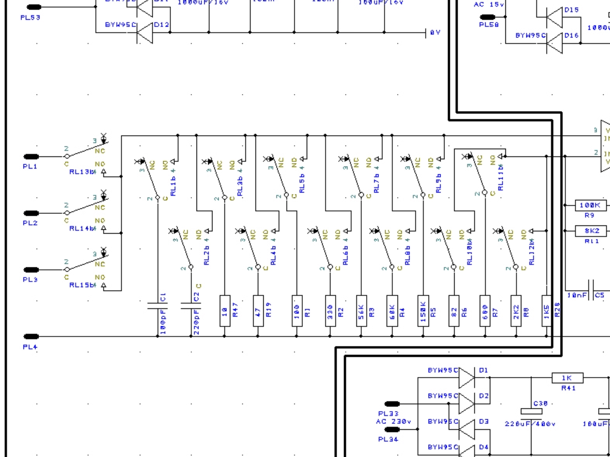

If you are switching load resistors on an MC input you will need to worry about the back emf rise time from the relays. Best way to fix this is to put a snubber from the switching transistor to ground to slow the rise time. When switching the relay on, slow the rise time through an RC network to the transistor base. Make sure there is a minimum load permanently across the input eg 470 ohms.
For capacitive load switching on MM type inputs, connect the capacitor to the input and the other end through a 10k resistor to ground. Then connect the relay contacts across the resistor- select the capacitor by shorting the resistor out. The same rise time/ fall time precautions mentioned above also apply.
Importantly, in both cases make sure the loop area of the connection from the switching transistor to the relay and back again is as small as possible. This is critically important in order to minimize radiated noise from the fast switching edges (even after you’ve taken steps to slow them down). One approach is to mount the switching transistors right next to the relay coils - same with snubbers as well.

If you need to switch a cap or resistor you must have always connected one, p.e. 47 kohm, then with a switch or relays you can switch the others (in parallel ) on the fly.
You need to calculate exactly the values that will be connected in parallel for each position.
Same for cap, in this case the value increase.

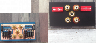

Can't help you with gain adjustment but if you want to play with cart loading:
* simply buy a pair of RCA 'T' connectors,
* insert them into your phono stage RCA input sockets
* then put each phono cable into one of the T inputs
* and a 'loaded' plug into the other input.
The resistors in these loaded plugs act in parallel with the default 47K and produce, basically, a load equal to what the res value is.
Then when you've found the load value you like, for a little increase in SQ (by removing a connection), you can remove the 'T' connectors, and:
1. add a pair of RCA input sockets, in parallel with the original ones, for the load resistors or
2. change the default 47K res to your chosen value.

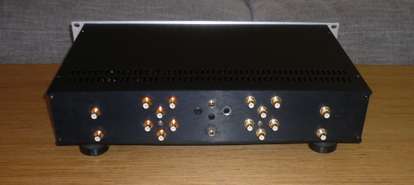

The way I provide variable loading for my 'Muse' phono stage is use parallel pairs of input RCA sockets, into which 'R-loaded' or 'C-loaded' plugs can be inserted. These then act in parallel with the default 47K & 100pF on the circuit board.
See pic of a dual MC/MM phono stage I made for someone recently.

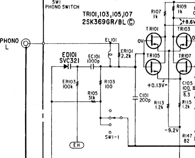

As per Billshurv proposal, replace R105 with variable resistor.
The trouble with a variable resistor is ... you can't be sure (without going to the extent of measuring, after you change the load) that both channels have exactly the same value of resistance.

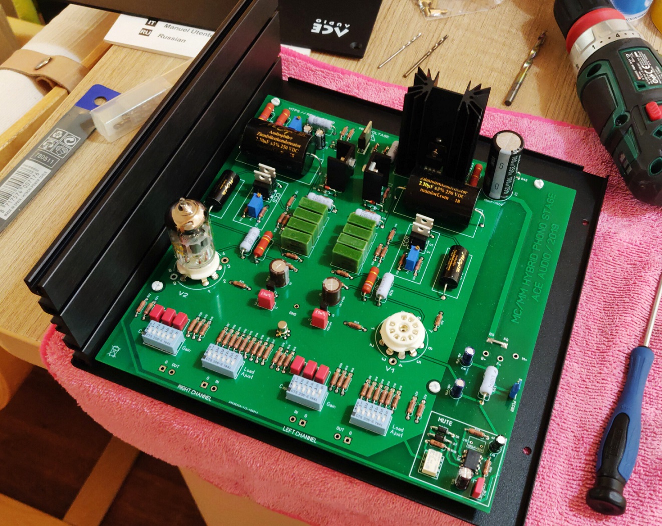

Hi Ronny, I already built the phono preamp with switches. It's a MM/MC with adjustable gain (47-50-54-60dB). It is inspired from Allen Wright hybrid JFet/Tube in cascode configuration. It works flawlessly with DIP switches and since I found the sweet spot for my cartridge, I am not adjusting anymore. I was looking for on-the-fly method so I can implement it on my future projects.

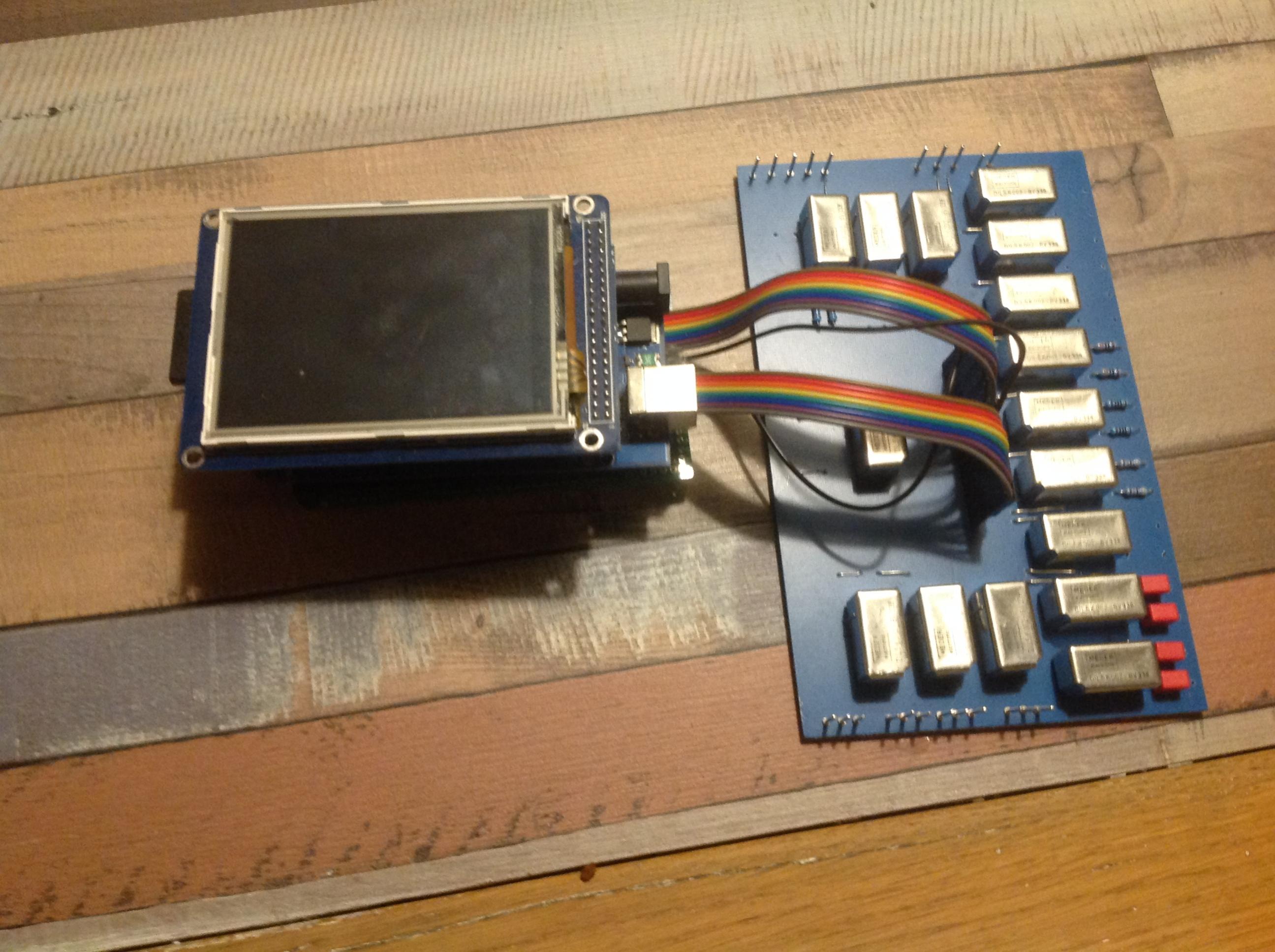

That remote control with display looks interesting. Is it arduino?
