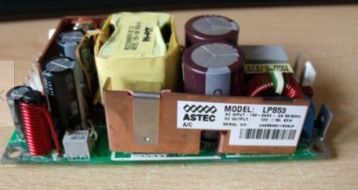

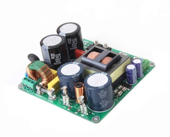

Can one of you bright boffins help me? I have completely the opposite problem. I’ve moved from the US to Australia. I’d like convert my Bose Acoustimass 6 series iii subwoofer from 120vac to 220-240vac. I’ve tried to locate the 220-240vac transformer to carry out a straight swap out, but have been unsuccessful. Any help gratefully received?
Administrator
Joined 2007
If you can not physically locate a mains transformer in the unit (it will be big and heavy) then this model may use what is called an SMPS or switching type supply. These are small and electronic in nature, not a single big transformer.
An SMPS would look more like this.
These often but not always are designed to work over the global range of mains voltages in use. If it has one of these then you must check first that it is suitable.
The option with the least headaches is to buy a stepdown transformer from Tortech. Ebay things are generally switchmode and unreliable, not to mention more expensive for the same power handling.
Just get one that has enough sockets for all your hifi gadgets and total power handling exceeds the sum of the units by about 25% and you'll be fine.
