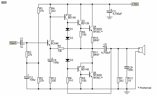

The circuit Vzaichenko has given us is very interesting and I'm temped to build it myself (with different outputs). I also agree that it would be good to start with something simple that can be knocked together in a couple hours.
I've actually built that Rod Elliott P12 design and I can tell you it sounds rather good for such a simple circuit. Its also a great platform for experimentation.... better VAS, better outputs, Baxandall diode on the lower half, better bias generator, etc, etc.
The only caveat is that from memory I had to add a small cap across Q2 base-collector for stability. About 12pF should do it for the other values as specified.

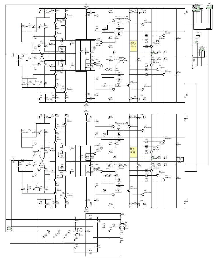

The FH9 I offered is tested and proven to be an easy build (couple of hours) as there are only 7 active parts not including the OPS. I have the vzaichenko VHex+, and indeed it sounds great, but level of complexity is above the FH9 circuit shown here:
550019d1463581537-100w-ultimate-fidelity-amplifier-fx8-xrk971-hexfet-vbe-schematic-v2.png
I replaced the MPSA42 with a BD140 or KSC3503 (depending on voltage used).
Again, just because you have a handful of TIP31's doesn't mean that you should use them. You could easily have a handful of IRFP240's and 9240's for under $1ea.
The FH9 works well at 35v to 53v rails - use KSA/KSC drivers and you are covered. Also this simple little amp had been clocked at a bonafide 120w for 15min sine wave drive.
