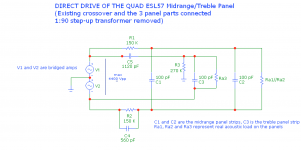

The original challenge in the thread was to look at options for a direct drive of the midrange/treble in a QUAD ESL 57, which makes the voltage, current and capacitance numbers discussed above a bit less evil.
Member bazukaz has done a great LTSpice sim of the of the ESL57 internals.
see schematics below how a bridged amp could be connected (using his diagrams as a basis). As his simulation shows, there is xformer winding inductance, parasitic capacitance in the xformer windings that interact with the shown stock crossover components,
so with direct drive these components must for sure be changed (or even removed).
Mats do you also have typical values for those Ra resistors? I'd be interested in that simulated load for my own developments.
Will send you mail, Jan :)
Will keep everyone in suspense (including myself), but i did find a promising ESL direct drive design -- a class A circlotron using cascaded MOSFETs -- IXYS IXTH1N250 (Vdss max = 2.5 kV).
Output is +- 1kV peak (so about 6 db below maximum possible output from the ESL57s, but a good starting point to do A/B comparisons vs the transformer solution. Seems to be able to drive 1 nF with good slew rate so the ESL57 treble panel (300 pF) shouldn't pose a problem.
Will report back when prototype is up and running (measured FR, phase and distorsion characteristics using a B&K 4133 mic + subjective listening).
Unfortunately the lead delivery time of the output transistors seems to be >10 weeks (Mouser) :( and they are expensive -- USD 30 each, need 4/channel).
