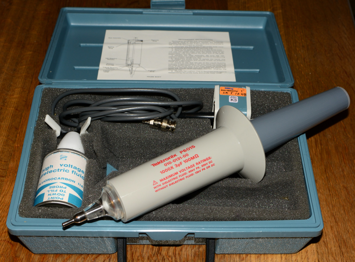

Everything gets complicated with voltages that high. Just to measure high voltages using a standard DMM? ….transformer, diodes, capacitors for the PSU, wire insulation that are 3k rated are the easy parts. High voltage probes for the oscilloscope…..like the one I have in the picture. It will be good to have some experience from the "tube-world" working with around 5-600 VDC before going for 3 kV. One mistake and there will be an awful smell of burnt meat
