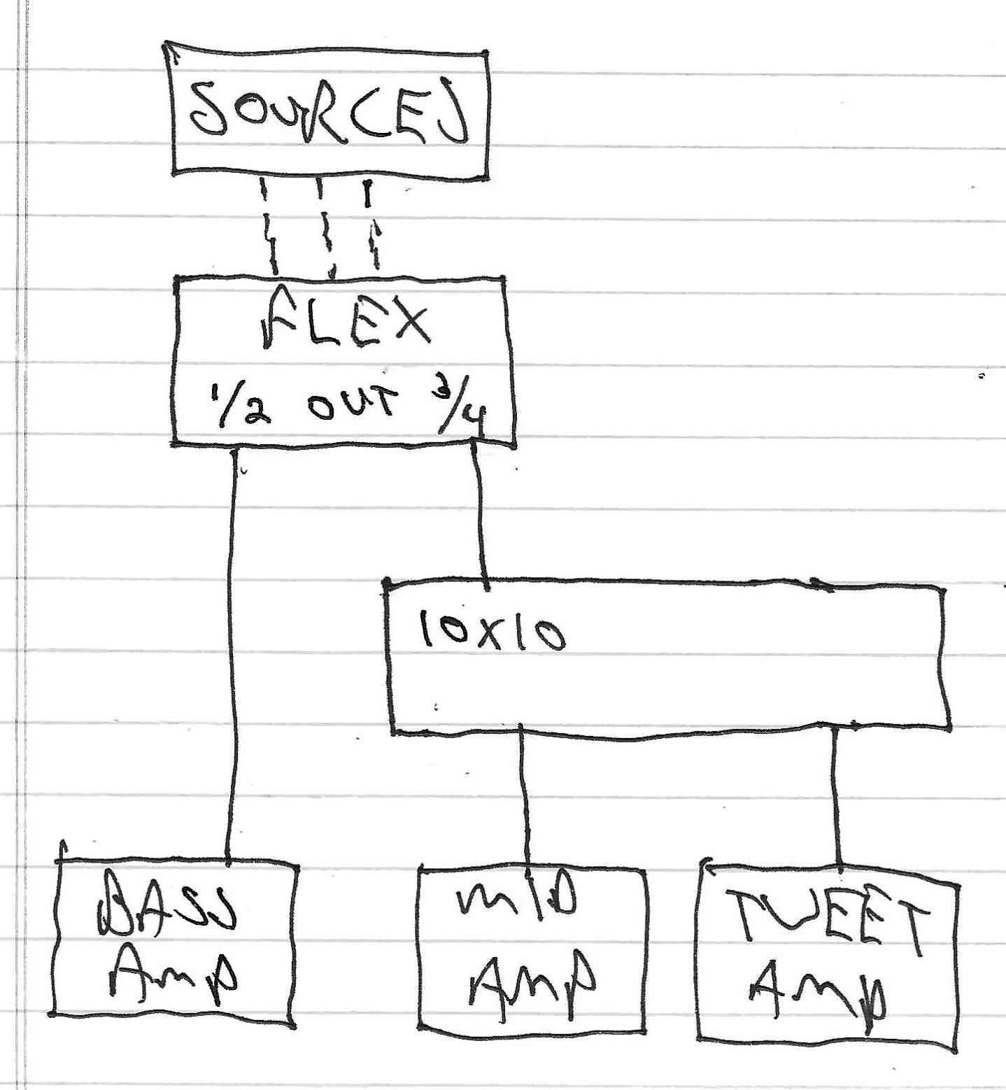

I have a little bit of decision paralysis at the moment due to not finding a product that does exactly what I want.
The MiniDSP Flex seems like a nice little unit (if not a bit overpriced) but only accomodates for a stereo pair of two-way active crossover speakers. I am hoping to be able to scrape together a third pair of channels and I wondered if any of my proposed configs would come with any negative impact. I already have a MiniDSP 10x10 with a stereo/2 channel SPDIF output so it got me thinking.
1. If I run a SPDIF signal into the 10x10 SPDIF in and use one pair of its DACs/filters for the woofer I could then route/daisy chain the SPDIF straight out untouched to the SPDIF in on the MiniDSP Flex and use the stereo pairs for mid/tweeter. My reasoning is that it's a bit more important to have the mid and high with lower noise and distortion and the 10x10 is a bit long in the tooth now.
2. Split the SPDIF source and run parallel DSPs.

Looks like if you split the spdif you will have the same signal in both ends. I am not familiar with the MiniDSP 10 to know if the spdif output is processed or a bypass, but option two makes more sense for me. both outputs from the optical led should be bit perfect copies and synched in time. The reasons to chose 1 would be to avoid more hardware ( the optical "splitter").
The SPDIF (or optical) signal would go through the 10x10 processing routing matrix and now I think about it any room correction would have to be done at this stage before it reached the flex so that it applies to all drivers.
So, I suppose option 1. is the only viable solution in terms of putting together a three-way with the two units that will have a global EQ.
If you want to do Dirac room correction in the Flex, put the stereo signal into the Flex first with two ouput: low and (mid+high) and do the xover between mid and high in the 10x10. Then running the Dirac in the Flex (which is what I think you intend) it takes care of the whole bandwidth.

Thanks Jan, yes, the 10x10 has SPDIF in and out so I can have the low coming out of the 10x10 DAC and the mid and high coming from the Flex DACs. I'm not going to pay for the dirac option as I am quite happy with my own corrections and am a little sceptical of the expense.
I am wondering if having has the signal processed through two DSPs (although not going in to analogue domain) will the signal be effected negatively?

all processing has an increase of noise in the signal plus the possibility of jitter errors, bit flips and all other types of artifacts that may happen, plus the delay in the processing of the signal from one unit to the other, but in all practicality, the effect would more than likely would be mininal to null. If you think about it, most of the recorded music goes through a combination of plugins and processing equipment.

You've not clearly stated your goal here. You're trying to make a 3 way crossover, correct?
I strongly agree with Jan (above). Set the Flex up as your "preamp" - if only for the remote control! See my DadCad drawing; attached.
And dude, I say this with love, but you are dead wrong about Dirac. Spend the extra for that and it will change your audio life. And suddenly you will see the Flex as quite a bargain. Good luck with your project.

Thanks, just to clarify, I am trying to avoid using the 10x10 for the mid/tweet application. It's noisy and is not sporting up to date hardware.
As I mentioned, my reasoning is the Flex would be a better shout for mid/tweeter applications where our hearing range is more sensitive and the 10x10 can handle the woofer (circa 500hz and down).
